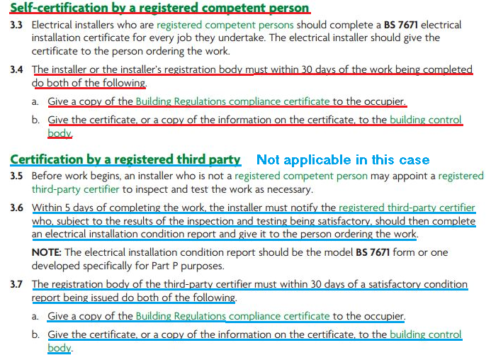

That's not what it says:
Presumably the thirty days is 25 for the installer and 5 for the scheme.
