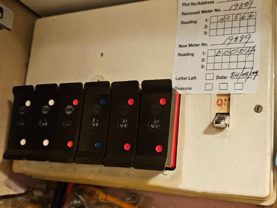

The electrics in my 3-bed mid-terrace house are pretty old, with an old Wylex fusebox. I would like to get an induction cooker (30-45A), and there's currently no cooker circuit (and no space in the fusebox).
I had an electrician round who suggested if I didn't want to upgrade the fusebox right now (would be disruptive with 4 inhabitants, and there has been some dodgy DIY wiring over the years - so there's a risk of having to rewire parts of it), we could get a separate mini fusebox for the new cooker. I'm tempted by this option as it's significantly cheaper, and the rest of the house electrics is ok (just want the cooker) - would rather save the rewire for when we would be doing something major so needing to be away for a while. Is this a good plan?
The quote was £600 which feels steep (I was guessing 0.5-1 days labour at £200-400 + maybe £100 in parts) - I'll try and get some more but does this seem reasonable (how long do you reckon it would take)? Fusebox is by the front door, and the oven/kitchen are in the opposite corner of the house

A photo of your existing 'fusebox', might be usefull.

Are you sure you do not already have a "cooker" circuit?
Yep - the same gas cooker has been there for 30+ years, with piezo spark

Can you provide some clues, on what each of those fuses supply?
If the price of £600 includes VAT ,it's not overly expensive for London. I would be inclined to upgrade the fuse board for a new consumer unit ,you have no RCD protection on any of your circuits ,an upgrade is well overdue, particularly if there are existing faults on the installation that need attention.
Have you ever had an EICR done ,(an inspection/ report basically) ?
Has the fusebox got a cover? The circuits are usually described on the inside of that.
