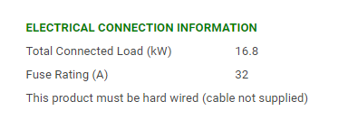

Just had a look at a Rangemaster induction. Max load - I assume that is a christmas day thing - is 16KW. That makes my 32A circuit wanting.....
I guess that settles that then :(

I don't think induction - or electric only - is doable. If the circuit is limited to 32A (I have not checked the cable size so not sure) then I am rather limited.
Even the dual-fuel option was coming in at 8.5KW which is too high.
I've seen a couple that advise a 32 amp fuse
This for examples requests a 32 amp fuse despite being a 16kw cooker
https://markselectrical.co.uk/44444...KSwbyDR9AytEc1FwNRhoC4KUQAvD_BwE&gclsrc=aw.ds
So this is interesting -
That one you put as an example. It's rated at all-on 16.8KW (73A) but only a 32A fuse. Are they then expecting it to be a "mixed duty cycle" on the hobs and oven to stay under 32 for the most part.
I don't think every item will be on from the very start.
The heating elements once upto temp reduce there power usage to keep a steady temp. Even when cooking Xmas lunch all the various bits and pieces have differing cooking times and this ovens and Hobs all being switched on at different times.
I don't think I've ever seen an oven on an 80amp or 100amp breaker.
Most houses only have a 100amp incoming feed.
