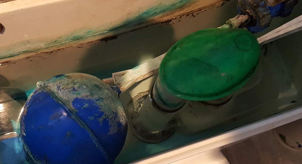

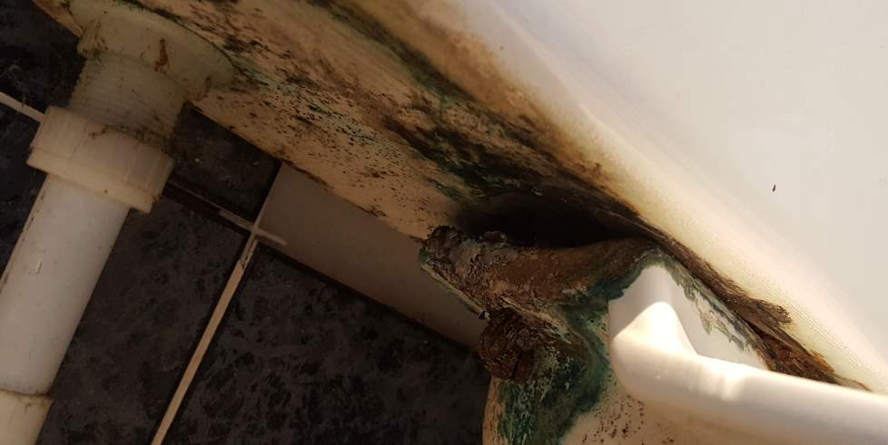

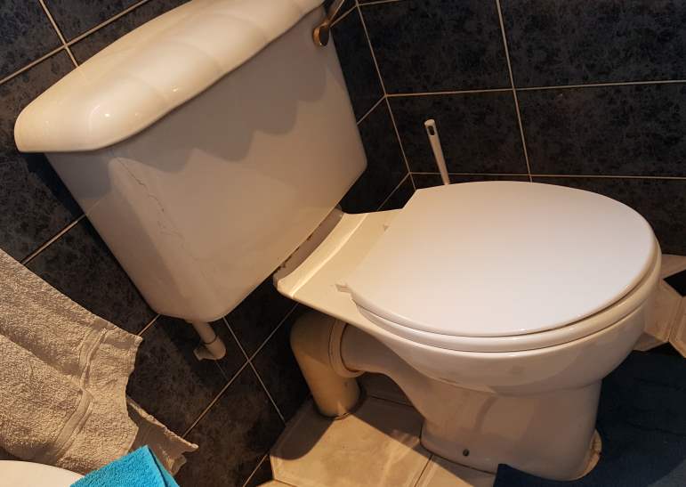

The toilet here has probably been in situ since 1994, when the house was built, and is seeping water out from the join between the cistern and bowl (close-coupled, as you can see). So I’d like to replace the doughnut.
However, in my very early days on this forum, years ago, I tried to do this with the toilets in my modern Shedrow house back in England, and found they used a non-standard (I think Ideal Standard or something) doughnut, so it all turned into a bit of a nightmare.
Any way I can tell before removing the cistern if it’s likely to be a standard kind? Can you tell anything from the pics?
Thanks as always :D
PS I know, I know, new toilet time... but the floor has been tiled round this one, meaning I'd need a new floor too... sigh...
Most likely the standard round donut however until you remove the cistern you won`t know if it is just the donut or you need the fixing kit as well. Start it early in the day to give yourself time to get the bits is the best advice.
Along with the close coupling kit I would suggest fitting a Fluidmaster fill unit and a Flapper valve and chuck out all the old gubbins, Cheap enough for peace of mind
Agree, might as well do it whilst the cistern is off.
Oh - just a thought - is it possible to fit a random new cistern easily?
I mean, do the holes tend to line up, or... not...
The problem is getting a replacement cistern that will line up with the pan holes and butt up against your tiled wall,sizes vary so much these days :!:
Most of that carp will scrape of with a piece of plastic or wood with a sharp edge and Kil-Rock in a spray bottle.
some of the non-standard fittings have four screws, the usual ones have two.
I keep a few stainless coach bolts, washers and wingnuts for cisterns, because I've been enraged in the past at having to saw through rusted old parts. Is it M8? You can buy small numbers on fleabay at a modest price.
p.s.
if you buy a new cistern, it needs to be larger water capacity than a typical modern one. You can still get them, but have to hunt around. The capacity might be marked on the inside of your cistern, in litres or gallons, if not, fill it up with a litre jug and count them. The Flapper valve gives a very forceful flush, which I favour.
