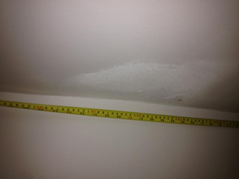

Hi all. I was hoping some of the experts here might be able to help me out with a damp problem...
Situation: early 1900s house, solid brick walls with no cavity. The outside wall has a wide step up to the patio doors approx 10cm high, and is rendered down to ground level with a cement mix. Inside there was significant damp up to about 70cm above floor level with lots of crumbling plaster. Called in a chemical DPC contractor about six months ago who stripped the wall back to brick up to about 1m high, injected a new chemical DPC, lined the wall with a plastic damproofing membrane then plasterboarded and skimmed. The problem I have now is that having redecorated the room there are now large patches of paint flaking off the wall in a couple of places at a height of about 1m, above the height of the membrane, although no evidence of salts on the surface of the wall. The flaking started about 3 months ago, within a couple of weeks of the painting!
My question is, is this just the wall drying out or is the DPC failing to do it's job? The room was previously painted with kitchen paint, which formed a film over the wall. When they stripped the wall back they tore the paint film up the wall in the places the damp is showing through now, basically it appears the problem spots are where the film has gone but there is no membrane inside the wall. Should I be patient, wait for the wall to dry then repaint the damaged parts, or should I try to paint over the damage with a damp-proof paint (I suspect this may just move the problem elsewhere), or do I need to get the DPC contractor back in and accept he's going to trash the whole wall and I'll have to redecorate again?

Ok so I can assume the DPC man isn't going to be returning my calls anytime soon, which is what I'd expected. Any suggestions on how to tackle the root cause of the damp and at least tidy up the interior? There are some photos of the exterior and interior here:
View media item 57504
Obviously the tape measure is supposed to be vertical in the last picture!
Is there any merit in raising the external render level in case it's bridging the DPC? Does the render need some kind of bead on the bottom of it in that case?

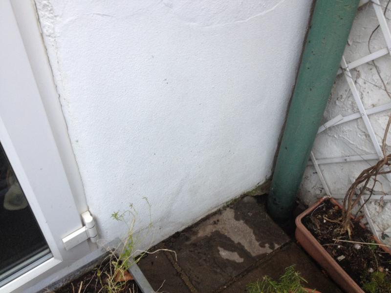

Thanks for all the replies so far. I've done some more research and digging and I suspect that at least some of the problem stems from the patio the previous owners laid outside. I'd be grateful for your thoughts on whether I'm on the right track here. Unfortunately the site won't let me upload pictures at the moment so I've linked the pics to a web album.
Pic 1 is the back of the house.
Pic 1
As you can see, the patio step is laid quite high up beneath the doors. The green iron pipe you can see on the right is the soil pipe from the bathroom and also the vent stack. I reckon the top of the step is about 2" max below the top of the internal floor. When I pour water onto the step it flows away from the house on the left half but on the right it flows down to the right and into the gulley in front of the green pipe. On the left of the picture you can see the wall is rendered right down to ground level, and almost as far on the right behind the green pipe.
Pic 2 is more detail of the soil pipe and the gulley.
Pic 2
The base of the green pipe has a sloped concrete surround with runs away from the house. I've dug the soil and gravel out of here and the gulley has a concrete base which runs to the out from the wall as far as the end of the step. Beyond this it seems to be just soil. I dug about a 6" diameter and depth hole at the end of the base and poured a watering can full of water down the green pipe to see where it went.It flowed down the gullet and into the hole but was very slow to drain from the hole. The house is on London clay. The following pic gives you a better view:

So, (and thanks for being patient and getting this far!), here are some thoughts I had on what I've seen and I'd appreciate your views on whether they are sensible or just plain daft.
1) Injecting another chemical DOC is a waste of time and money and won't solve the problem.
2) The step on the patio is too close up against the wall and the drainage on top may not be adequate.
3) The rendering down to ground level is a bad idea and should be fixed. As a start I thought it should be hacked off to at least the top of the red band and finished with a bell cast. Any merit in going a couple of brick courses higher than that to allow some breathability lower down the walls? Presumably those bricks would need repointing.
4) I possibly need to either remove the patio step entirely from the wall, or dig up the 6 inches touching the wall and install a linear channel drain.
5) I need to drain the channel to a proper drain as soaking away probably isn't an option.
6) Given Q5 above, do I need to get a deep channel dug from the patio step, around the corner and into the guttering drain (it would need to be deepish to get any fall), or is there a means of tapping it into the green soil pipe?
7) It's possible the green pip may be leaking somewhere. It might be worth getting this either replaced or relined in situ.
Finally, who on earth to I approach to do this work for me? Presumably a plasterer for the rendering corrections, but what about the drainage? Is that a patio layer, or a builder, and can they tap into the existing drainage/soil pipe system or is that yet another trade?
Anyway thanks very much for reading!.

7. DPC injection from one side, unless double-drilled, is useless.
8. The red and black cables are not the DPC. In best practice, the DPC is located under the joist tails ie. under the air brick/vent.
It will pay you to locate the DPC.
Possibly, the red S&C plinth is bridging the DPC.
The steps are probably too close to the elevation.
9. Given, that the render is failing, and might be painted in an oil or plastic paint, then penetrating moisture could be at work. It's also possible that the interior damage was and is, in fact, condensation against a cold wall. Careful inspection of the render required.
At the least, the render has to be cut back from all ground contact and all bridging of the DPC.
10. Have you crawled under the floor?
11. Only one (3") air brick is visible.
12. Where are the Soil pipe and the side gulley draining to?
13. As above, the weird sump arrangement requires investigation.
As does the S&VP - is it leaking below ground, and is it perishing in the stack? Feel behind it.
14. Any experienced general building contractor would be competent to do the work.
