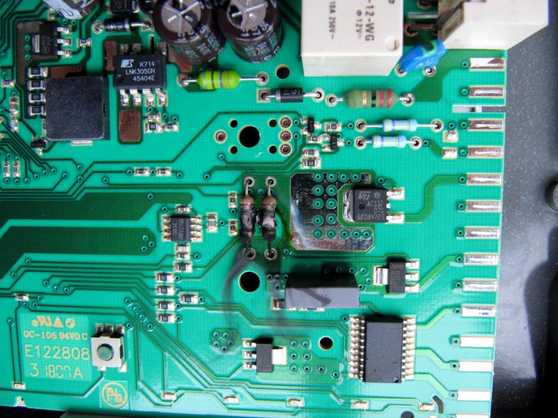

Anyway I took the front panel off and no matter how many clips I fiddled with I could not get the PCB out to inspect it. I did find the supply to the heater though. I unplugged the supply and there was no sign of damage and no smell of anything burnt. I've not idea how to test the voltage at the PCB end as I would struggle to get the probes in and I'm no electrician - also, as soon as I turn the machine on it kicks into life an starts spraying water inside.
Why are the lights not working? Surely it should at least be telling me which program it's running!
I hate to admit it but I'm close to admitting defeat and getting someone in!
I think the short has popped your pcb. An inspection may reveal damage (probably a blown triac). You need to get it out if you want to check it. Remove the console, the module is clipped in place. If you hit difficulties send me a private message with a valid email & I'll try to send you an exploded diagram. If you post contact details here the moderators will remove it pretty quick (rule 4). You might want to look here http://cgi.ebay.co.uk/Whirlpool-CDA-Ignis-Prima-Control-Board-Module-RRP-167-/330544633381 I don't know if it is still available. Normal retail price for this module is £100 & it needs programming with a Whirlpool PDA first.
Zipper, you truely know your stuff. Thanks to your encouragement I went back and got the thing out. You were bang on, the PCB is totally blown. See Pic :
