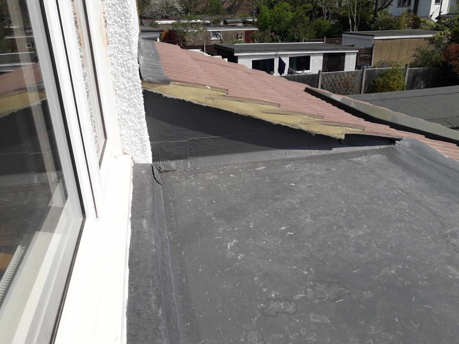

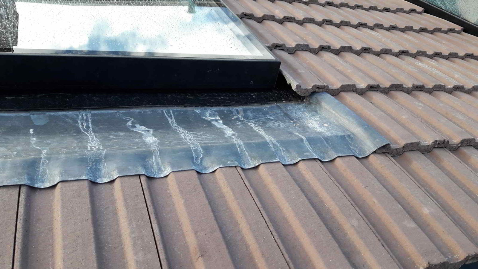

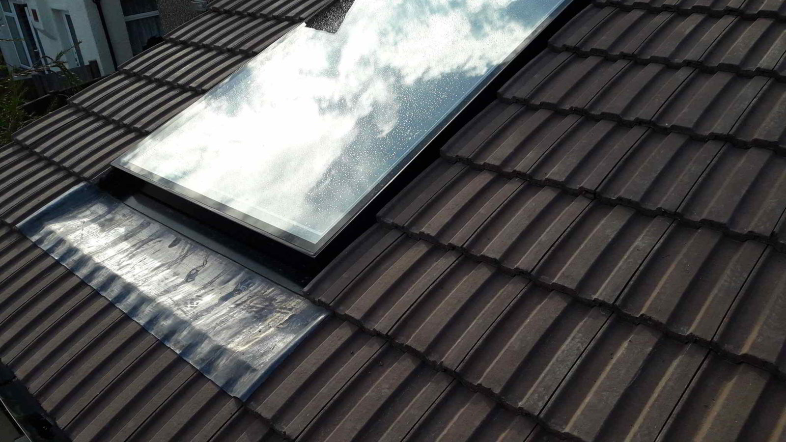

The roof has approximately 18 degree pitch, interlocked tiles and a flat GRP section just below the 1st floor window. There is also waterproof membrane under the tiles. The roof has two large portrait skylights that have so far presented no issues or leaks around them. Pics attached below for reference.

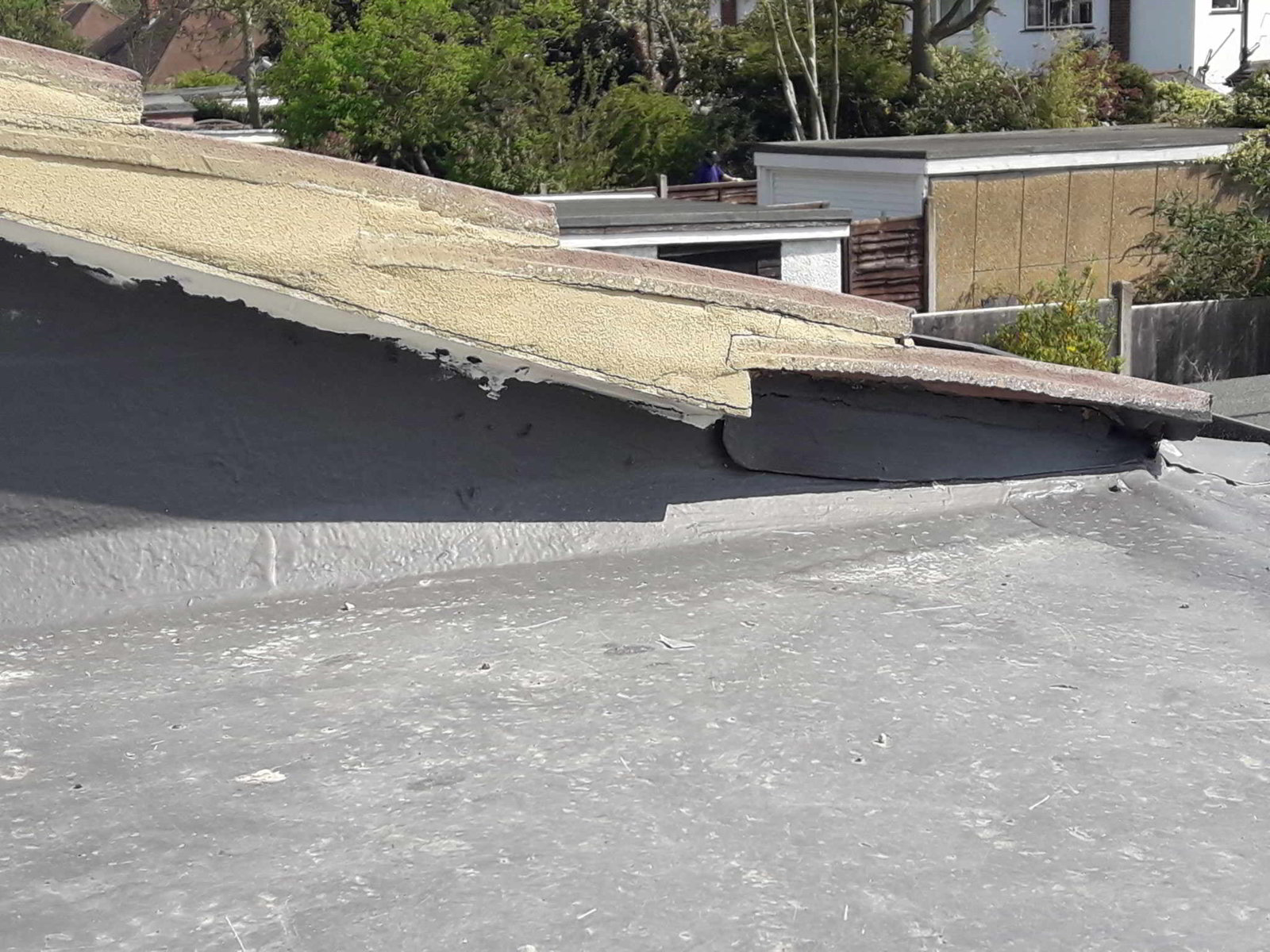

roof pitch to low for those tiles strictly speaking.
tiled verge is not ideal and should have been formed with a flashing over the grp upstand and not relying on mastic
undercloak stops way short which will not help
shouldn't take them more than a couple of hours to adjust
When you say the undercloak stops short, I presume you mean the cement boards should extend all the way down to the last tile of the verge?
So this could be rectified based on the existing work and not necessarily redone from scratch?

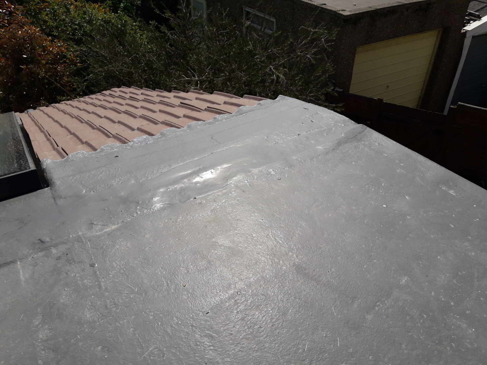

I included a range of recent pics from mobile, link with plenty shared so at least an experienced eye can spot any issues.

He said he was going out on a limb and sealed the interlocking line of tiles next to the offending area to test if water leaked in from the interlock (included in my photos link). I found this awkward tbh but someone could comment here. That was a month ago and of course didn't work, as we found out with next rainfall.
I don't think the pitch roof has an issue, leaks would have occurred in other places which has never occured. Another thing is the membrane underneath the pitch at that point as simply not working. For if water comes in pooling at plasterboard below at the corner, it means membrane has either a gap somewhere or failing. I still observe porous areas like holes at the side top/bottom next to last tile and grp upstand, although it's supposed to be all sealed!

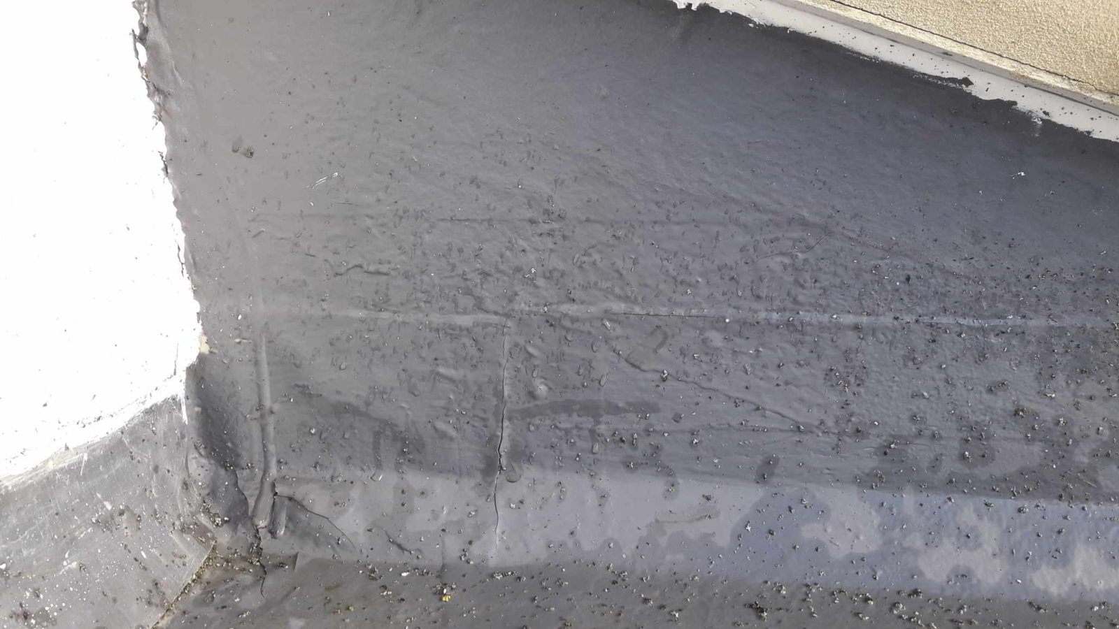

Your final pic is a bit interesting- it looks as if they've matted the upstand trim to the wall. Which is always going to fail- the roof should be free to expand/contract, you'd usually use a cover flashing over the upstand of the trim.
Question is now whether there's any clearance between OSB and walls on the rest of the deck and how they've finished the other trims
and the verge is cracked to buggery.. this could be tested by cloaking in some plastic temporarily full length
