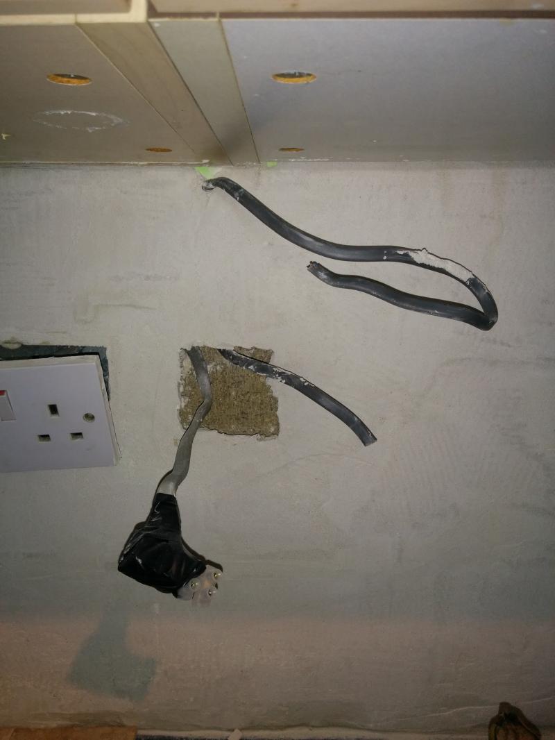

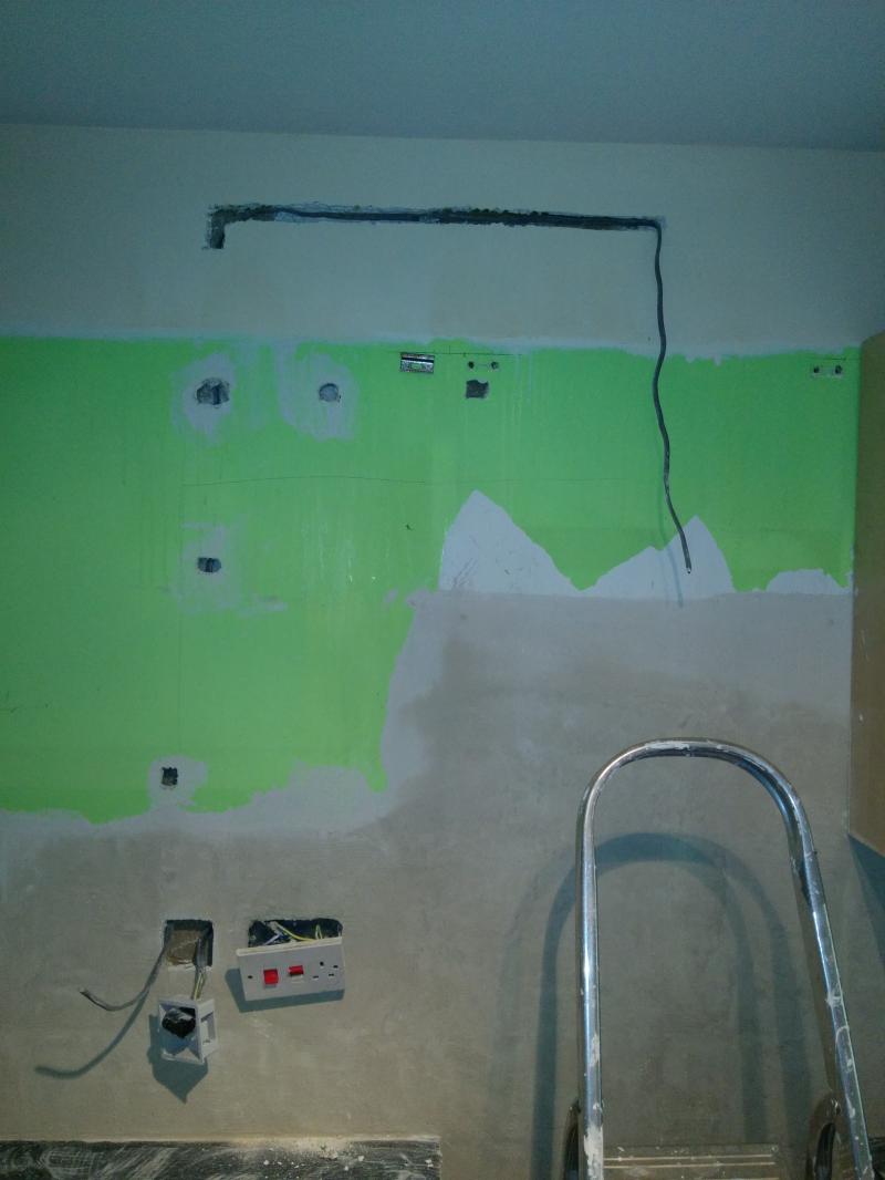

Attached are two images, one showing the safe zone chase for the cooker hood , and the other the opening where the 13a FCU will be spurred along with the lighting cable (fished up to the cabinet)

I don't think I'll risk the self signing! ... I'll take your advice and leave the chase open for inspection
Fair enough - but, even if they can 'inspect and test', you may well still find that some electricians are uninclined to sign a declaration that they 'designed and constructed' the wiring when they didn't!
Attached are two images, one showing the safe zone chase for the cooker hood ...
Do I take it that the horizontal chase at the top is within 150mm of the ceiling? (it looks pretty marginal!). What is going to happen to the vertical run of cable down to the hood, and what is going to be on the end of it?
Kind Regards, John
It is within, 110mm to be precise. I have a feeling you're going to tell me to move it higher!
At the end will be a flex outlet plate for the cooker cable to connect, but I'm not 100% certain if it requires another fuse?. If I have a 3a fused dp switch near the cooker switch, that should be suffient right?
Nope. If it's all within 150mm of the ceiling, that's reg-compliant.
I'm a little confused. What do you mean by the 'cooker cable'? - are you referring to the cable to the hood? Provided the cable remains vertically aligned on the way down to that outlet plate, it will be within a safe zone'.
... but I'm not 100% certain if it requires another fuse?. If I have a 3a fused dp switch near the cooker switch, that should be suffient right?
Yep, no point in having two fuses in series.
sorry, my bad. typing in a rush. I meant cooker hood cable, not the cooker!
The plate will be positioned behind the fake chimney and in line with the cable as it stands.
Since the plate will contained screwed connections, it needs to be "accessible for maintenance, inspection and testing". Interpretation of "accessible" is open to debate, but would you feel that what you are describing could reasonably be regarded as "accessible"?
