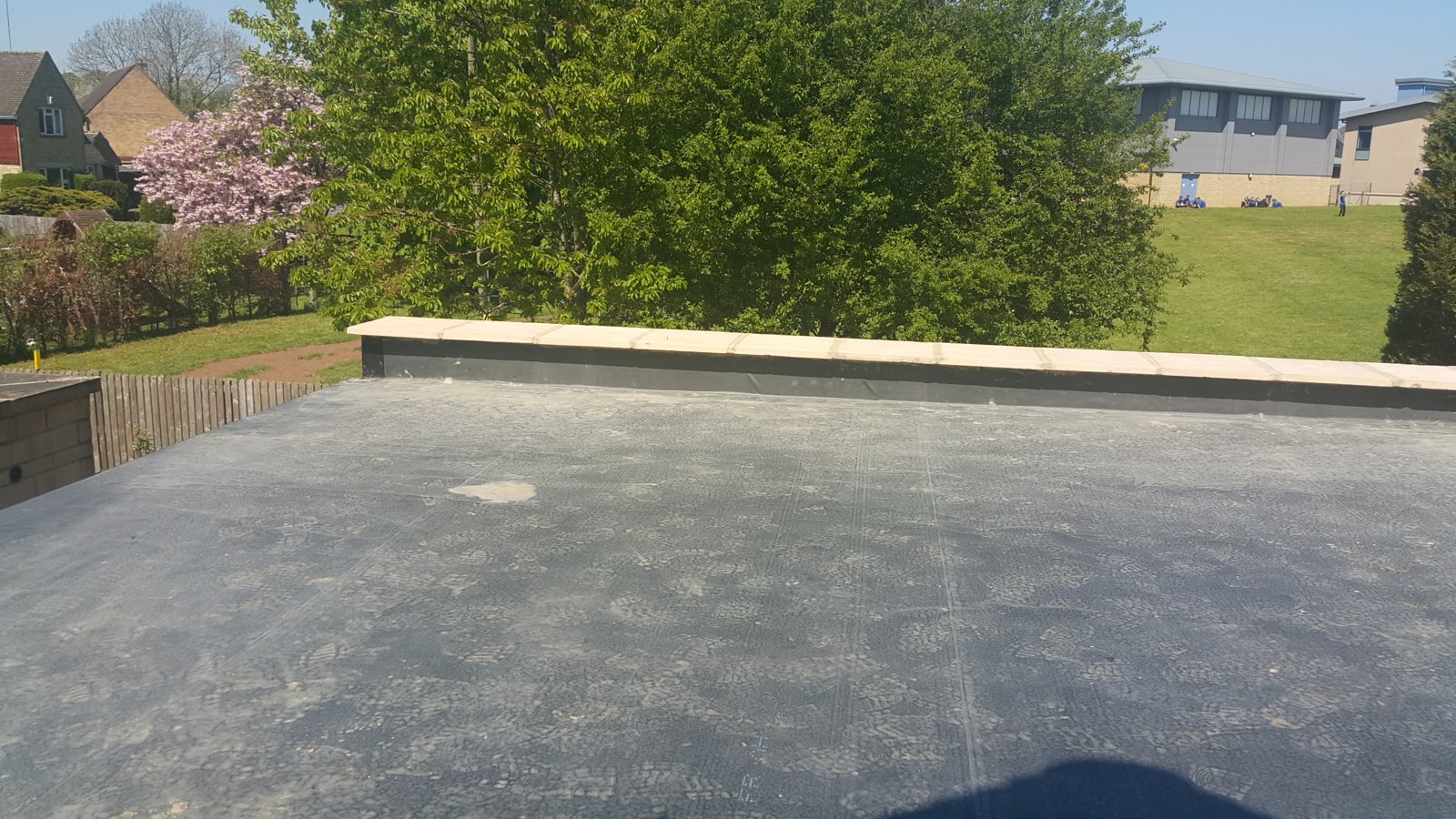

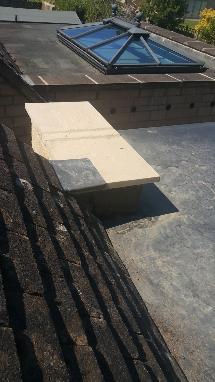

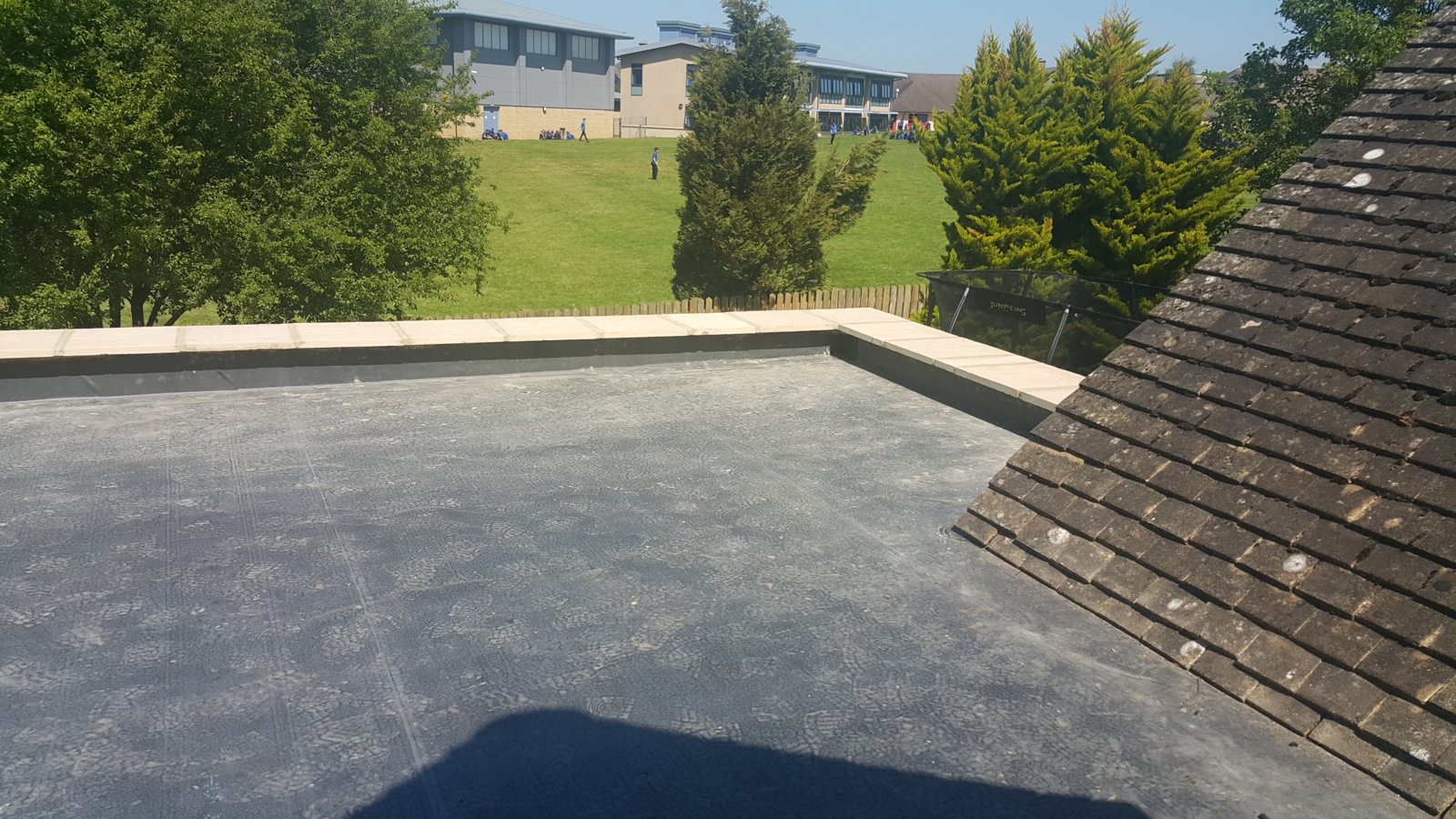

Hi all,
We are having a single story extension built. The house was originally built as one of a pair of similar properties in the late 70s. Our neighbours already have a single story extension with a flat roof and parapets. Due to this, we opted to go for the same style of extension to keep things looking consistent.

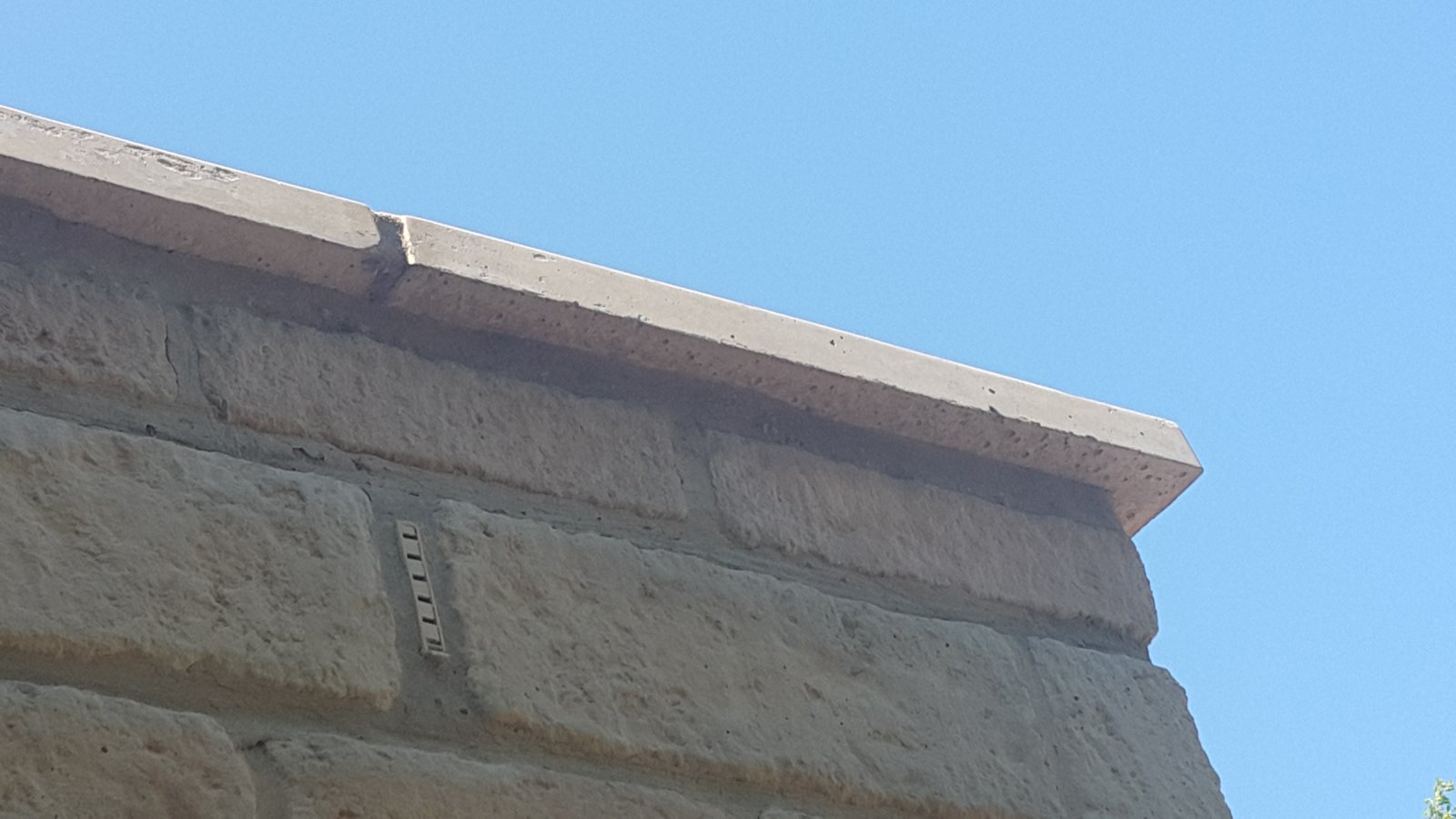

I have been away from home with work and when I returned yesterday, I found that the builder had 'finished' the parapets by coping them with 1 inch thick concrete paving slabs. Not only do these slabs look poor (in my opinion) as a capping, but they do not have a drip edge or slope back to the flat roof for run off.

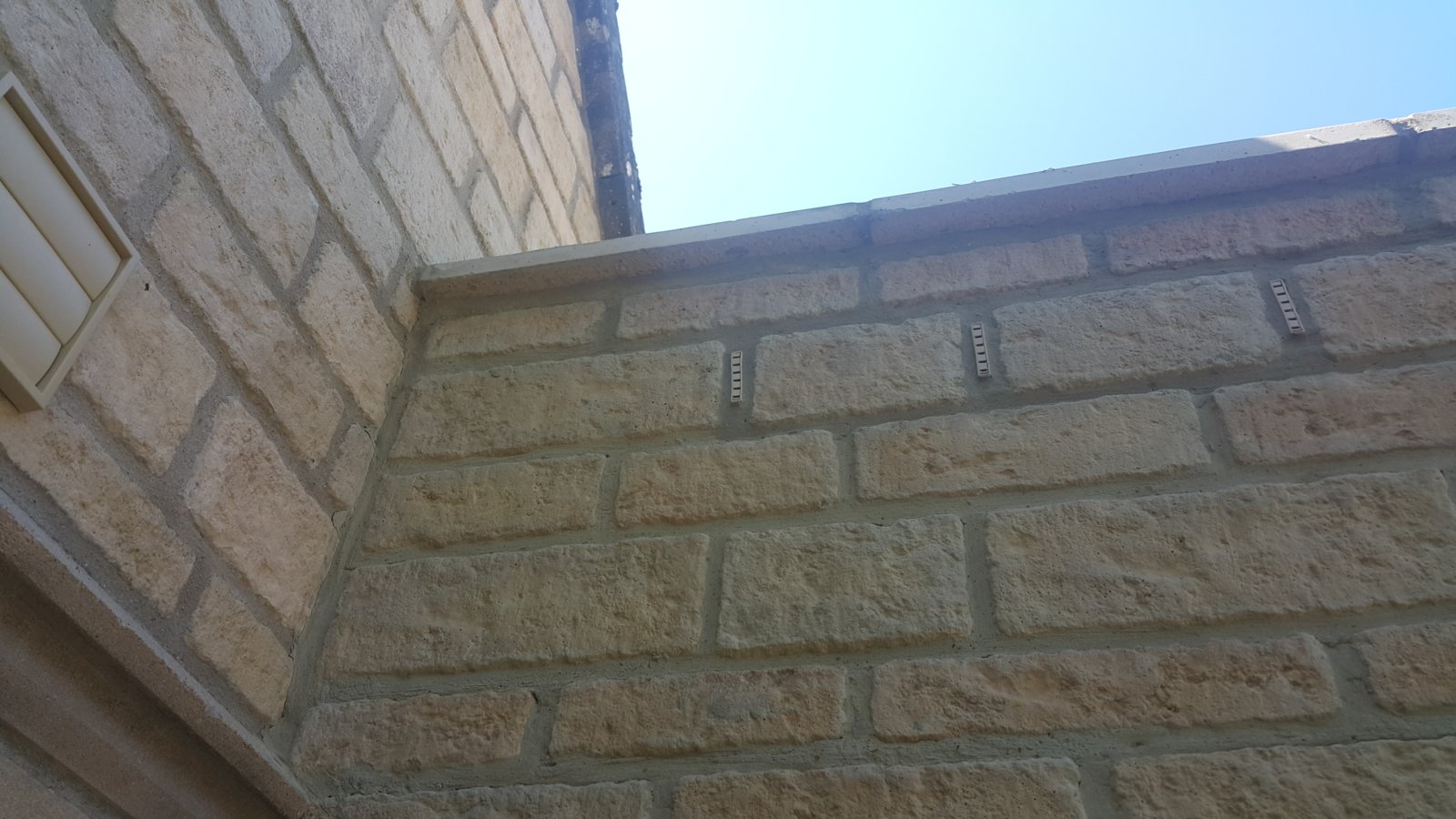

I have spent a bit of time searching this forum and 'think' I've learned a couple of things. After I asked my builder, he told me there was no dpc under the slabs because it didn't need it. He said this is due to the fact the wall has a cavity tray and if water gets in it will just come out again.
I was under the impression that the first line of defence of a modern cavity paraper wall should be a coping stone with drip edges and a slope back to the flat roof to prevent water staining the brickwork (does anyone know the required overhang?). The second line of defence should be a dpc that is supported over the cavity (by eg 3mm slate) and extends 10mm out from the mortar/ brickwork on each side. The third line of defence, if everything else fails or if water gets in from somewhere else, would be the cavity tray.
Am I right or am I wrong? Has the builder 'finished' the walls in an acceptable manner?
If he won't put this right, I may need to DIY the remedy, how should I proceed?
I would really like to know your opinion wether it's anecdotal or evidence backed. I could really use some evidence to take to the builder but I can't find anything on building regs.

It's a nice job but partly wrong.
There should be a slope and a drip on any wall copings.
I can see where the builder is coming from regarding a DPC in context of the parapet not being very high. Not quite right, but not the end of the world.
For some of your evidence, just put " parapet wall NHBC " into google.
Other evidence will be in various BS or EN standards which will deal with the relationship of roofs, flashings, copings, parapets and cavity walls.
If your mate is an AT, then he must surely know how to design a parapet. But if you look over at the neighbours, if that is the same and there are no issues, then you could expect the same performance.
BTW, that bottom row of tiles rubbing on the flat roof membrane would be a bigger concern and potential cause of problems.

Next door's that is shown in the pics is topped with the appropriate coping stones (75mm / 50mm once weathered sloping back to the roof with drip edge). I had specified to my builder to make it like next doors (I was coming from an aesthetic point of view as I knew nothing about copings), and he responded that it was an ugly concrete and he would get better colour match. There was no mention of 25mm buff concrete paving slabs. It was only when I started to search on whether this was an appropriate topping that I discovered it probably isn't - primarily as you have stated that it should have a drip edge and a slope.

A really big thanks for pointing out that bottom row of tiles. I'll see if a row can be removed. If the flashing doesn't run high enough for this, perhaps I can add small rubber blocks under the front edge of the tiles to prevent rubbing the epdm.

I think copings are usually 400mm for a 300mm-350mm wall, you can have once weathered or twice weathered.
Parapet walls needs careful designing, they are prone to leak!
Your builder could've fitted parapet cavity closer, they are only £20 or so /2.4M
https://www.roofingsuperstore.co.uk...rFY5cybbMvsFO3Cbvc_tEB4qQWiZer3UaAvDREALw_wcB
The work looks nice and neat its shame the builder didnt go that extra distance with the correct detailng

I think you're sizings are correct, 50mm appears to be the required overhang from NHBC documentation.
I was under the impression that the cavity closer was to prevent the DPC troughing into the cavity. As there is no DPC, I don't think there's a closer fitted but I shall ask him. Does it fill another purpose?
