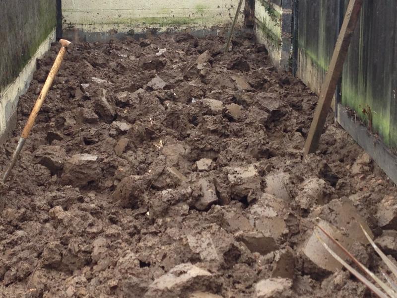

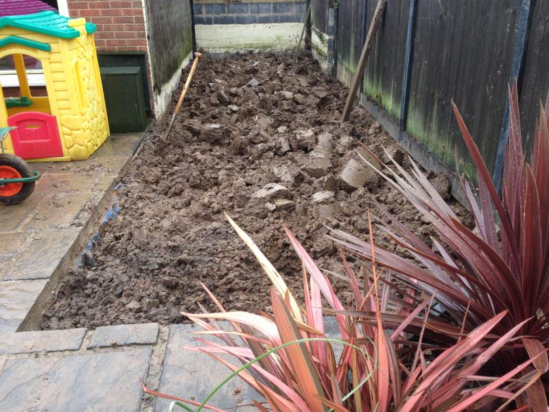

Hi all, I am new to this site and was hoping for some advice...
I have recently taken on a garden project in order to give my young children some grass to play on for the summer.
I have removed decking and a couple of extra paving slabs with a Sthil saw.
I removed as much sand and hardcore as possible which was under the paving slabs.
I have now started to turn the existing soil over. However, the first half is has a high clay consistency.
So far, this has been turned over with a spade, but the plan is to hire a rotavator next weekend to make things a bit easier.
I will then introduce new topsoil where necessary, followed by leveling, raking, treading down and finally adding turf (whilst constantly looking for and removing stones over 25mm in size).
The pictures below indicate the stage I am up to (taken in the rain). My query is would t be best to remove the existing clay type soil and buy new topsoil in, or will rotavating cure the high clay consistency?
Many thanks in advance for any advice.

Rotavating alone won't change the amount of clay in the soil. To improve the soil you need to mix in some other stuff like topsoil, sharp sand or leafmould.
The area you are dealing with looks quite small: trying to control a rotavator in there is likely to be a right faff, with the potential to knock your fence down.

Grass will grow on even a thin layer of soil but to grow well you really want 6 inches of decent soil before your clay. This can include your sharp sand and compost.
No need to leave anything to sit just plough ahead.
Remember to firm the ground by walking all over it and 'heeling it in' before laying or seeding.
If turfing then a thin layer (1 inch) of sharp sand is an especially useful thing to help final levelling and your turf can go direct on that
If there is too much clay you will create a false water table very near the surface and the lawn will become boggy when it rains.

Make sure you choose the right type of grass, the corner looks shady and if it's for kids you can go for a more hard wearing mix.
