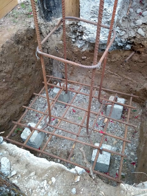

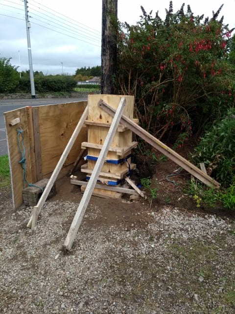

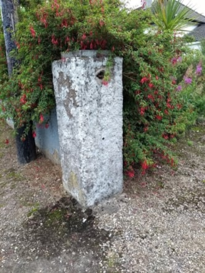

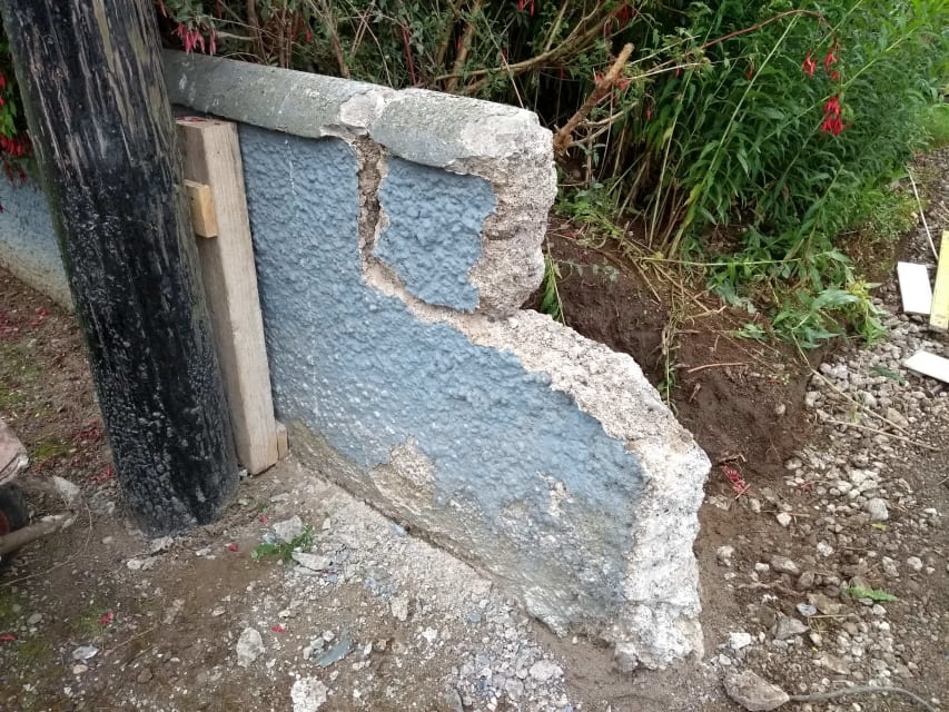

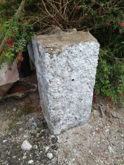

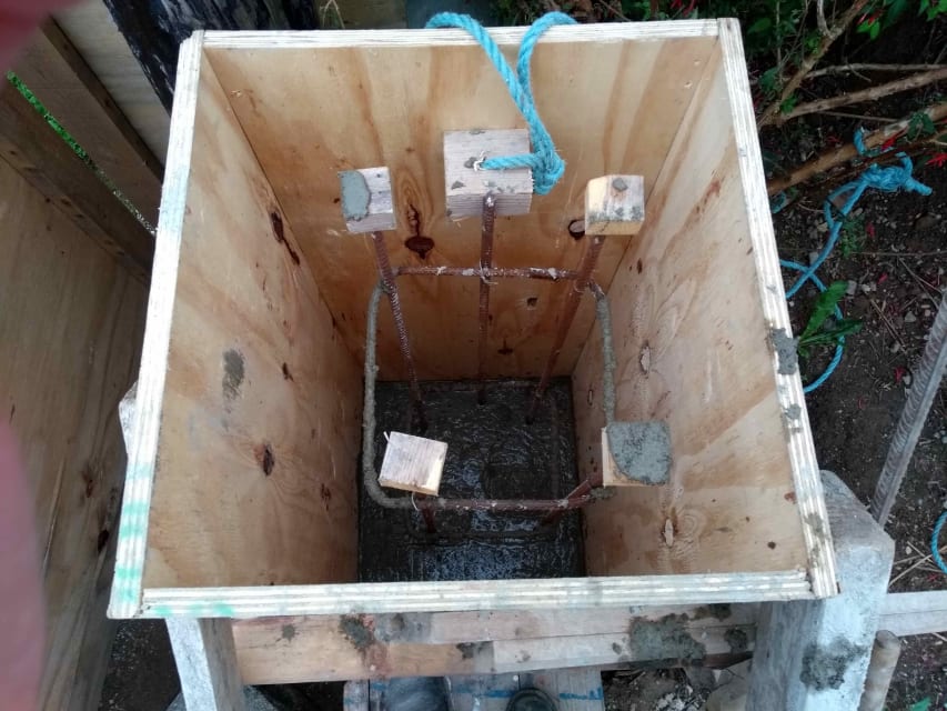

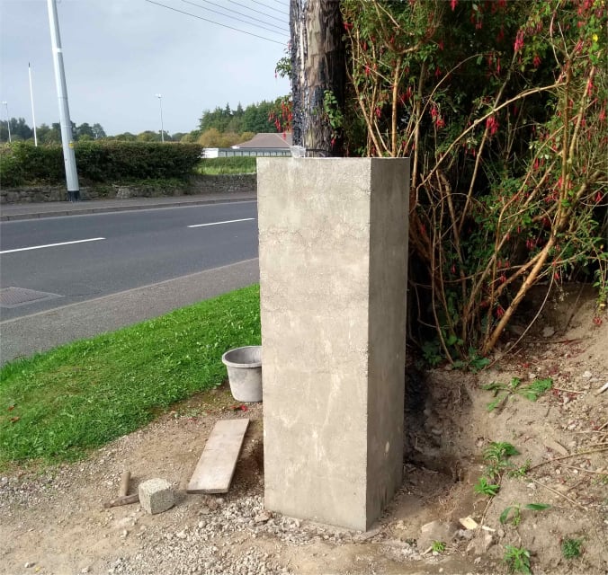

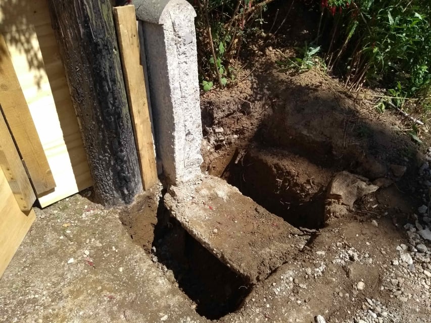

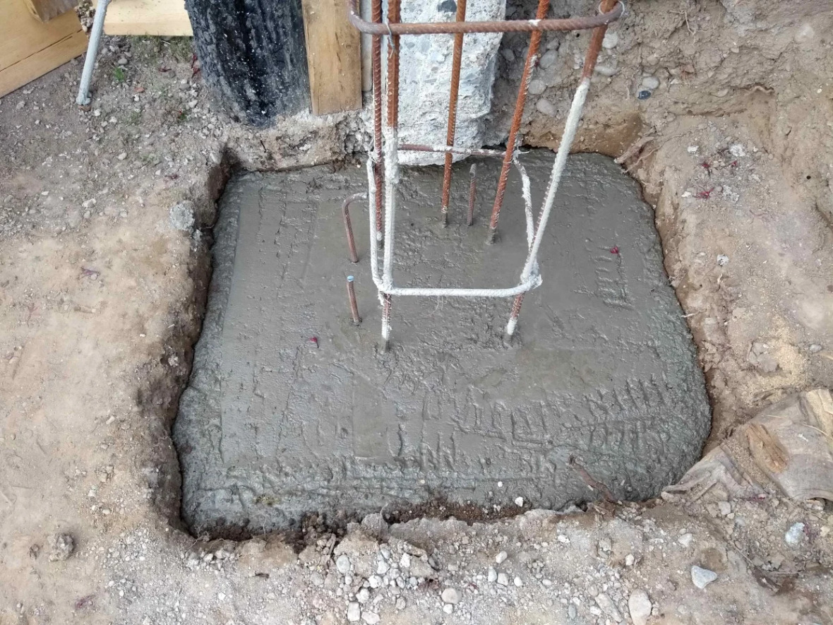

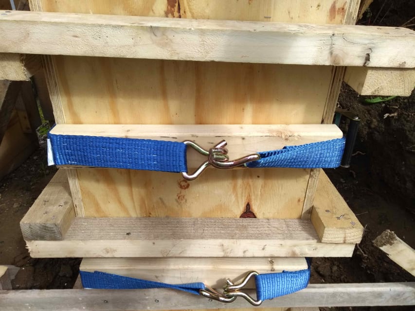

Some photos from the demolishing of my old gate pier and rebuilding of the new one.
Screenshot_2020-09-30 how-to-build-a-solid-concrete-gate-pier jpg (JPEG Image, 332 × 443 pixels).png

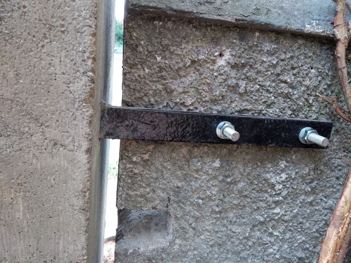

Just in case, I tied the wall to the pier to give it support. The original wall didn't have any supports over an 80 foot span. It's foundation was quite shallow also , about 6".
