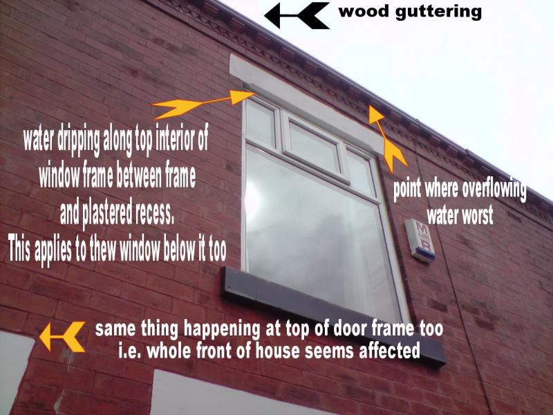

I live in a 2 bed mid terrace house and I am experiencing damp problems at the front of the house. I was advised that the guttering needed replacing which I have had done. However when there is a heavy downpour water streams down the front outside wall from the roof. More distressing is that when this happens water starts to drip from around the top of the windows frames on the inside of the rooms involving this wall. At first the water only seemed to drip in the downstairs room (where the window frame is fitted into the recess), but now it has started dripping from the window recess in the room above too. I am on a relatively low income since my husband left and would really appreciate any advice.. I just don't know where to start. I am sorry if my discription is not too great, but i can supply some images of the affected area if needbe. My deep thanks for any help that may be offered. Taz
The problem with terraces is that you can't always get the fall (slope) necessary to let the water run away, so it spills over the top. If people either side of you have had new guttering and they've raised theirs a bit you can be the low point in the chain and you get the sort of problems you are getting. Sometimes you can just wedge slate under it to give the fall. Also, check that when it rains the downpipe is discharging water as if it is blocked you'll get the same problem. Does your house have a downpipe? If not, as a last resort you can always add one.

Can you take a photo?
As joe says, an extra down pipe will help as there maybe not enough downpipe to cope with the rain demand or the gutter not fitted correctly to drain out, not sure why you had the gutter replace, was it leaking?
how is the rain dripping inside the rooms at the top of the window frames? My neighbour says it must be getting between the wall cavity and running down.....do you think this is the case?

what type of guttering have you got. I think you must have lead lined guttering by the amount of water you are getting in your house.
Yes. It is common for water to drip down the cavity.

What does felt have to do with it? It's the gutter overflowing. :confused:
New felt means new roof £5k upwards.
If it didn't need felt before it doesn't need it now.
It just needs the fall of the gutter adjusting.
