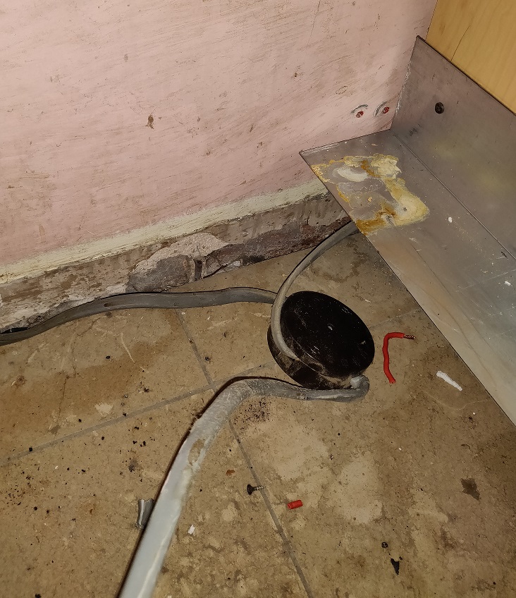

ok, I know this has been done a million times but just checking!
My existing electric hob is in real need of replacement so got a new one coming this week. The current hob is 6kW and there is a separate built under oven of 5.1kW. I have a 32A MCB, 6mm old colour cable via a cooker isolator (plus built in 13A socket). There is no cooker outlet but a standard junction box underneath the oven - where it splits into a 6mm cable to the oven and 2.5mm to the current hob (the plate on the bottom of the hob shows it requires 2.5mm cable)
I am replacing the current hob with a 7.35kW induction hob - as far as I can tell this cable setup is still big enough, given the diversity considerations, but would I still be better replacing the 2.5mm? The hob manual does state it should be wired with H05BB-F 70C heat resistant cable (which I believe is flex) - can this be used with the junction box above?
And the junction box itself - is that ok? I understand there is no specific need for a cooker connection unit other than making things neater/easier. If I get around to refitting the whole kitchen then that would probably get done with the rest of the electrics, but at the moment its just the hob so want to do as little as practicable.
A dual cooker connection plate on the wall would be the sensible solution.
This would allow the hob flex cable to be safetly terminated with the existing conductors
Some hobs come with flex
thanks for the links - will have a measure up, but I don't think there is much clearance behind the oven - certainly don't think a surface box would fit, the sunken box in the wall might just.
it's usually best to put them in the cuboard next to the oven, directly below the isolator switch.
i.e where the cable comes out the wall

Yeh cheers plus the load for the oven does this not take it over the current carrying capacity of 2.5mm cable if both oven and hob are on at same time ?
The 6mm cable went into a junction box that split it into a 6mm for the oven and 2.5mm for the hob. I have got some 6mm heat resistant flexible cable (as the hob manual "required") to replace that 2.5mm anyway.
