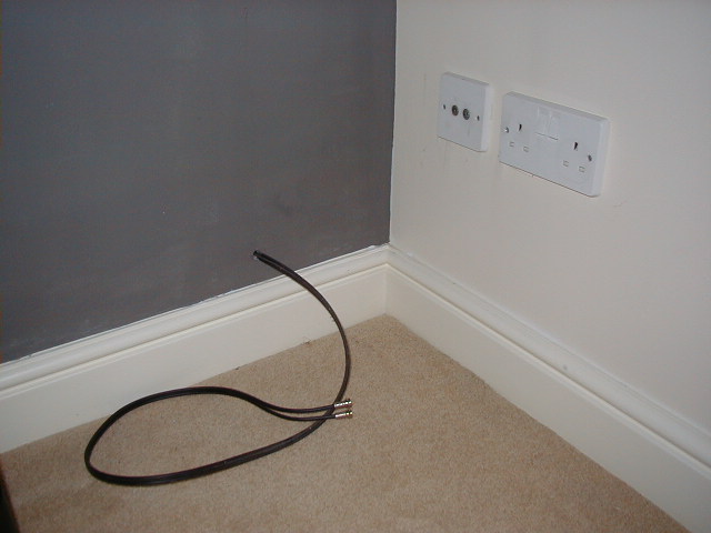

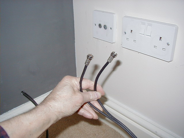

Just moving in and don't know what cable to connect where...
There's a sat dish (apparanty normal aerel won't pick up a signel here) and supposedly I shoud get freesat?
But these cables don't look familiar so what do I plug in to the TV?

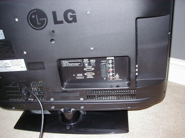

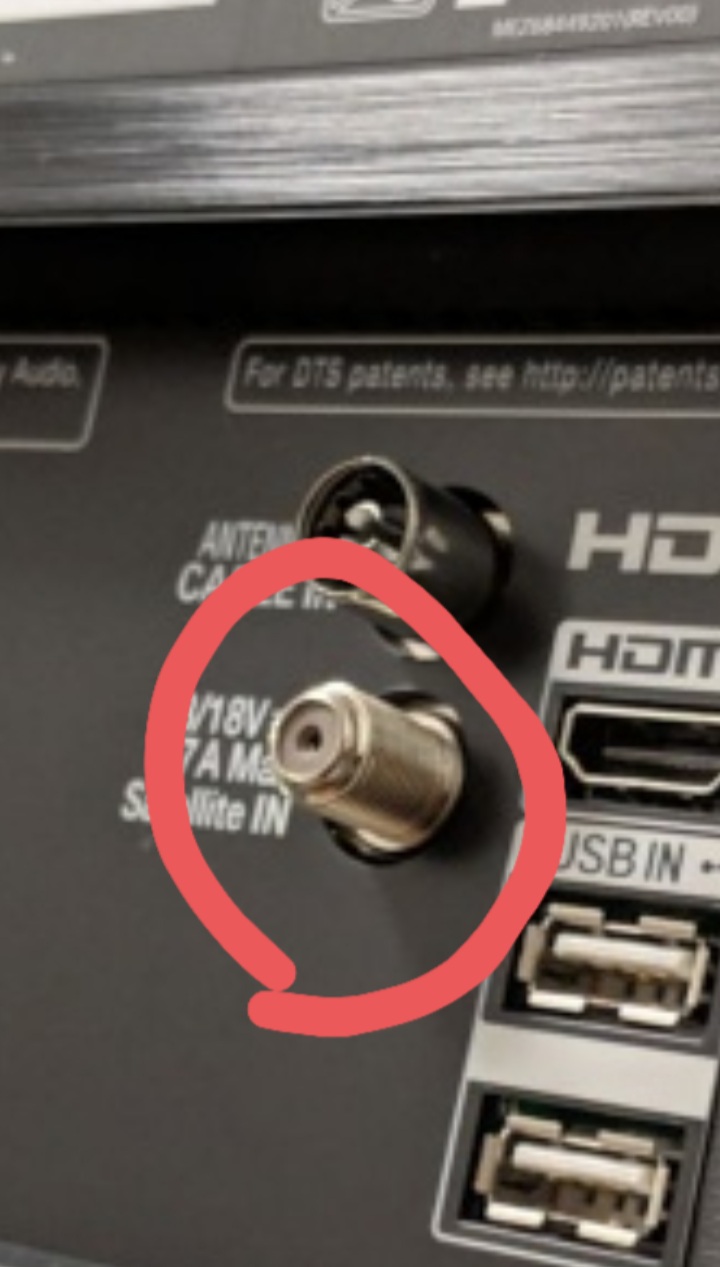

What connections do you have on the side of the TV?
The cables coming out of the wall are F- plug connectors and are usually associated with satellite dish connections.

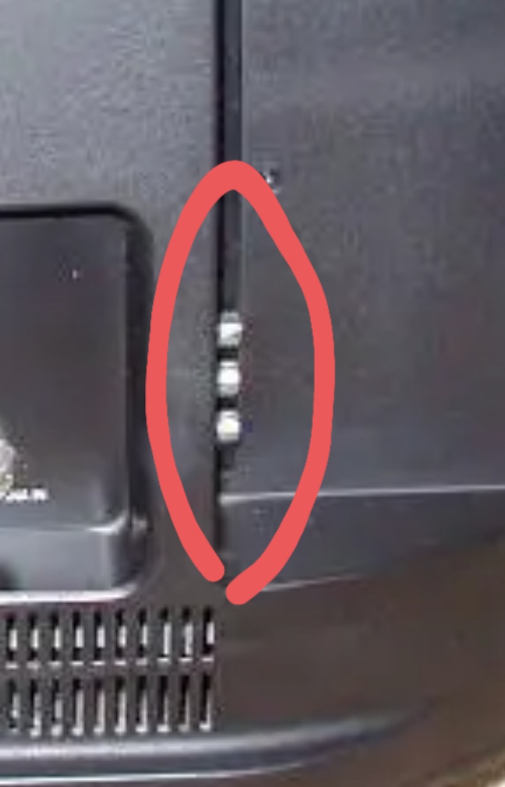

My LG TV has dual Freesat/Freeview tuners, but if your TV doesn't have a connection looking like this...
...then you may not have twin tuners, and could need an external Freesat box for your satellite feed.
There is also a standard TV/FM antenna faceplate on the wall - it's definitely worth a try to see if you can pick up Freeview?

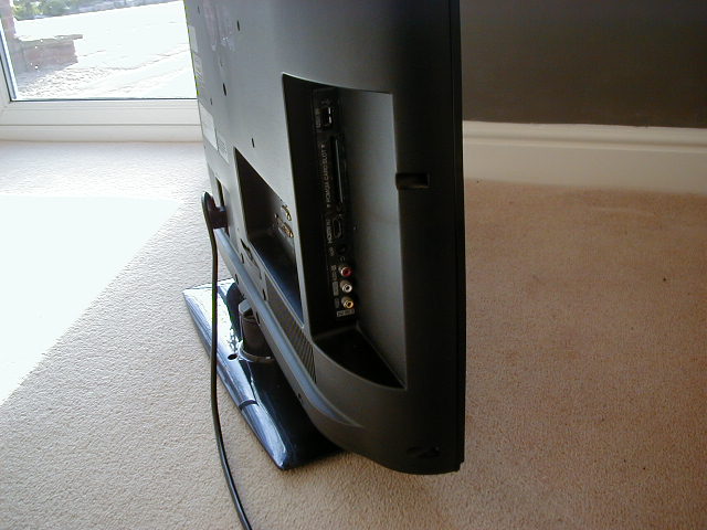

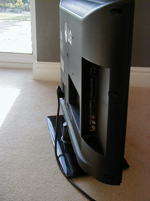

side of the TV photos.
Yes, the cables from the wall definitely lead up to the sat dish, but what do I plug them into? And why two sockets? Could the sat dish D plugs be meant to connect into the sockets in the wall and then other sockets (there are several around the house) get free sat like that....?

Your TV does not have a satellite receiver. The two cables are of no use without a separate receiver box.

If there is a TV aerial outside, get one of these: https://www.screwfix.com/p/philex-coaxial-cable-1m/41720
plug one end into the wall socket marked TV and the other into the TV aerial socket.

Why two cables? - There are two cables with the screw-on connectors because that's how a Sky box or Freesat recorder works. It needs two feeds to allow the watching of one channel whilst recording one or more other channel(s) at the same time.
A simple Freesat or satellite TV tuner (they're not that same thing) is a watch-one-channel-only, no-recording device. This is the case with a lot of TVs that used to have satellite or Freesat reception. They need just one connection because you'll rarely be doing anything more than watching one channel as it is broadcasting. If recording is an option - and don't take it as granted that it is - then you're stuck with watching the channel that is being recorded.

"Where to connect these cables to the sockets on my TV?" - Your LG TV doesn't have a satellite signal input. If it did, there'd be threaded connector marked SAT or something similar. [See the second image in post #2 from @RandomGrinch. He circled the connection on his TV.] Your TV doesn't have that, and it means there's no suitable tuner within the TV for satellite/Freesat reception.
Normally at this point the next question is "can I get an adapter?". The answer to that is no. This isn't a case of changing the sex or design of the plug end to fit. The satellite signals running through the cable are different to Freeview. They're a different language, if you will. You need a box or receiver that speaks satellite, and that would be a satellite receiver.
"How many cables do I connect?" - for a watch-live satellite or Freesat receiver you need just one connection. The other cable is redundant at that point. It doesn't matter which cable you use, but it would be prudent to test both. Where you want a Freesat recorder, then you'll need both connections. As @foxhole said (post #3), get a Freesat box, plug in the lead(s), then connect a HDMI cable from the box to the TV.

Do get a fly lead from the white wallplate to the TV input. It's likely that it will be a female to male TV plug type (if the wallplate has both male and female outlets - the male being TV, female FM/DAB radio? (A closer pic would confirm).
It may "just work". The Philex one linked to is not the best quality, but may at least prove something and is cheap enough.
If not, do also check the loft for where that wall plate connection goes... quite likely into the loft. If just cables with no plugs or an aerial up there it may be that a loft aerial could work? Depending on the prediction numbers. The transmitter network is designed around the use of outside aerials at rooftop/chimney height.
If there's a mains powered box up there connected to the cables, check it is powered on (take a pic of it with any name/model numbers clear to read).
Carefully remove the plate to see if it has one or two cables to it and also to assess if it is a quality screened plate or a cheap version.
