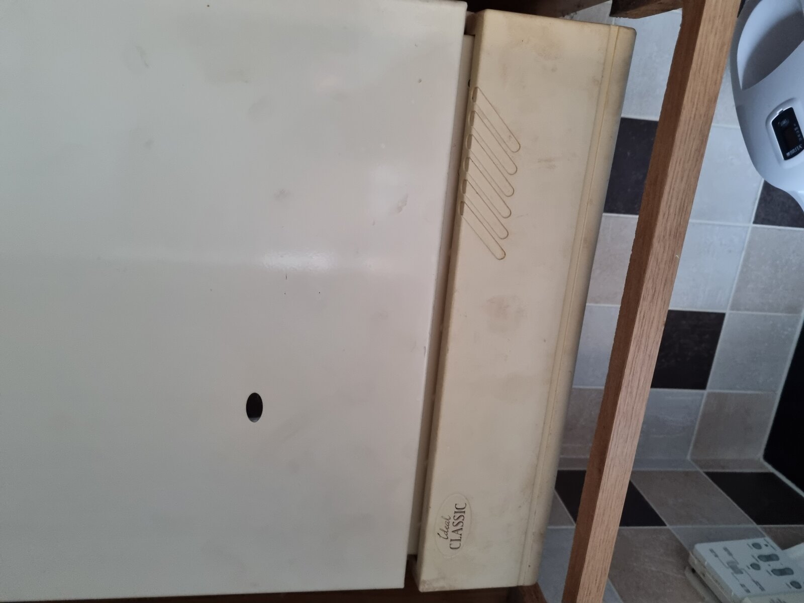

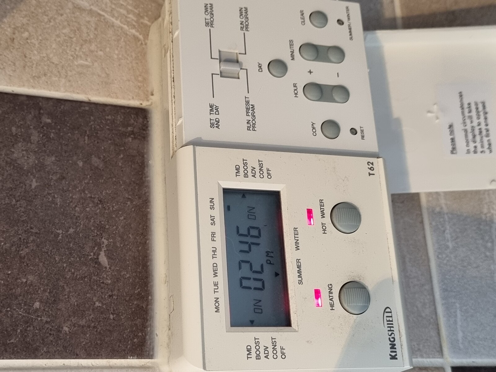

Otherwise we've got downstairs next to the boiler a "Kingshield T62". The boiler I'm struggling to figure out what model it is, but attached an image "Ideal Classic".
My issue is here is that I simply don't get how to ensure the hot water comes on to the times I've set it. The pilot light has a small blue flame consistently and both lights above hot water and heating are red. If I don't have the heating ON, then the Nest doesn't work, which fair enough. However, does the hot water need to be set to ON all the time? Better yet does anyone know how to ensure the hot water comes on at preset times? Should the boiler be showing a small blue flame at all times? (I assume given its age that yes given its the pilot light, but at this point I'm questioning everything).

It all depends if they’ve wired it in correctly. The only way of knowing if the hot water comes on is to try it or wait for the set timed period and see if the boiler fires up, if it does then it should be done by the Nest. Again depending on how it’s wired up, then that would depend if you need the T62 on constant. There should be a cylinder thermostat for the hot water temperature control and this should be set to 60 degrees Celsius.
Hi,

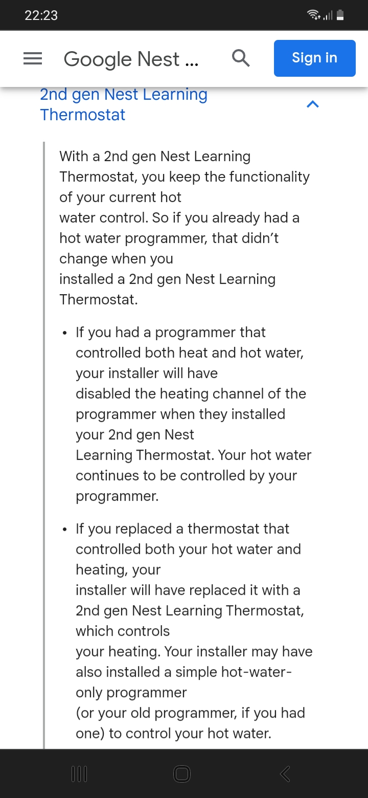

The 2nd gen nest doesn't have hot water controls:
Theoretically (if it's been wired correctly!) , The T62 should still be controlling the hot water. So (I believe) doesn't need to be on constantly - set the timer and see! :)
set CH to constant, set HW to timed, set up what HW on and off times you want then use slider to run own programme, the nest will override the programmer, the nest and the programmer dont actually directly tell the boiler to come on, you will have either a 3 port mid position valve or 2 x 2 port zone valves, the nest and programmer operate these , and these in turn tell the boiler and pump when to come on and off
