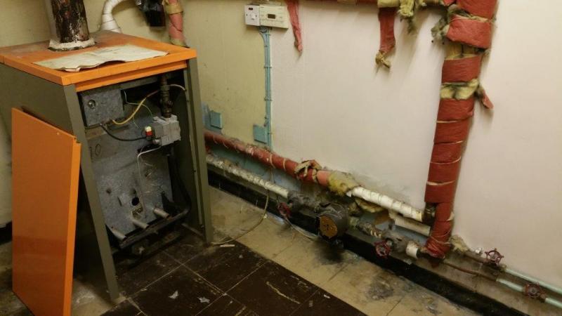

I have recently bought a new house, we exchange in a few weeks time all being well. Its a semi, probably a bit larger than average semi with 4 floors and approx 4500 sq feet (roughly). It is currently centrally heated which consists of a very old boiler (Ideal Standard Concord 'C' 170 48.5kw) in the (semi) basement, a HW storage cylinder on one of the landings, system is vented and 2 tanks in loft. The system was installed in 1976 as I have the original paperwork and invoice (£1950!!) Sorry for all the questions but I have some thoughts on what I would like to do, hopefully you knowledgeable people can discuss whether these options are sensible / stupid or maybe put some other ideas out there before I get some quotes in a few weeks time
Clearly I need to replace the boiler, I would also like to have an un-vented HW cylinder as I have this in my current house and is excellent (dislike combi's in family homes).
The pipework is sensibly laid out, and the workmanship looks to be good - I would like to keep the pipework (with necessary adaptions for removal of header tanks and cylinder) and have a new, sealed system boiler and un-vented cylinder fitted where the current boiler is.

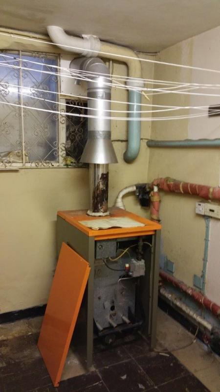

I have tried to attach a picture, hopefully that helps You can see the ground level out of the window (about 2/3 up the window is ground level) There is also a clay soil pipe entering and exiting the room from downstairs cloak room above.
- Boiler
  • Would it be possible for the condensate to discharge to the sewer pipe (clay) in the picture via a water less trap if boiler was high enough on wall? Otherwise I guess a pump is only option.

Boiler
You could theoretically discharge the condensate into the clay pipe but I can't think of a sensible way of joining it in that won't leak. Best pumped to somewhere else.
PRV must go down all the way, if it goes uphill you'll end up with undrained water that could freeze, blocking the pipe and leading to doom
You'd need to choose a system boiler carefully to ensure that the pump was strong enough to circulate to all floors of your house. A Heat Only would give more pump options.
If the whole house method says 36kw that should be fine, but it is a significant drop from what you have now so a bit more might help. It depends partly on how effective your current boiler is.

That clay pipe looks like cast iron to me
You may well be right. I suspect the same applies - difficult to get a reliable Tee into it for condensate.
