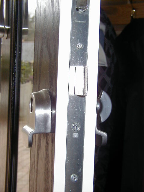

UPVC door with central locking and top/bottom bolts.
The central bolt on the front door engages, but not the top and bottom bolts. And the key turns without resistance several times.
Door/window repair bod has said:
"It sounds like it could be an issue with the locking mechanism. If it requires replacing the estimated cost would be £245+vat depending on what lock I would need to order."
Does this sound reasonable?
Try ironmongerydirect (all one word)
Then search "multipoint locks"
Looks like a AV2 or 3 slam lock, probably Winkhaus, £150ish retail plus 30% mark up plus labour so probably about right
