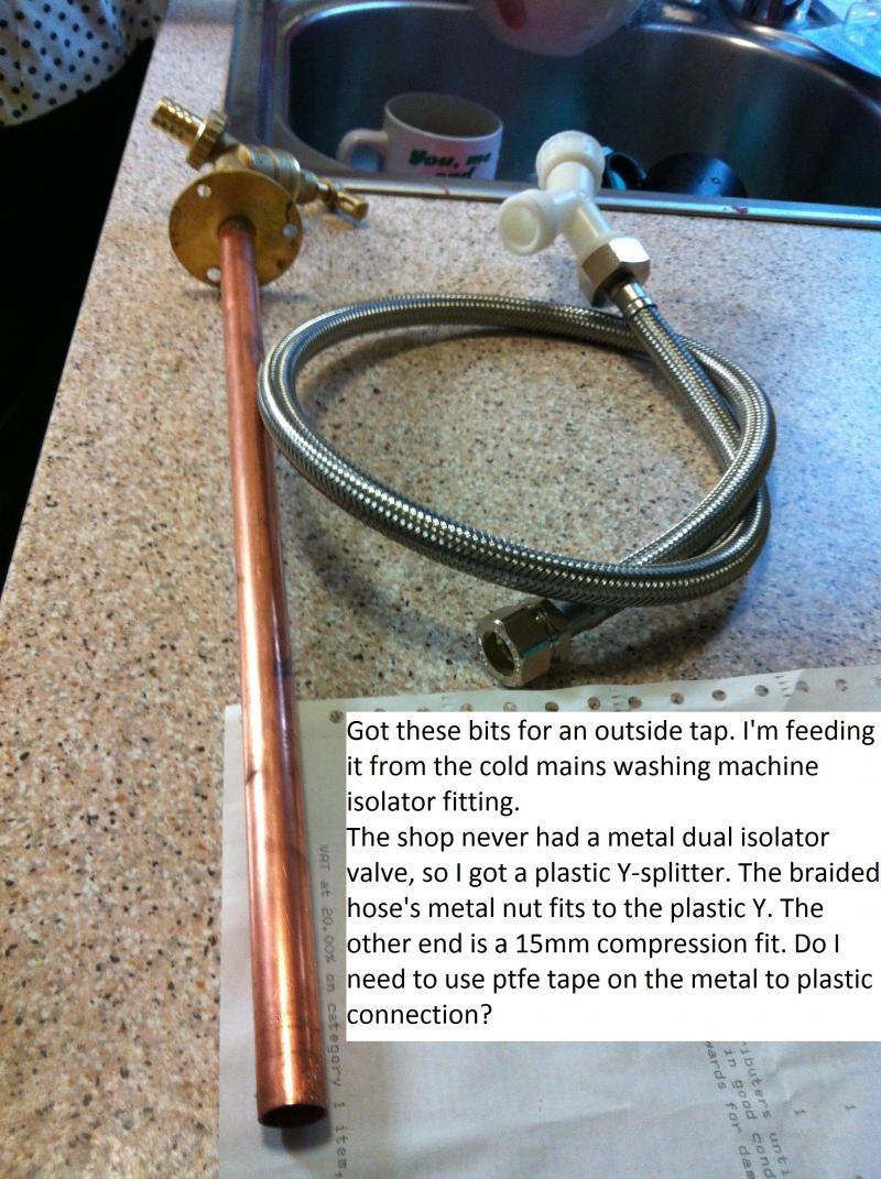

1) Outside tap - you've chosen a strange way to feed it and it doesn't comply with water regs. You need and internal isolator, double check valve and draincock to comply. You also need to sleeve the pipe passing through the external wall.
2) The fitting in your second picture is a type B light pattern draincock. This type of key to operate it. http://www.screwfix.com/p/plumbing-tools-by-rothenberger-4-way-radiator-services-cabinet-key/84379.
3) The black plastic wastepipe is probably the condensate drain from your boiler (the 15mm copper in the same photo is likely the pressure relief discharge from the boiler). Not best practice to drill through the lintel to install them though!
4) The internal stopcock is in a strange location and could be moved providing that your are prepared to make good the damage caused by moving it. You should always have an operable internal stockcock in addition to the water providers external one.
Does the stop cock work? If you want to keep it, just make a neat hole in the back of the new cupboard.

I originally wanted to feed the outside tap by replacing the washer isolator valve for a dual Washer/Dishwash isolator valve,
http://www.ebay.co.uk/itm/Dual-Appl...DIY_Materials_Plumbing_MJ&hash=item3a920605d7
but the merchant never had them in stock. The plastic Y-Splitter was crap but just about done the job. I may order the Dual wm/dw isolator though to be safe, as I think the Y-splitter is for draining rather than mains pressure feeding.
I have an internal stopcock as the main enters the property, above that is the type B light pattern draincock and above that there is also an electric switched stop
I turned the kitchen wall stopcock (in supplied image) off and the mains water was still on. There was also a poly tank in the loft which is now dry and unused, so I was hoping it had something to do with that and the stopcock could be removed!
I want to use the draincock to water the plants at the front, but when I attached a hose with a stop end to it, water came out from the tap spindle part! Maybe that's why it's just a drain, as it can't handle mains pressure at that point! Any how it's ok if I take the stop end off the hose.

I know it's over complicated but I don't have the tools to bend the pipe over the hot feed and my knees aren't much use nowadays, so was trying to do it within my capability. I've ordered the metal isolator dual valve to give it a stronger fixing though. I think it should be safer then. Pity the cold feed wasn't on top of the hot!
