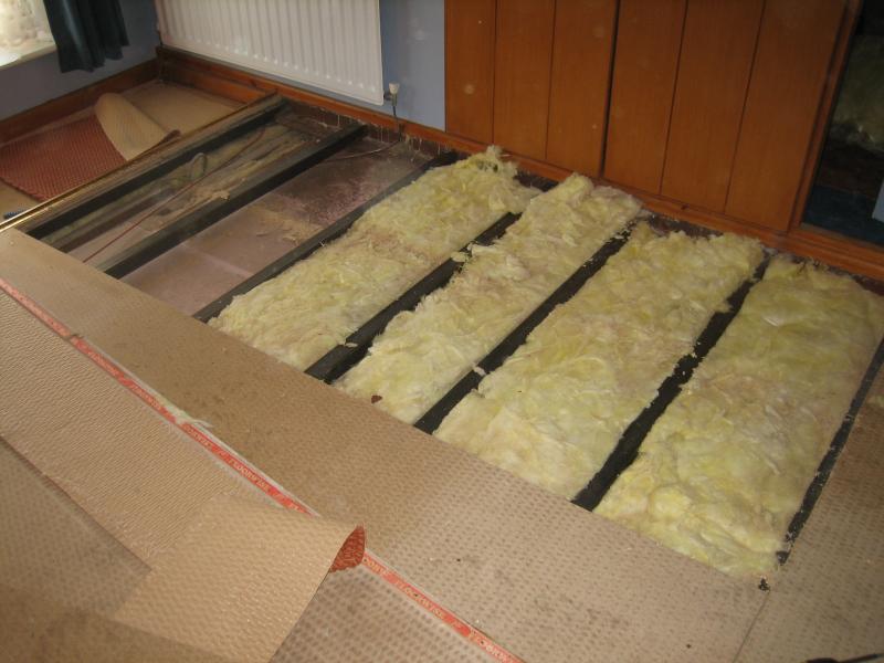

As of today I'm a proud home owner, and I'd like to get your opinions on a loft conversion in my new place that one of the previous owners did. I was almost certain that the loft had not been built with building regulations approval, since it wasn't advertised as a bedroom, and today I found a letter under the attic carpet that actually said 'this bedroom was built without building regulations approval' :LOL:

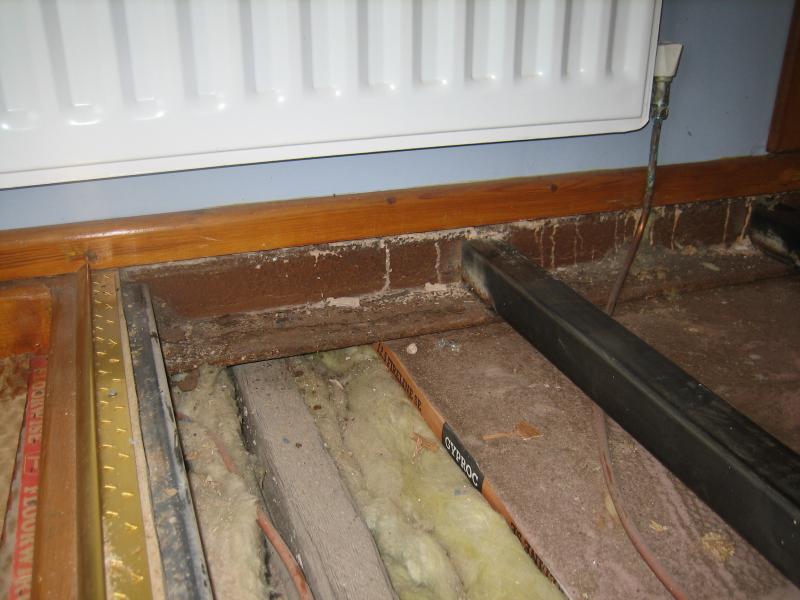

Anyhow, I'd like to get an idea of how much work would be needed to bring it up to scratch, save me any nasty shocks when I get a builder round to assess it. I popped up some of the floor boards to look at the reinforcements, it appears to have a steel joist at either side of the room ('L' shaped, approximately 4" x 4" x 1/3"), then 2" box section is run between these to support the floor. I wasn't able to see how it was anchored to the walls unforuntately, and as far as I can tell there's no RSJ through the centre, the room's roughly 10' x 14'. My biggest concern is whether the reinforcements are good enough, since this is the biggest bit of the conversion, any idea?

Phone Building Control and get them out, they'll visit without being appointed so don't worry about them charging you. they'll tell you exactly what they'll be looking at to get your approval sorted out. They'll look at, amongst other things, adequate structure, insulation, a compliant staircase, fire regs for the rest of the house, you'll need fire doors on every door ground and first floor that opens onto the stair landings and mains smoke alarms ground and first. Its pretty hard to give advice on the structure unless you provide some more info.

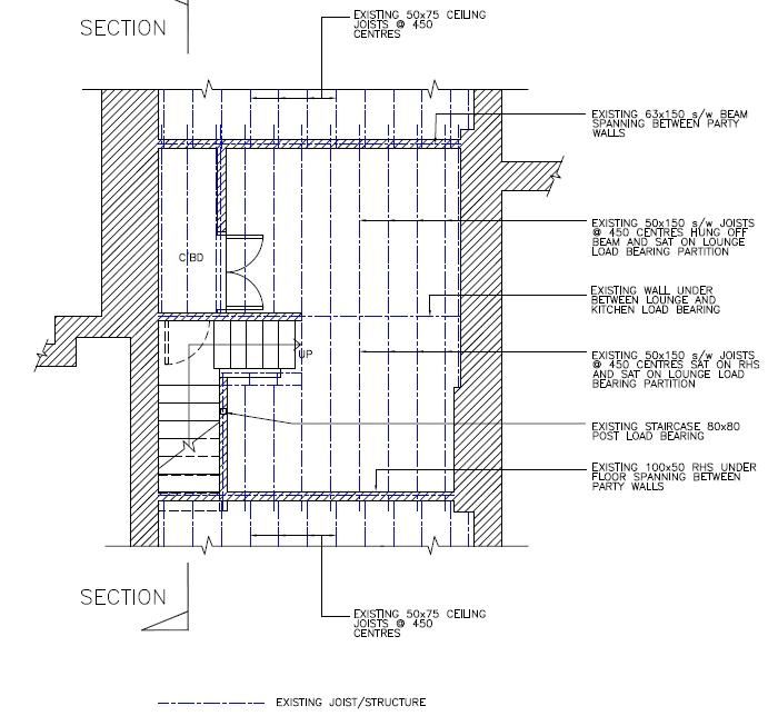

Size of house ie distances between walls, position of and size and number of any steel beams, are the RSJs box sections, angles etc. What are the spans. What are the spans, sizes and centres of any timber floor joists. Draw a crude drawing of what's where if its easier than describing it.
For example:
It doesn't have to be as elaborate but you get the idea, only if you can give us this information can we give you a good idea if you're existing structure will need beefing up or not.

- There are two steel beams in the attic , running from one gable to the other, these are separated by 12 foot. These are 4" x 4" angle section, 1/3" thickness.
- There are approx 10 steel beams running between the larger steel beams, 2" box section, can't tell the thickness, length 12 foot, welded in place.

These, in a typical lofty would normally be RSJ's around 180mm in height. spanning between them would be timber joists around 175 in depth. Your loft floor, apart from being very unconventional, sounds hopelessly under-engineered. Building control will, if they don't tell you to rip the lot out and start again, demand calculations from an engineer to prove they work. These will very likely prove the structure is under-engineered. Big-all has very likely hit the nail on the head.

Thought as much, 4" angle section did seem pretty pathetic, even an 4" I section (which I would expect to be several times stronger) sounds undersized. Maybe in a few years I'll think about redoing it all, till then I'll keep dreaming :) . Out of interest, you said it's unconventional, are you talking about the use of angle section, the box section or something else?
