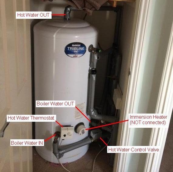

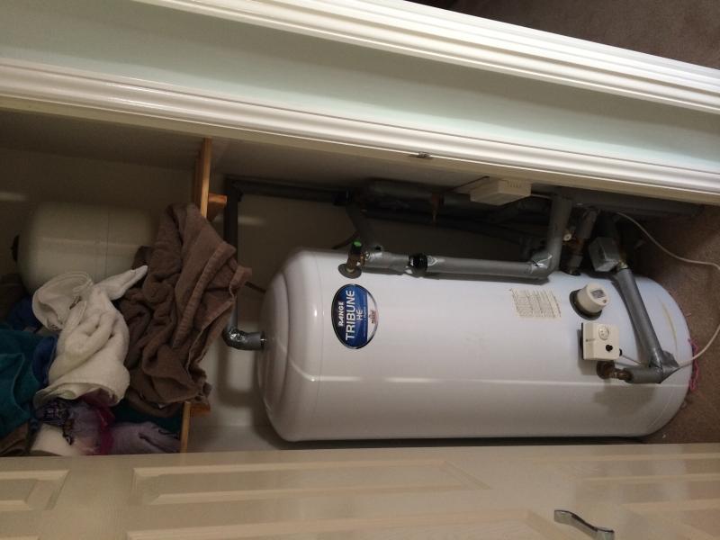

Can you post a pic of the cupboard showing the cylinder etc? A general view is better than close-ups of each item.
You should have a twin channel time clock. Hot water and heating. You can turn either one on at a time are both. The boiler fires the heats what you have switch on. In the winter months you would turn on both and once the cyliner stat reachs temperture it shuts of. Its the same with your room stat. Once it reachs the temperture you have set it will switch of until temperture drops again. As for your immersion heater you will more than likely have a switch in your kitchen that will heat the water without turning the boiler on tho would cost more to run

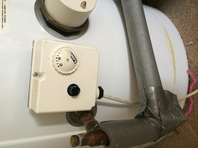

Does the boiler heat the water? If so how?
Yes
There is a copper coil inside the cylinder connected to the two connections marked primary. Heat is transferred from the coil to the water in the cylinder. Boiler water enters the left connection and exits from the right one. The Honeywell valve is controlled by the Range thermostat. When the water in the cylinder is below the set temperature (currently 45C) the valve opens, allowing boiler water to travel through the coil. It will shut when the water in the cylinder is up to temperature.

1.What is the size of the cylinder (litres)?
2. Don't understand the question!
3. Several hours and at least overnight.

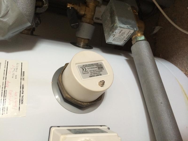

Why is there an immersion heater? Is this for instant HW?
It's there as a backup, in case the boiler goes wrong. Not wired up so not much use at the moment. Definitely not instant HW.

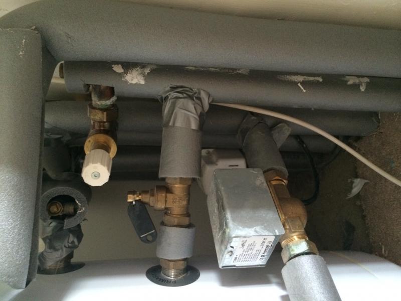

What is the motorised value for and why does it have a manual bypass?
I assume you are talking about the valve hidden behind the Honeywell valve. It will control the flow of water through the central heating. The room thermostat opens the valve when the room is below the set temperature.
The bypass provides a path back to the boiler when both valves are closed. This is required if you boiler has 'pump overrun', i.e the pump runs for a few minutes after the boiler turns off.
How can I switch the immersion off?
The electric immersion is not wired up.
