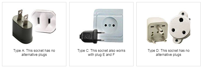

A quick search says all of these are used in Viet Nam.
The centre ones come with earth connections as well but I suppose you may have to source them from Europe as well.
And these which accept more than one type of plug but not the earthed C type.

You are correct that two pin round and flat can be used.
As far as I am aware, three pin plugs are not used or available and he would have to source the sockets and plugs from elsewhere.
As far as I am aware, these are the only ones used

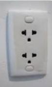

The socket in that picture is earthed but only the appropriate plugs will fit, including the C type I presume - BUT the earthed C type will not connect the earth connection.
Note the earth connections top and bottom.
The flat plug for appliances that are not earthed.
