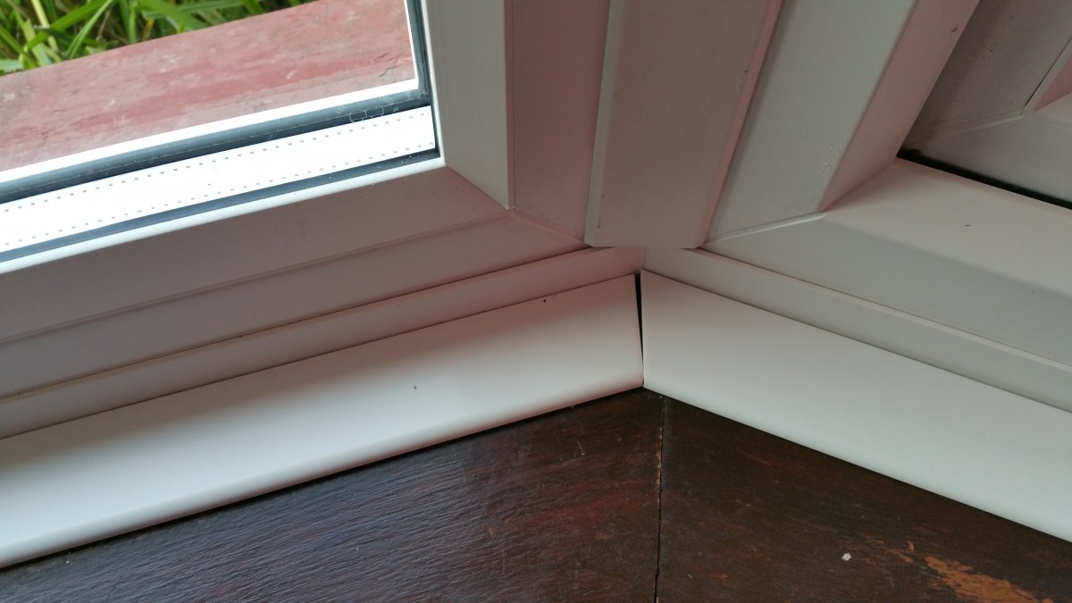

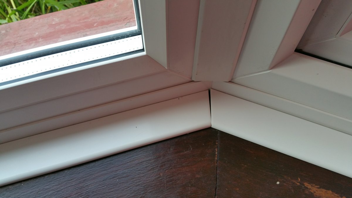

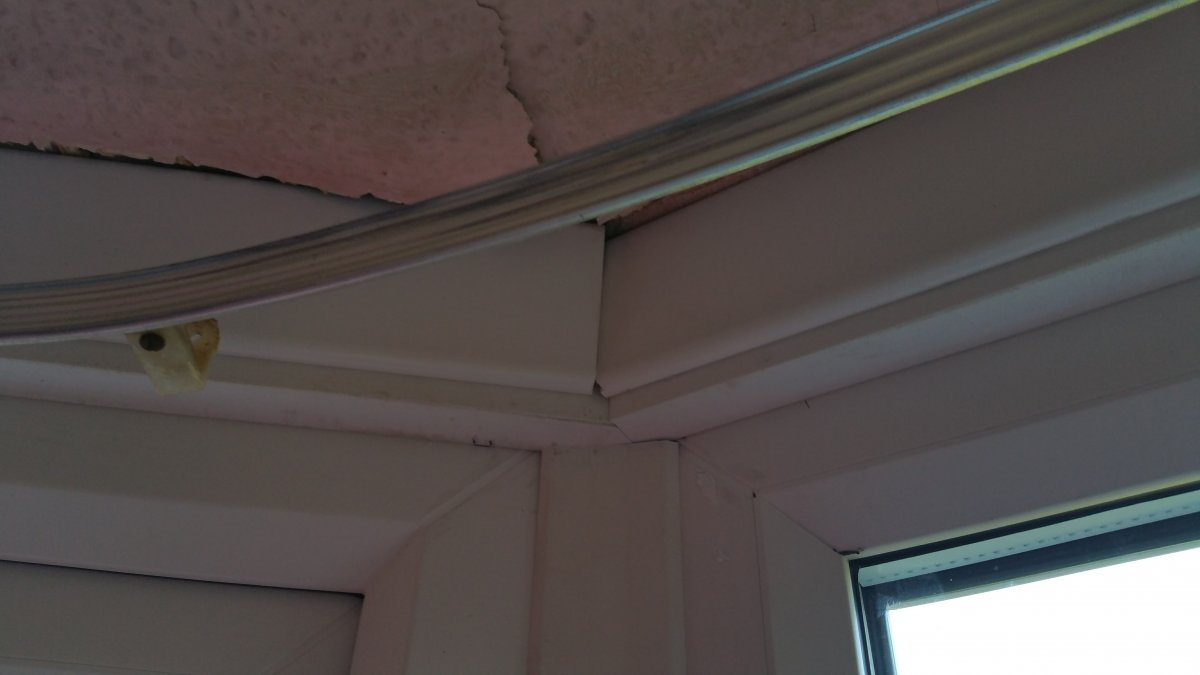

Bay Picture
is it normal to use a flat up / down trim to cover the 45 degree join where the two windows meet (from top to bottom of window)
is the join between the two horizontal trims OK.

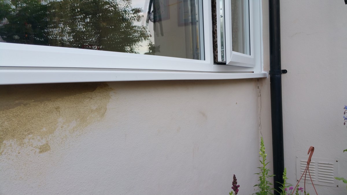

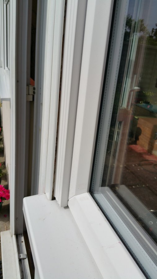

gap 1/2 pictures
I can see daylight through the gap, why is there a gap (looking closely the gap behind the trim is around 3cm wide, I can see a screw leaving the window frame, traveling through air and then into the frame on the other side.) gap 2 is the outside view.

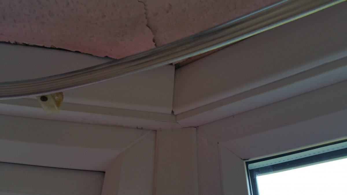

top picture
Is this join in the trim OK, most of the trim joins are like this.
Also most trims have scuffs and dents in them, the scuffs will not clean off when wiped. is this normal, does the installer have a special way to clean them up when he finishes.

The angles and cuts on the trims are pish poor finishing.
They obviously haven't used expanding foam to fill voids around the frames. No regulations to do that but is good practice in my opinion.
The inside of the baypoles would have been a much nicer finish with an adjustable angle trims.
It dosent matter how many guys there are as long as they do a good job but I wouldn't be happy with that.
Some small scuffs can be polished out with solvent or cream cleaner and some minor dents can be fixed with a hair drier or heat gun.
I would say let him finish but point out your concerns and be prepared to hold back some money until things are done to satisfaction.

No once they have cleaned and sealed everything it will most likely cover everything.
Unfortunately its all pretty standard for most windows company's. Its defiantly not great quality workmanship
One (hopefully) last thing. Why is there a gap, it seems a bit silly to go on about the glass being this thick and filled with this gas etc when around the windows is a gap ( even if it is filled with foam)

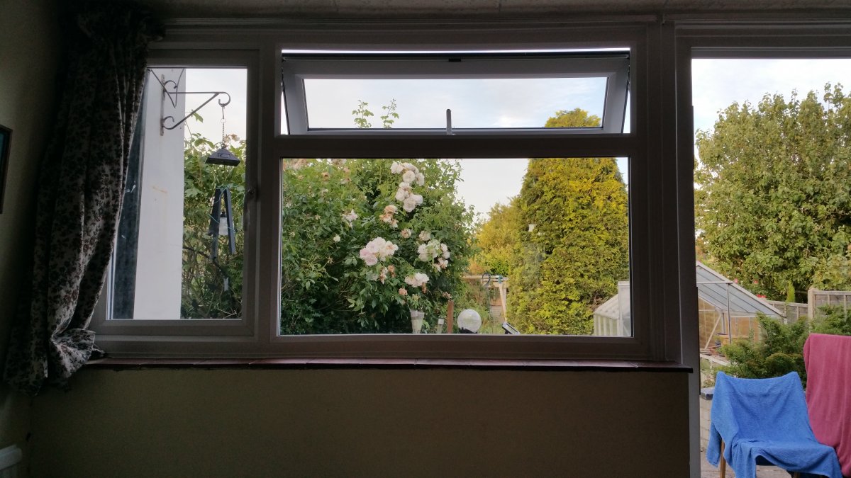

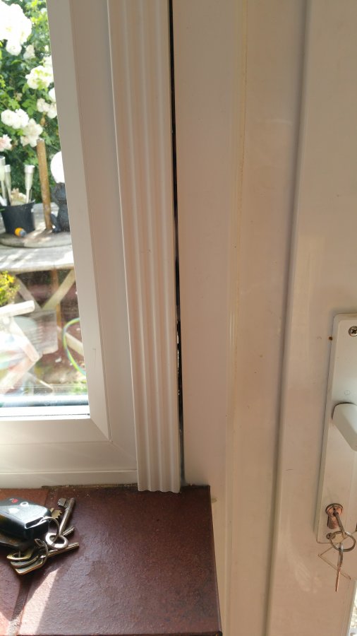

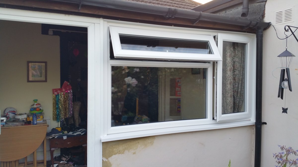

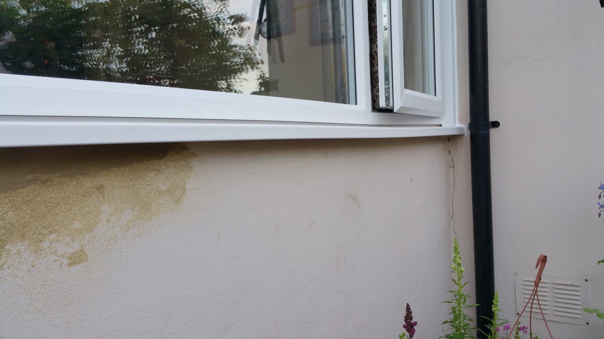

Hi all
Two of the windows have upward bows in the middle bottom frame. Can anyone see from the pictures below what is going on from these pics of one of the windows.
