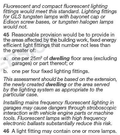

The Building Regulations don't have a Part L2, only a Part L, and this is what it says:
Also note that fitting standard lamp holders (BC etc) and putting in LEs is not permitted. TYhey have to be specific LE fittings that will only accept CFLs, etc.
Also note that it doesn't say that in the Building Regulations either.
You're quoting from Approved Document L2, which is not the law, only guidance, and which will say at the start something like
Approved Documents are intended to provide
guidance for some of the more common building
situations. However, there may well be alternative
ways of achieving compliance with the
requirements. Thus there is no obligation to
adopt any particular solution contained in an
Approved Document if you prefer to meet the
relevant requirement in some other way

Sorry. I was quoting from Part L1B (Existing Buildings).
You're right, Part L1A doesnt't have the weasly guidance wording at the beginning that L1B has
