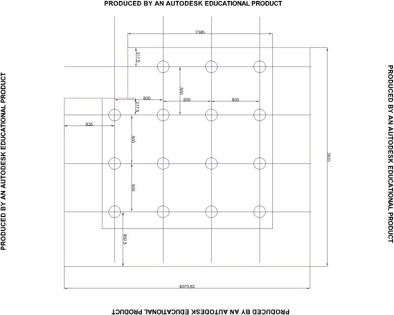

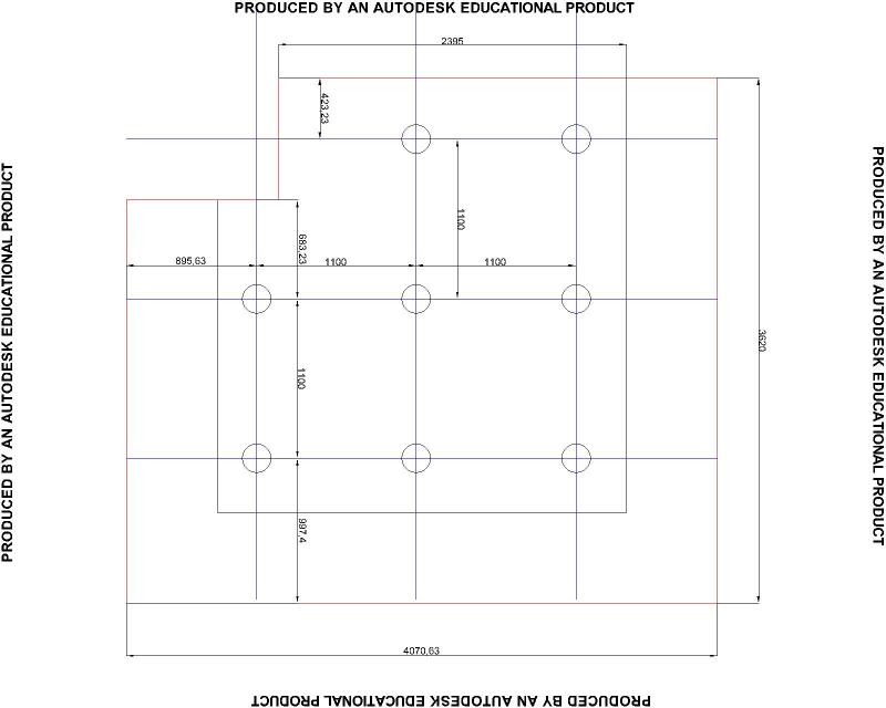

I'm wanting to add some downlights to a kitchen refurb in my house and have attached two PDFs of layouts I have put together. One of 15 lights and one of 8 lights.
I will be just prepping the ceiling, get holes in the right place and making it easy for the electrician to feed new cables to the lights.
Above kitchen is front bedroom.
Ceiling is plasterboard.(Whole kitchen to be replastered)
Kitchen is 16sqm
Redline is kitchen outline
Blue line is lighting grid
Circles are light positions. This is dependant on what I find regards to joist spacing, so could change.
Whitelines are limits of low level cupboards that are going on three walls.
Distances have been dimensioned.
I am wanting to stay with mains voltage lights as I don't want to get into transformers and the like. Will probably go for a fire rated 50w halogen GU10 model downlighter, and then possibly switch bulb over to a 7.5w LED GU10 when I can afford the lamps at a later date. So far have only looked at those from screwfixx. Any other model suggestions appreciated.
If someone could advise if the number of lights in which layout is sufficient it would be appreciated.

Number of lights will be more than enough.
Have you already got the lights? Which ones are you using?
There are some better ones out there for use in the kitchen, that don't let steam and cooking smells past them.

8 or 15?
I'm open to any suggestions for lights.

I take it those dimensions are millimeters, so 8 will do just fine.
Lighting is far from easy. Bouncing light off walls and ceilings can work well but clearly ceiling, walls, or even floor must be white. The 60's idea of white doors on every cupboard would work but most people today go for wood coloured doors so very much depend on colours used in the kitchen when you use spot lights bouncing light.
Using more general lighting like 2D you are not so restricted in what colours are used in the kitchen.
The problem today is CFL and LED are not very bright so we need a bigger spread of the light units. 9 arranged in group of 3 and 6 works very well giving three levels of lighting.
