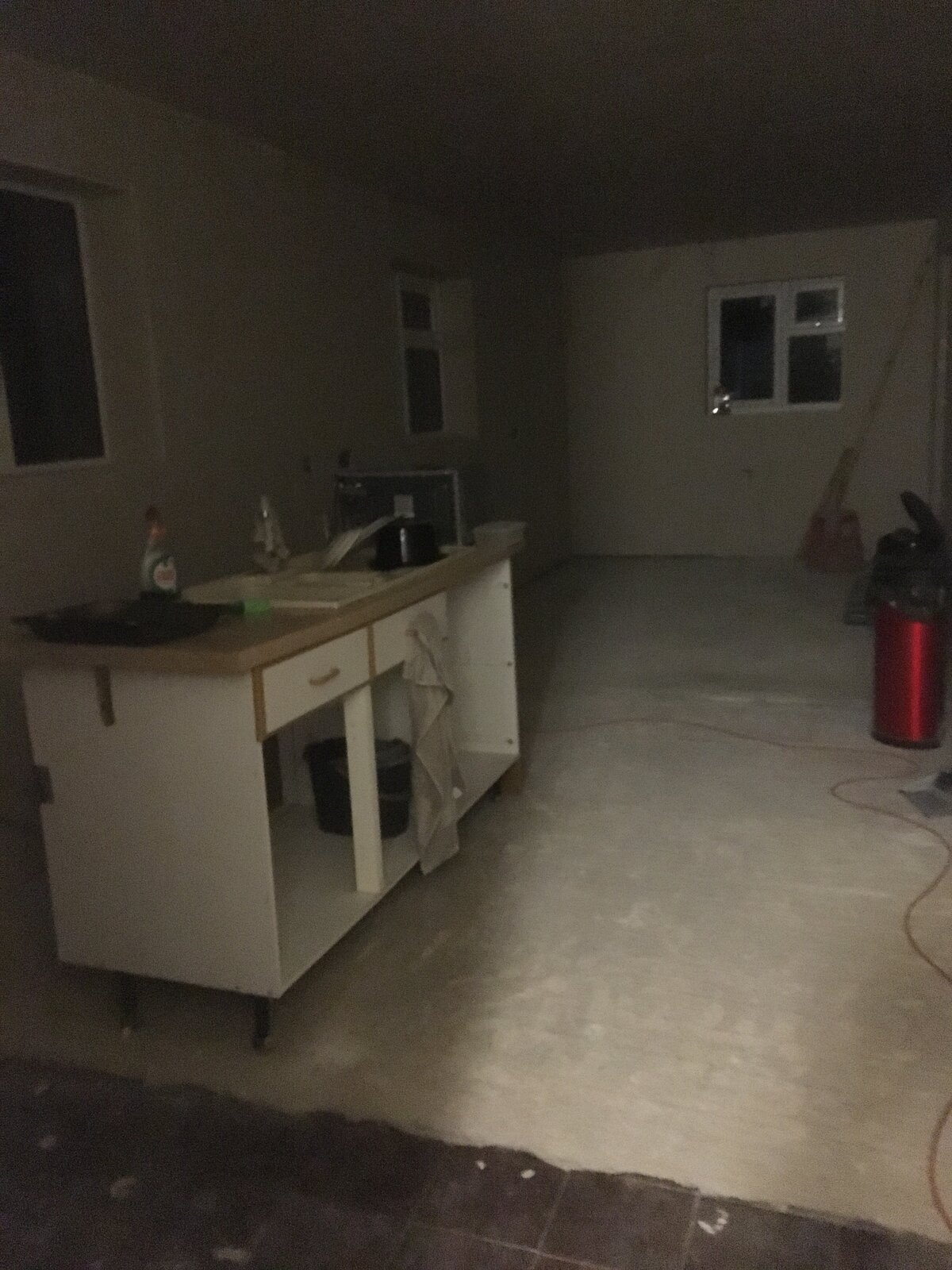

We managed for months whilst builders were in with a microwave, slow cooker and camping stove. Gas main had to be moved, kitchen extended and then rewired, plastered etc. Tiling was done half at a time so that cabinets could be accessed from tiles laid the day before.
As above, used old kitchen sink with a bucket under the drain pipe and fetched water from the bathroom
