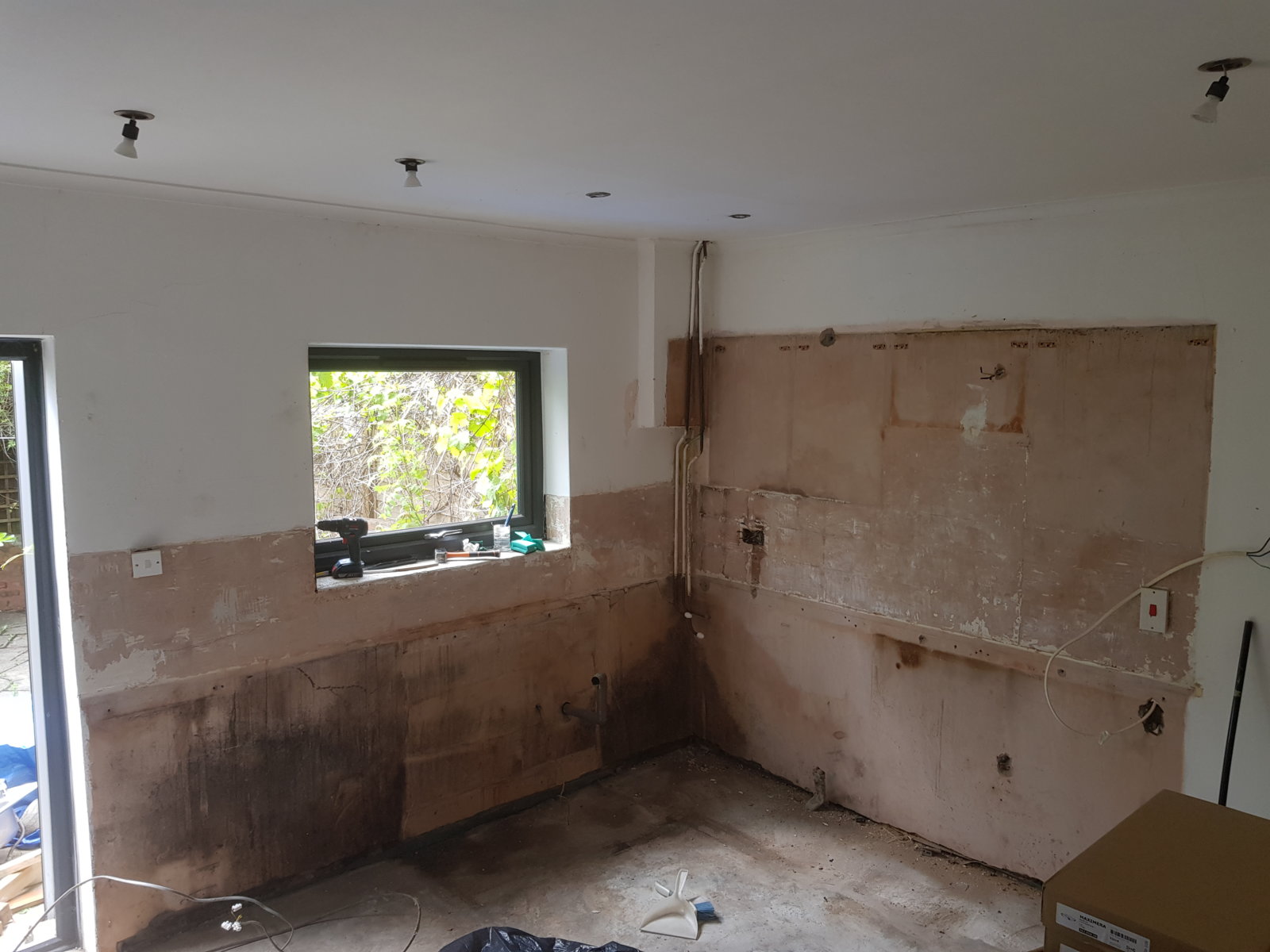

I've just ripped out my old kitchen and the new one has arrived flat packed. Sorry for any silly questions, I'm new to this!
I'm guessing it's standard practice to paint the walls first and touch up after?
What about the area I want tiled, I just leave the plaster as is there?
And finally, on the photo can you see the black areas low on the walls, in the corner etc. Any idea what this could be? Is it mold, if so, what's the best thing to do before I fit the kitchen?
Thanks very much
ok im a fitter by trade i always get the walls to the stage where they ready for there last coat as for the tile area don't paint this get it as flat as you can now then before tiles pva mix then tile and finally your top coat on the painting ps the ceiling can be fully finished before you start i would also treat that damp (bleach) the mould make sure you have a gap between the floor and plaster

Are those solid walls? If so, I'd think about insulating the walls behind the units. Might be tricky, losing some unit space, but will help prevent more mould forming. It will come back if there is no insulation in the walls, and it will cause problems. Might even be worth bleaching, hacking the plaster off, bleaching again, then insulating and boarding over, just to worktop height. Will help keep the room warmer too. But if not a solid wall, ignore me and just bleach it.
mold wont die with anything like bleach ect it just takes the edge off it it in beds in the plaster there are so many reasons why we get mould if both walls in the picture are external then yes it may well be insulation thats caused it it could also be you need ventilation

I just had a builder round for other reasons. He said it could well just be a tiny leak from the pipes, as it's only in the corner below the pipes. The other black area is directly behind the washing machine. This kitchen hasn't been changed for 25 years or more.
They are solid walls, it's a Victorian mid terrace house.
Insulating behind is not really possible, it's an IKEA kitchen, there's no space at the back, and I have the worktops so can't really bring it out further
the mountain-shaped dark patch in the corner is damp. I see some pipes there. Most likely you have, or had, a leak. It is essential to repair this and let the damp patch dry out before painting or tiling. If you have a concrete floor, the leak may be from a pipe in the floor. If a wooden floor, lift some boards and look underneath.
The black mark to the left of the window looks to me like it might be dirt. Try scrubbing it. A fridge or oven can cause this due to the warmed air currents. Oven dirt is often greasy.

Well, I'd def. look at adding some insulation, even if only 20mm kingspan glued on the wall. It's a kitchen and those walls will be cold, so just as likely condensation as leaky pipes.
lag the pipes just to rule out condensation on the pipes its cheap enough

Thanks, great advice. I'm pretty certain it hasn't been wallpapered. I have some cheap white emulsion, so I can use this for a mist coat. Do you actually have to spray it on somehow, or can you just water down the emulsion and brush it on?
Also, I have those black areas as mentioned before, which appear to be mould, possibly from the washing machine and from the pipes in the corner. Any ideas what to do about this. I have some paint that is meant to seal mouldy patches so they dont she through, but maybe its not a good idea to seal it in. Its an old victorian house
thanks agin for all the help
big brush or roller, thinned with water. Like milk. the first coat should practically disappear as it soaks in. I like to apply a second coat but some disagree.
I'd scrub the black patches with sugar soap and rub off with an old towel until the wall looks clean.
