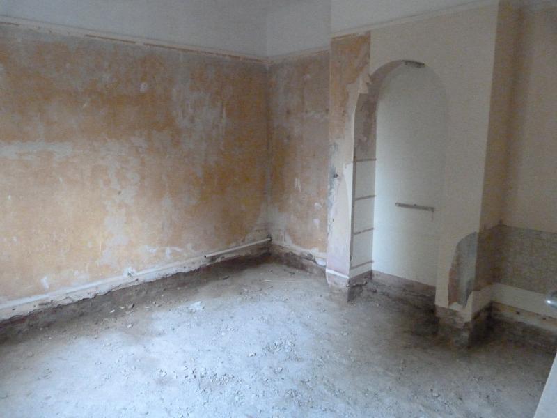

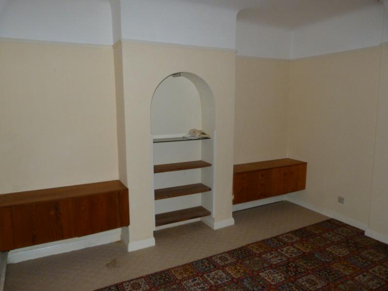

It been a while since we started our project. I have found out so much from this site I thought I'd share some pictures of the work we are doing, starting with the kitchen but we are doing similar in the whole house.
This is a DIY job but we do get people in for certain trades where it is simply not cost effective to do it ourselves or requires a particular skill.
My wife and I both work full time so it is taking a while.
The new kitchen is going where the dining room used to be, the house certainly was in need of modernisation.
We removed all the wallpaper. We didn't originally plan it but the concrete floor was not in great condition so we took the opportunity to get someone to dig it up as we did the whole 65sqm ground floor.

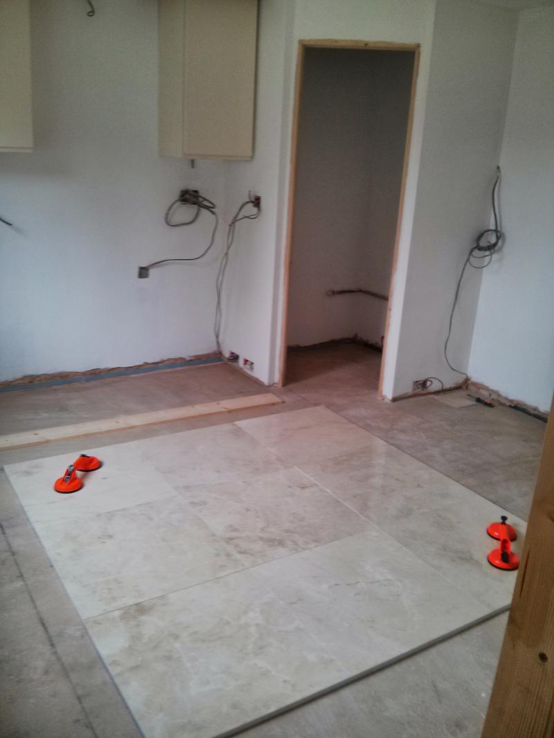

We got an electrician in and then plaster boarded ready for plastering.
Plasterer came in and skimmed the whole room.
Room painted and starting the tiled floor, I am glad the screed was done well and level.
Fitted the kitchen and electrician has finished the lights.
Just need a worktop, doors and finish off the plumbing and this room is nearly done.
