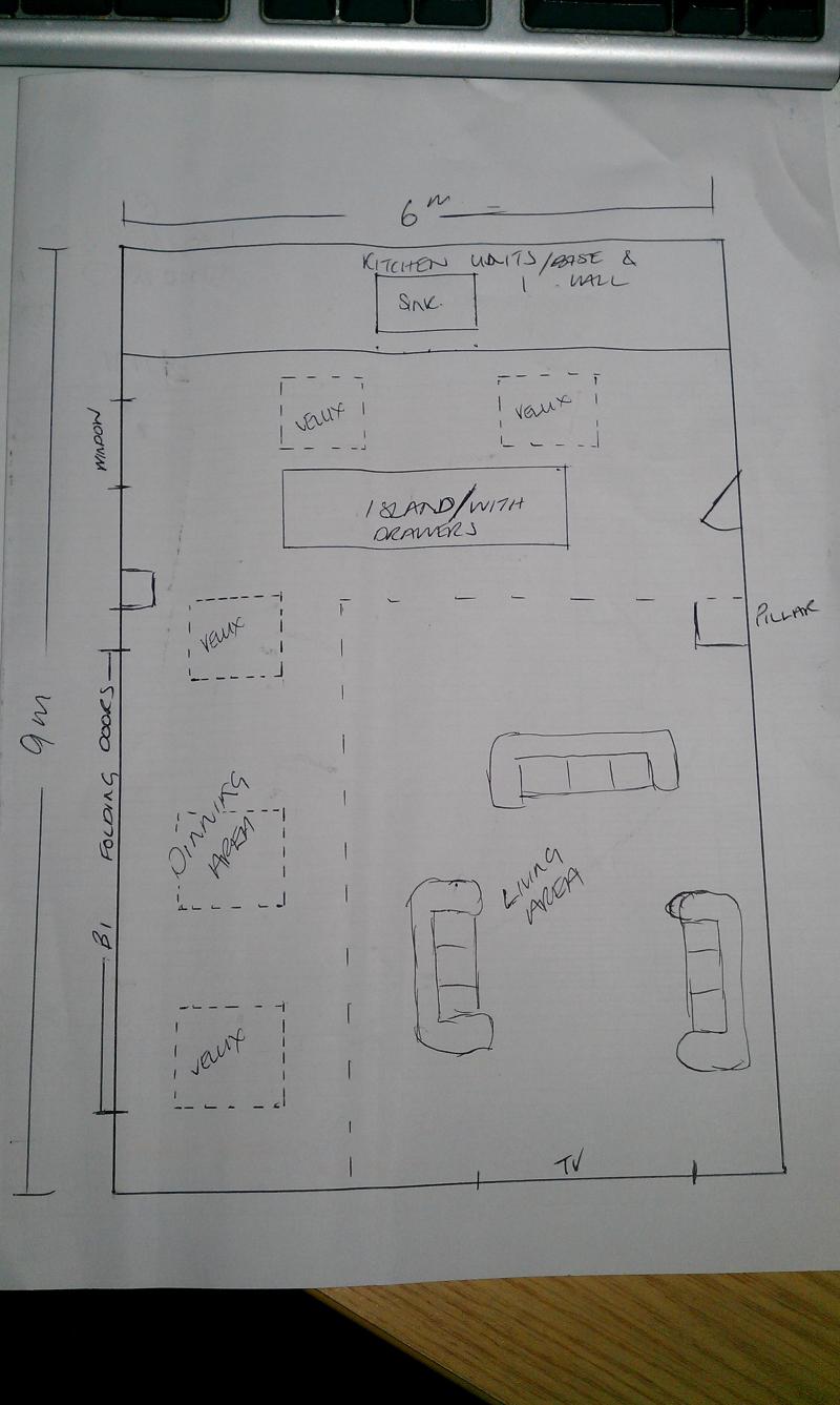

Afternoon all,
Need some guidance (comments/likes/dis likes/web links etc) on buying new led spots for my kitchen/diner/living room. I want to stage it in three areas 1) Living area (8 Led dimmables) Dinning area (6 Led non dimmable) Kitchen area (8 Led non dimmable).
In the dinning area and the kitchen area where the leds will be mounted there is a vaulted ceiling which will be made up of 50ml gap from roof tile/breathable layer to 100ml Kingspan, then 18ml ply to 2.5ml firesafe plaster board and a plaster skim.
In the living area the ceiling will be 100/200ml insulation between floorboards and plasterboard, 12.5ml fireboard and then skimmed.
What i am looking for is info on dimmable leds and leds that can go in to vaulted ceiling and living area ceiling.
I know i will have to cut around the kingspan to put in the lights but i would like to know peoples recommendations on which leds are best for this installation and a guide on price as i dont want to have them blowing if they overheat if i get the wrong type which ive heard happends.
Cheers in advance for any advice by the way!!

What is the point of all that insulation that is put there to achieve the required thermal insulation characteristics if you are going to cut it all away and lose all those expensive BTUs through the spotlights?
Also, don't forget the kitchen moist air will be drawn into the vaulted ceiling void causing damp and rotting roof timbers.

Yes, they said it would be ok BUT the lights would have to be fire rated and be either with a cover on them or i could buy a covers that goes over them.
They said it would be OK to compromise the insulation?
Why?
And you will seal those covers to a surface on the warm side of the vapour barrier, on order to stop warm moist air getting to the cold side where it will condense and start to rot the roof, how, exactly?

Sorry guys!!! I spoke to the BCO this morning after your comments and asked him to explain the lighting situ. I had heard the BCO wrong when he was at my house. The spots in vaulted ceiling do NOT need to be firerated just leds, the firerated ones he was talking about where for the ceiling in the living area which has the bathroom and bedroom above :oops:

Ever heard of fire rated and thermal rated downlights? Plus IP rated to stop the moisture from going through.
I dispair reading your posts.
I plan on fitting MR16 LED lights into a loft conversion due to the hight and will have to cut away tje insulation. I also had to do this in my kitchen extension roof around my veluxes and it hasn't effected the heat loss.
