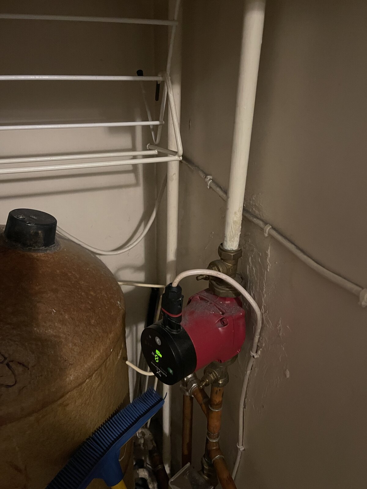

Hi guys, very basic plumber here (not my day job)! I'm looking to install an inline shower pump booster as my gravity fed shower is absolutely terrible.

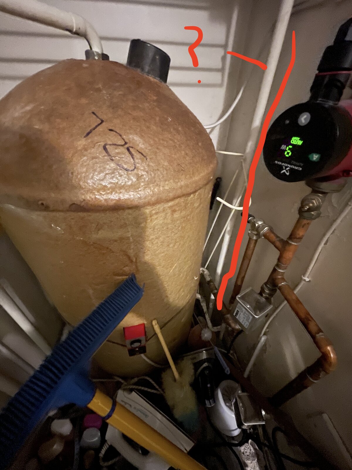

I'm struggling to identify which pipe to install it, i've attached 2 pics, it looks like an open vented system so i'm thinking the pump installs on the downward of the pipe that splits coming from the top of the tank, but i'm then confused as there is a straight pipe with no connection in the airing cupboard that is red hot also, can anyone identify what this one could be? And confirm i'm going to install in the correct position identified!
Thanks in advance

Just the shower for now, though there is no other place to fit the pump other than in the airing cupboard, i'm guessing the pipe that is hot on the right hand side could be the one that goes over to the shower

Can't see enough of your pipework to determine what the right hand pipe is. If you fit it on the left hand pipe you indicate ,that will boost all hot taps

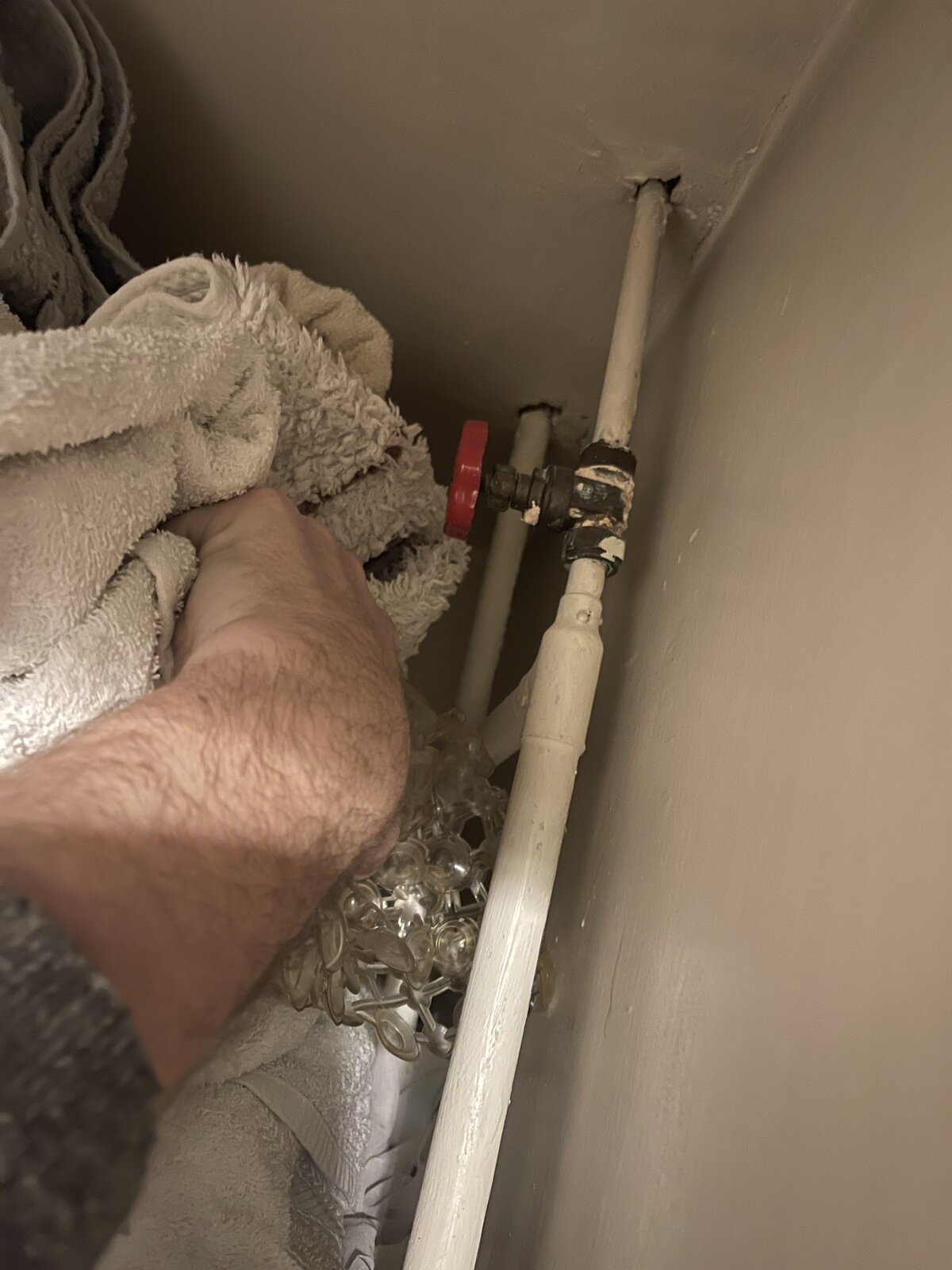

Thanks bud, it's just a straight pipe up into the roof space, coming up from below the airing cupboard, i suspect it goes directly to the shower given where the shower is
I very much doubt it Jamie ,that's highly unlikely. Run your shower and see if that pipe gets hot.
You are correct, this is for the heating system by the looks as theres a ball valve above. So I guess the only place i can install the pump is on the down pipe out of the hot water cylinder which is fine. Thanks all for the help.
