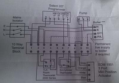

Hi
I need to replace the mid-position valve in my Honeywell Y-plan system. After reading up a bit I saw someone selling Sunvic drop-in replacement MOMO valves (SDMV2304) on ebay for a price close enough to the spring-return and I like the idea of MOMO and the manual dial so I decided to try it out and see.
Anyway, the valve arrived and before I fit it I tried turning the manual dial on the front; it will only turn in one direction and even in that direction it doesn't turn far enough to close the valve anyway.
Would you expect this or should I be able to turn the dial in both directions, closing the valve, while it's all disconnected?
For what it's worth the valve itself will turn (and close) freely in both directions if I take off the head.
I suppose I could fit it and find out - replacing the head is the easy part of the job so if the worst came to the worst I could replace that later - but I thought it might be worth checking here first :)
Cheers
Geoff

No it won't. The wiring is the same as for a 4073, unless Sunvic are lying. As you see here,
(Apologies for the poor quality, I took a photo with my phone)
it's the same as the one shown in this post
the wiring for a momo valve is NOT the same as for a spring return. A momo valve needs a heating off live , a spring return needs a hot water off live. Looking at that diagram it would suggest otherwise :confused:
So are you saying the diagram I've posted (the one that comes in the box!) suggests that it is a drop-in replacement? I did research this before I bought it because I had no intention of making significant wiring changes to the system, and that is the claim they make.

the diagram is the same as a spring return yes
Great! So, having cleared that up, can we now get to the original question? :)
Do we think the manual wheel should fully close the valve in both directions when everything's disconnected? Or should I just connect it up and see if it works?!
just connect it up and see if it works, if the wiring diagram is correct it will work. Manual positions on valves usually and deliberately put the valve into mid-position.
Mmm; maybe I'd misunderstood and the manual override is only meant to enable you to return the valve to open.
Like I said before, if it's broken I can always replace just the actuator unit.
Thanks all for your posts.
