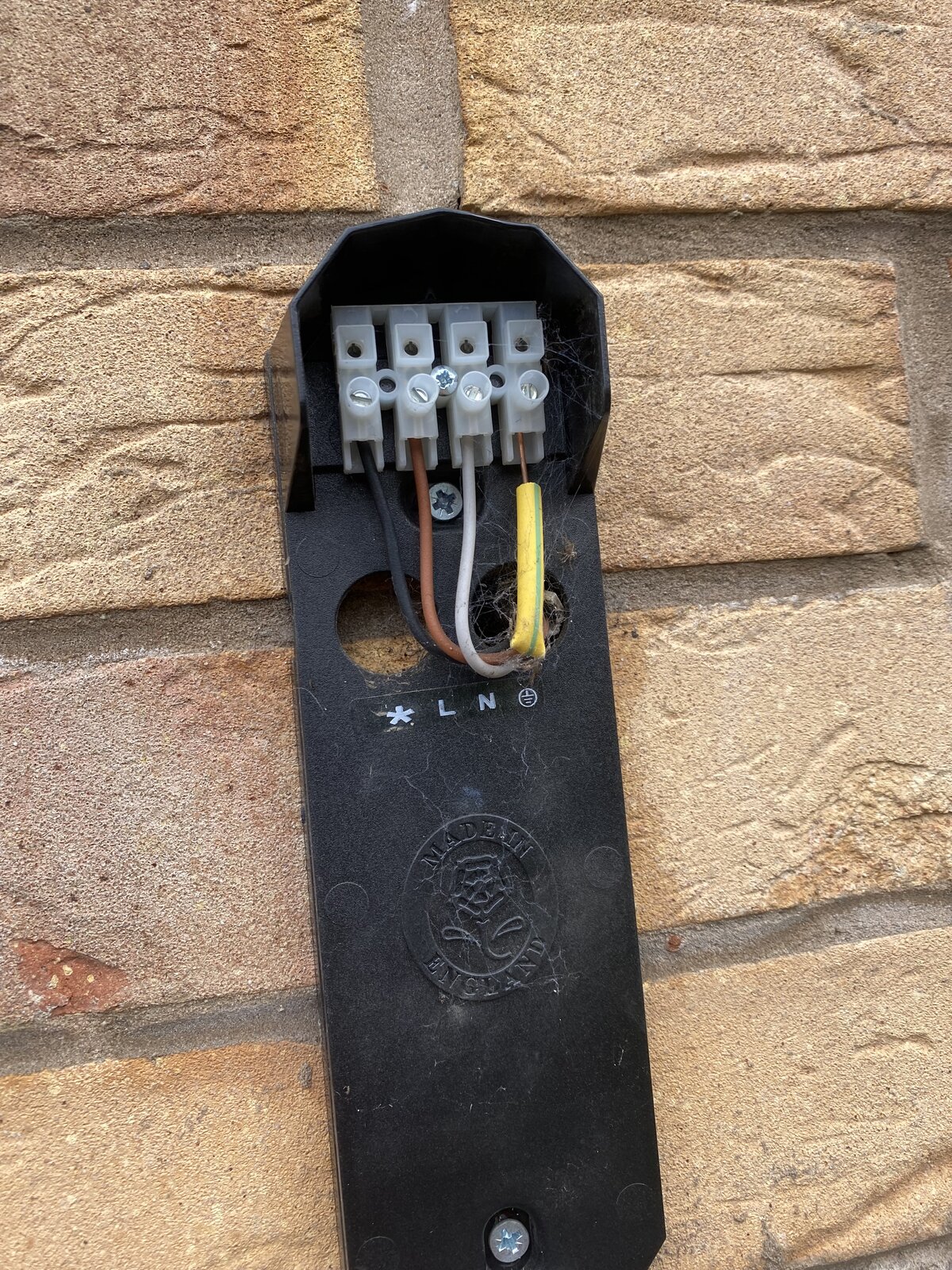

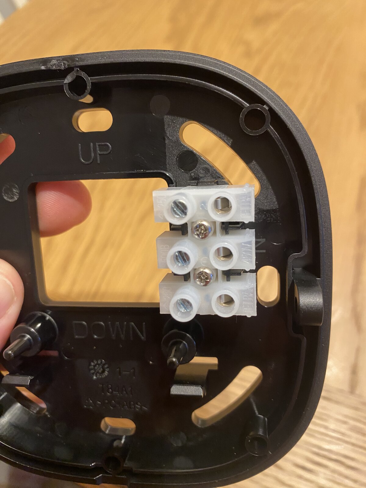

Hello, would appreciate some advice.
I currently have an outdoor lantern PIR lamp wired to the house that can be controlled by either the PIR or by a switch in the hallway. I wish to change this for a new outdoor light with camera from Eufy (S100)
I have taken the current light off and it is wired by 3 core and earth (picture below). My new fitting looks like it is for two core, and has three terminals for live, neutral and earth (picture attached).
Please can I have some advice how to proceed? I’m not fussed about having the ability to switch the fitting off - I would prefer continuous power actually with it being a camera too.
Thanks in advance
Connect the permanent live,the neutral,and the earth conductor to your new fitting. Put the switched live into an insulated terminal block that can sit loosely inside your new fitting.
