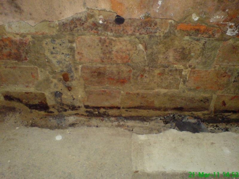

I live in a bungalow built with solid 9 inch walls and because of this, I have condensation problems. This is made worse though by a bit of rising damp in various places. [A previous owner took up the wooden suspended floors and filled with concrete, bridging the damp course in many places and encasing the central heating pipes]. I want to insulate and dry-line the walls but before I do I want to replace the physical damp course.
I know this is a trial but I prefer to do this than inject or cream. The trouble is, I have only found one site that explains the process but not in full detail.
I intend to use a concrete chainsaw to remove the old damp course, a metre a time, and use a good quality DPM then slate wedges and mortar to refill. Has anyone any thoughts?
I can't afford to get this done by a professional.

Are you sure that you have rising damp? All of your problems could be down to condensation.
Any chance of a picture or three?

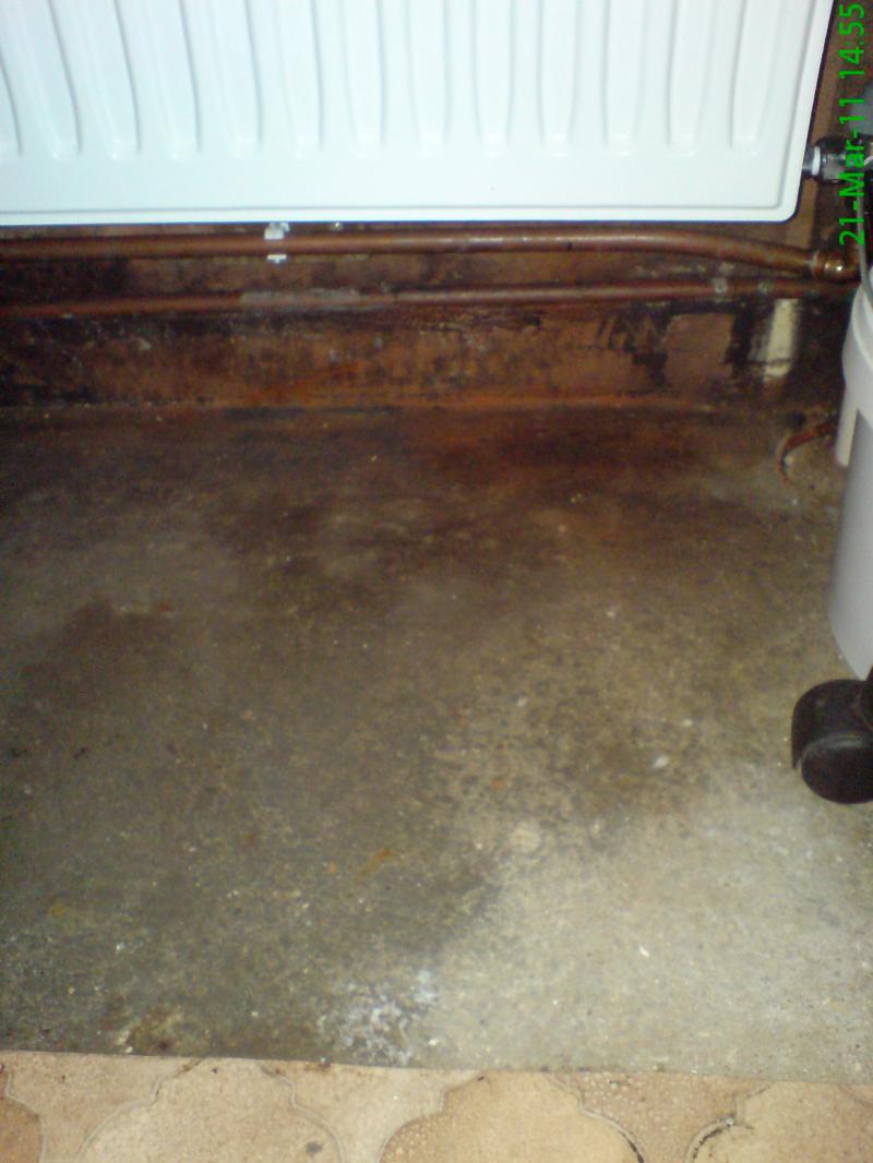

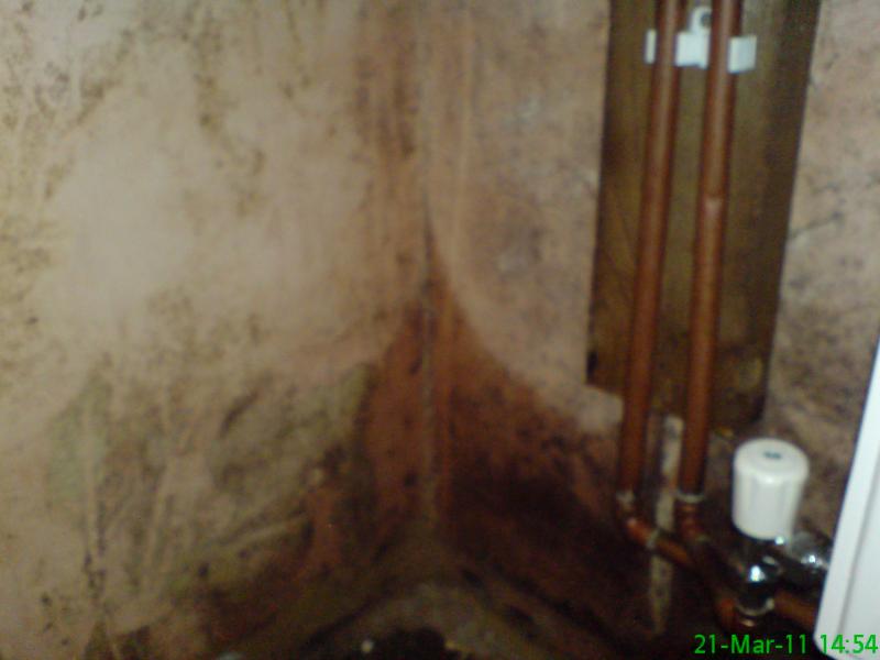

'Damp' kitchen wall
Damp wall/floor
The lower black line is the pitch DPM. As you can see, the screed here caused a bridge.
The damp line rose to just under a metre but is now reducing in
height to approx 600mm over the past two weeks.
the pictures look to me like wet from the floor, not condensation. However moisture will evaporate from a wet floor and cause the house to be humid, which will lead to condensation.
It is a pity the floor is so wet. I imagine it was poured with no dpm, as it looks such a shoddy job. It would be very tiresome to break it up and dig it out, but might be worth a trial hole in case you are lucky, and the concrete is such poor quality, or so thin over rubble, that it is easy to dig out
Unfortunately concrete which is kept damp for a long period cures very thoroughly, and reaches a hight state of hardness and strength.
If he left plaster rubble or wood rubbish under the floor, it may bulge and crack or promote rot :cry:

With no adequate ventilation the damp is almost certainly down to condensation.Kitchen requires a permanently open vent plus mechanical extraction when cooking.Do you dry washing indoors?
Hi foxhole,
We dry washing outside if poss but over the winter it is dried in the bathroom where the dehumidifier is always sited. Damp towels after showers are also dried in the bathroom.
I know we do have quite a serious condensation issue but along side this seems to be what appears to be rising damp???. The affected walls clearly show the wet demarkation line travelling up or down the wall. The problem seems to be worse in the kitchen and also in the bedroom diagonally opposite, so one room front right and the other room back left so to speak. Interestingly, the downpipe from both gutters enters the ground on the outside of both these walls and I need to make sure that the rainwater is piped away from the building and not just sitting under the ground. This is why I have said I intend to install a French Drain in any case.
As I have said, we do not have heating in all rooms at all times for the moment until I have completed the heating install.
Regards,
Volvomanx
Condensation will produce the damp you have , dehumidifier will not cope with moisture content you are producing, no such thing as rising damp[moisture falls thru walls until base is saturated hence the low damp.].You need lots of ventilation to solve your problems.

I guess with all the above views and advice I will forget about the rising damp theory and go with trying to alleviate the condensation.
Thanks everybody for your input.
