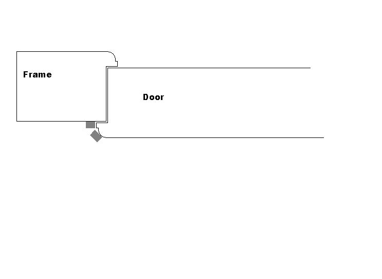

They all seem to have a quadrant moulding edge that you can't fit a contact to. Other than using a PIR - how are you guys getting around it?
Last few I have done I have managed to get a surface contact within the channeling (top or side), if you see what I mean, there is quite a lot of room.So you see nothing when the door is shut.If room is tight I remove the magnet from its box , and glue it.
stick it on with blutac first and with heavy duty contacts it usullly works (which is where the blutac comes in, you can move it to make sure it works before you drill the door)
Have you actually seen the new doors? Saw 3 last week and all had about 5mm on the extreme edge - not like the square edge of a few years ago or even the angled bevel. No room to drill.
i confess , i have not seen the latest doors, but with any pvc door i always try it first, using hevy duty contacts means i can put the magnet further away from the outside edge
I've fitted the magnet part on the rounded bit of the door, and the reed part on the frame so they sort of over lap each other.
I'll do a drawing, that would be easier.
Will the customer accept it? Spending a grand on a door and then having something stuck on the moulding? I charge them £20 for a PIR and they seem well happy.
