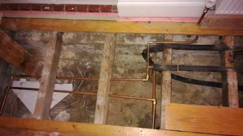

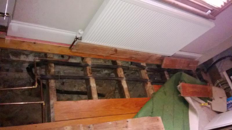

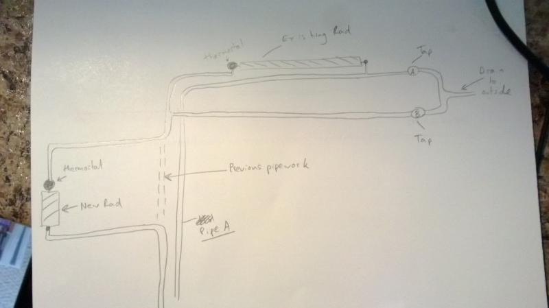

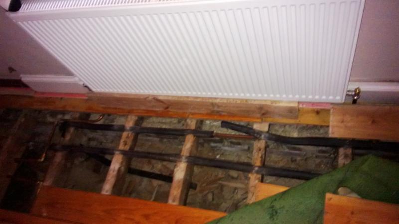

Attached (hopefully) are pics of the pipework for existing radiator as well as sketch of how things are.
Hopefully it all makes sense. Have I done something fundamentally wrong with the way the pipes are?
To reiterate what I've said before, all other rads in house still get hot then heating is on. However the rad in the pics and new one do not at all, and in fact pipe A (on diagram) doesn't get hot at all
UNLESS... If I open tap B (which drains the water in the system to the outside) then the existing rad gets instantly hot! I don't know if the new one that I put on will as well because the system drains pretty quickly.
Any ideas as to why I am a muppet and it isn't working?
If I understand your diagram you haven't teed into the flow and return, you have diverted the flow through the new rad so that and the old rad are now in series.
You should have teed the existing flow to one side of the rad, not removed any pipework, and teed the return to the other. No choice but to redo the pipework. You need the flow pipe to connect to the TRVs on both rads and the return to the lockshields.

Do you mean where I've drawn the dashes showing 'removed pipework' that should be put back in, with a tee put in it? and then a little further along another tee with the return coming back into it?
As it stands it seems that the flow pipe for the rad that was already there does into the lockshield and not the TRV. Does this change how I need to do things? If that makes sense........
I'm happy to redo but want to be sure so I don't balls it up again! : )

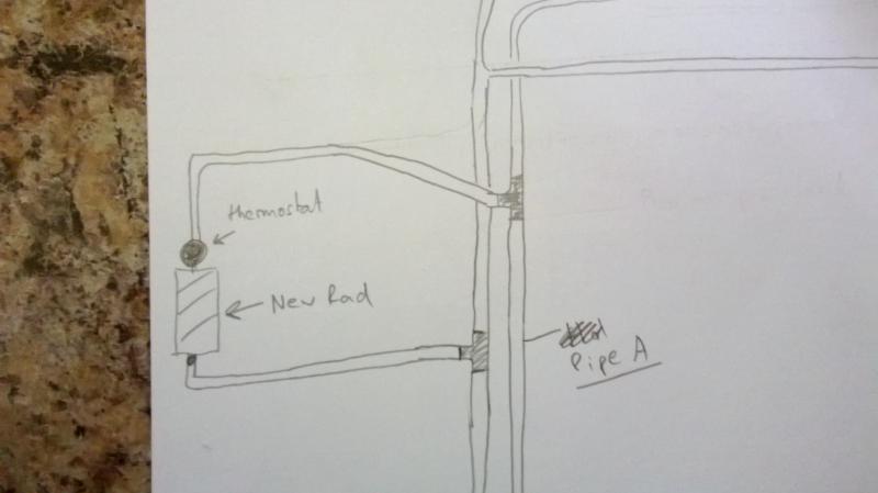

Is this diagram more what it should look like?
Exactly as your new diagram shows, yes. The TRVs would normally be found on the flow pipes but it depends if they are bi-directional, in which case it matters less provided they are set up appropriately. One direction TRVs can cause problems if fitted on the incorrect side. Are they new, in which case almost certainly bi-directional and the fitting instructions will tell you how to set up?
Re-pipe to your new diagram and you should be good to go. :)
