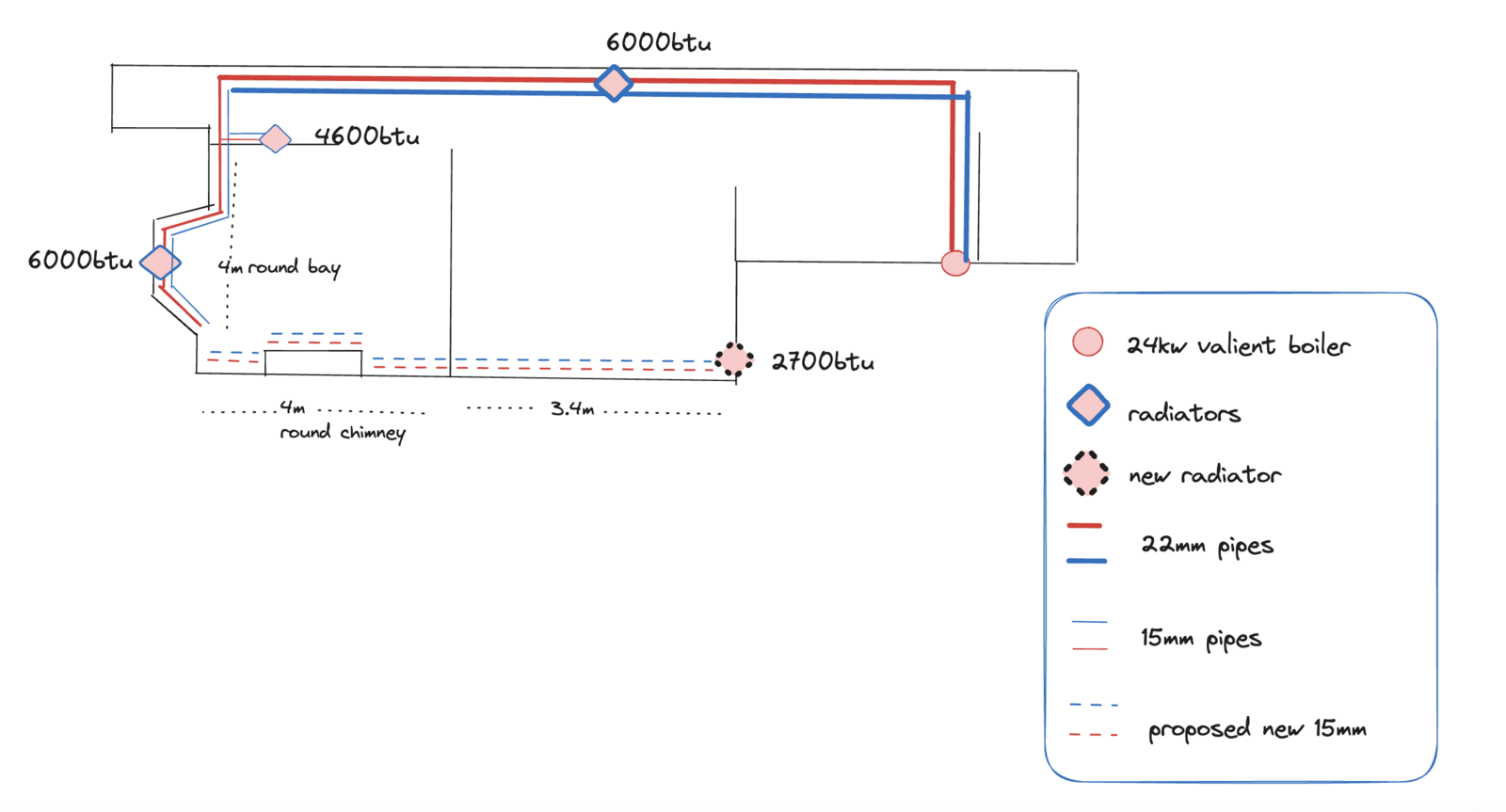

Ive read a few posts about this and it seems mixed so im just reaching out to see, drawing of it all attached,
Im wanting to add a new 2700btu vertical radiator in the living room to help keep it a bit warmer by extending the pipes from a radiator in the bedroom around to the living room.
The hallway has one radiator and all the pipes running from the boiler on that side are 22mm, when the pipes go under the floorboards they switch to 15mm i imagine to save cutting a wider hole for 22m into the slab.
I need to run about 7.4 m from the bedroom radiator to the living room either boxed in or chased into the wall new pipes to make this work.
But i know that 15mm can only handle about 4kw which im pretty close to as the 15mm circuit already has ~3.1 kw on it from the 2 radiators.. 6000btu ish and a 4700 btu
Wanting to find out what people think if it would even work extending the 15mm pipes that far and adding a new 0.7kw (2700btu) ?

The front room radiator is a small single pannel which has been bent to the bay window so its flow is reducded a bit
Uploaded a drawing kinda showing the plan and layout of the pipes, most of the pipes are external or boxed in expect where it crosses under the hallway which is under boards with no access
