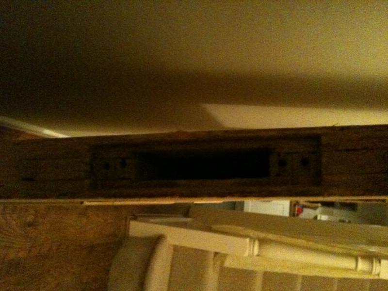

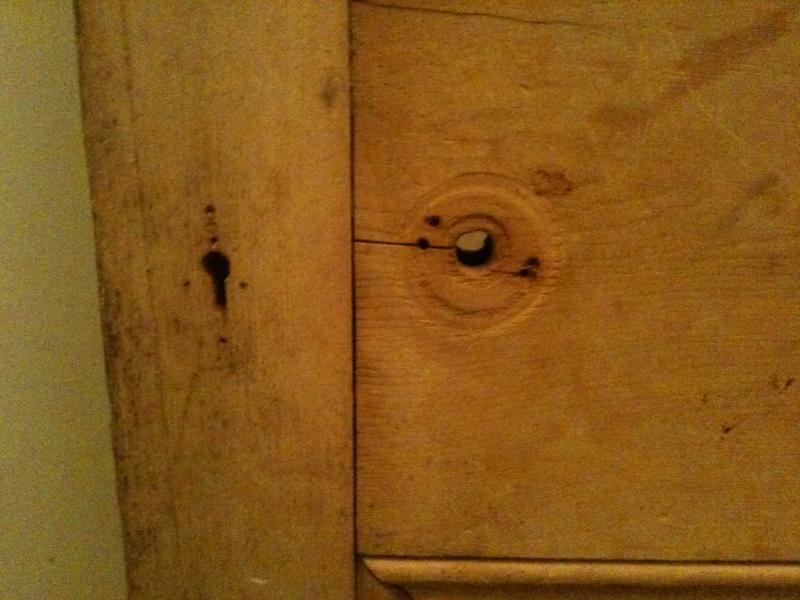

I have hung a number of reclaimed victorian 4 panel doors but they do not have any catch/lock mechanisms in them.
Most have a rectangular hole in the side with a key hole approx 4 cm from the door edge and door handle hole apporx 14cm from the door edge. When i went to B and Q they do not have any lock mechanisms that are even close to these measurements. Are these standard sizes? Is it possible to get new/reclaimed lock mechanisms i can fit in these doors?

Try a local locksmiths and ask for mortise sash locks.
Exact dimensions and pictures would assist.
Hi,
Here are pictures of the door in question.
Exact measurements are:
Edge of door to key hole 4cm (1 1/2'')
Edge of door to handle hole 13cm (5'')
Deep rectangualr hole for mechanism 3/4'' (1.6cm) by 3'' (7.5cm)
Recess for end of mechanism 1'' (2.5cm) by 5'' (12.6cm)
Thanks for any help.
Thanks, that looks like its exactly what i'm after.
