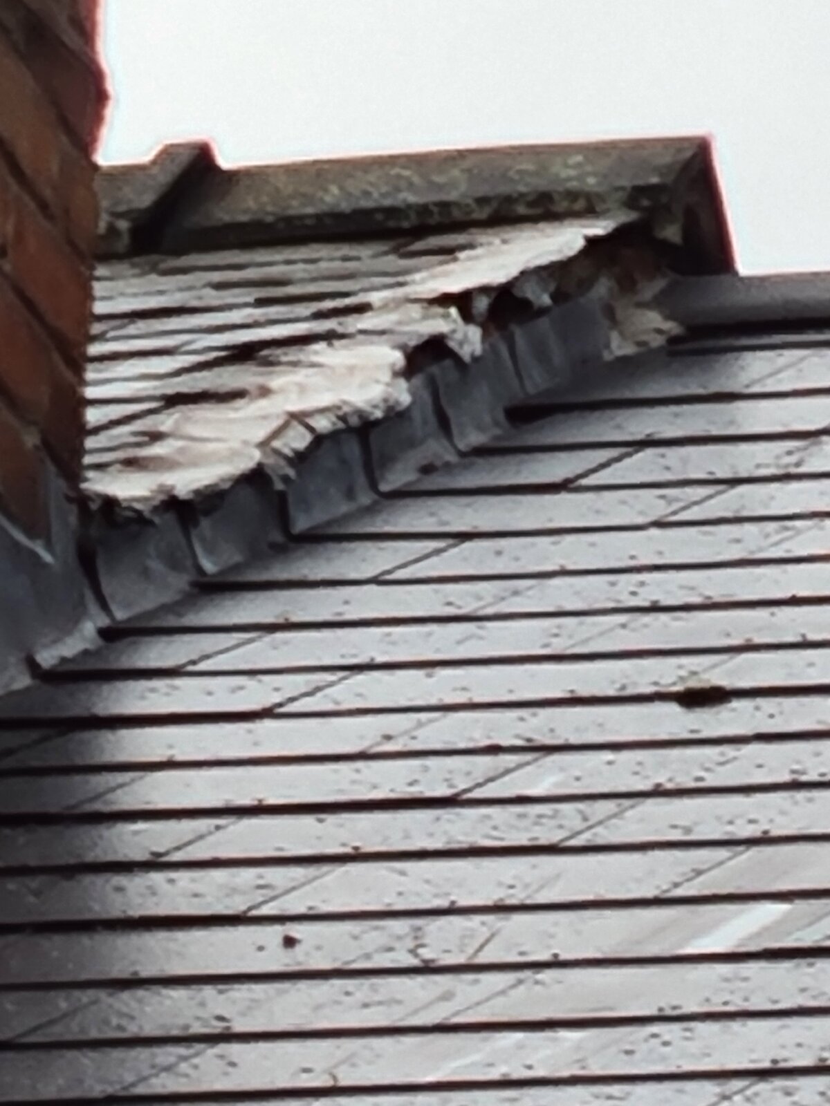

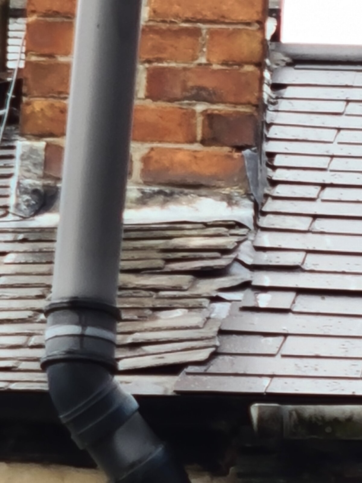

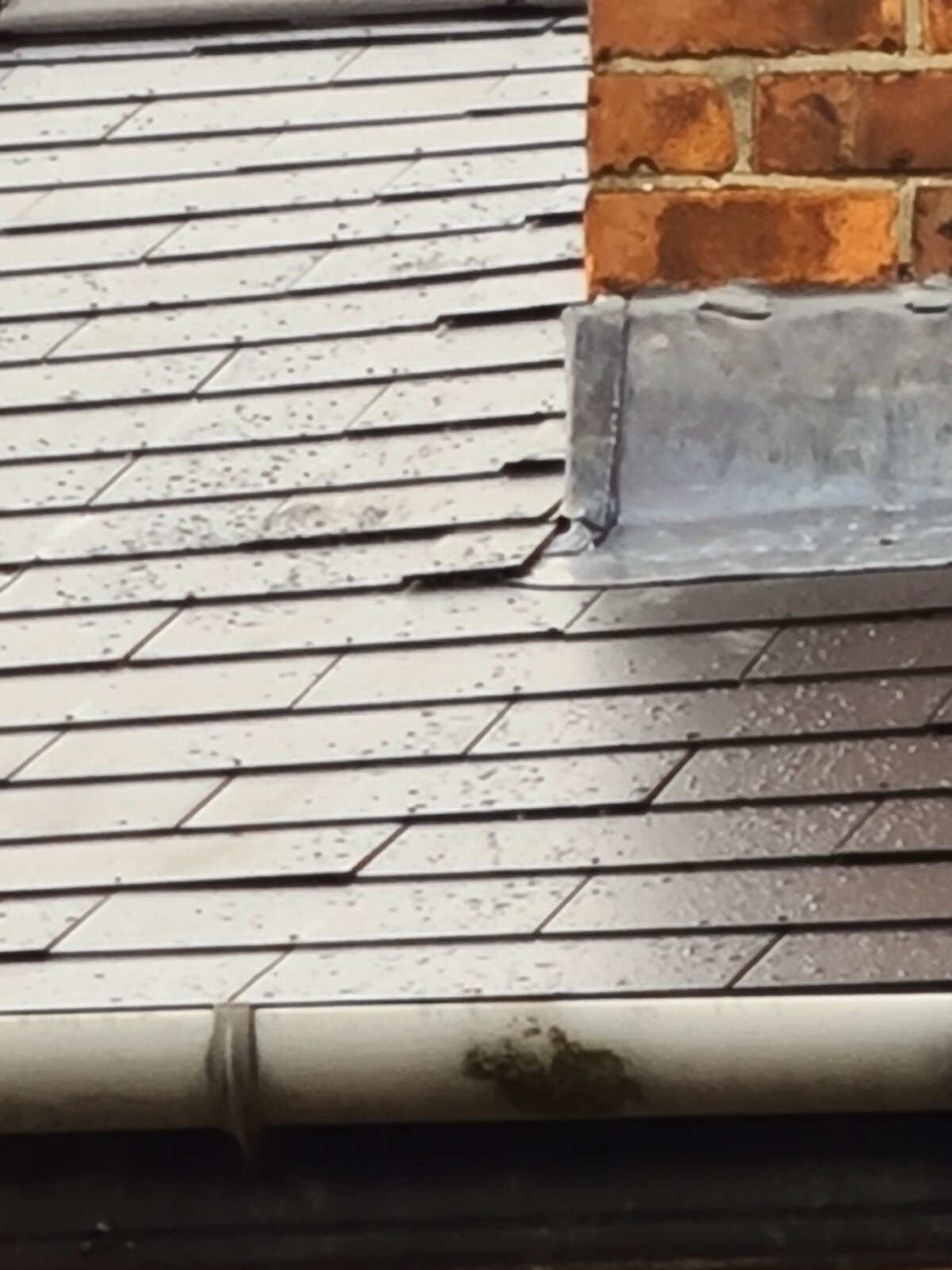

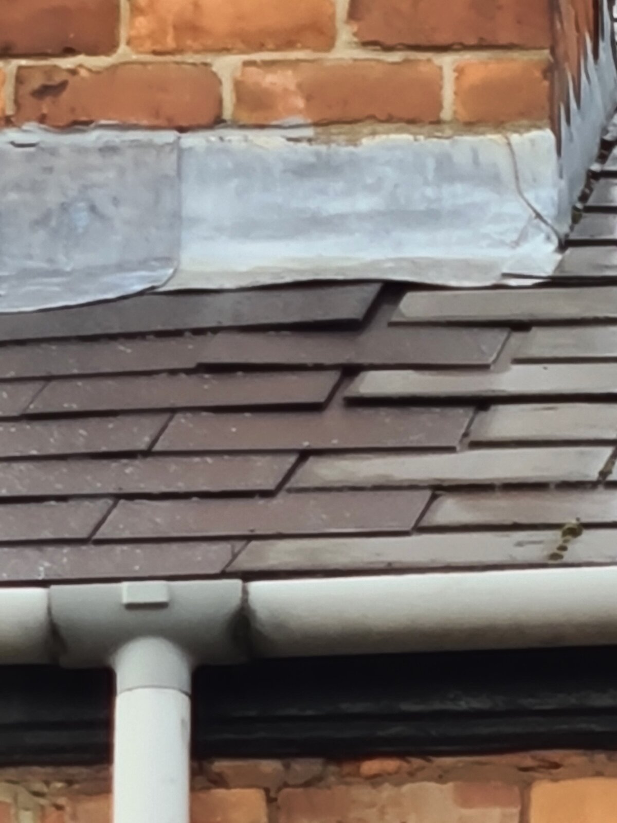

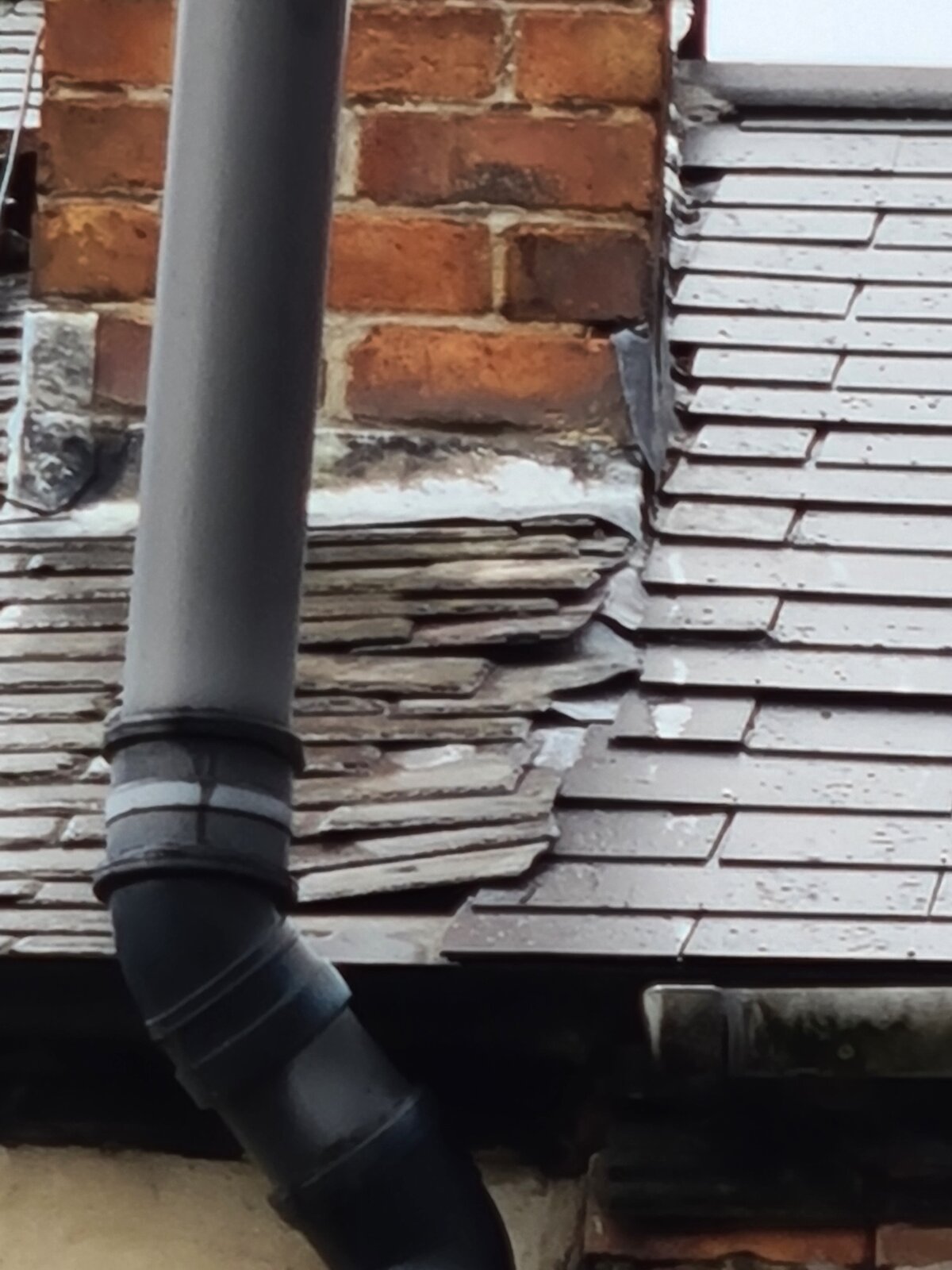

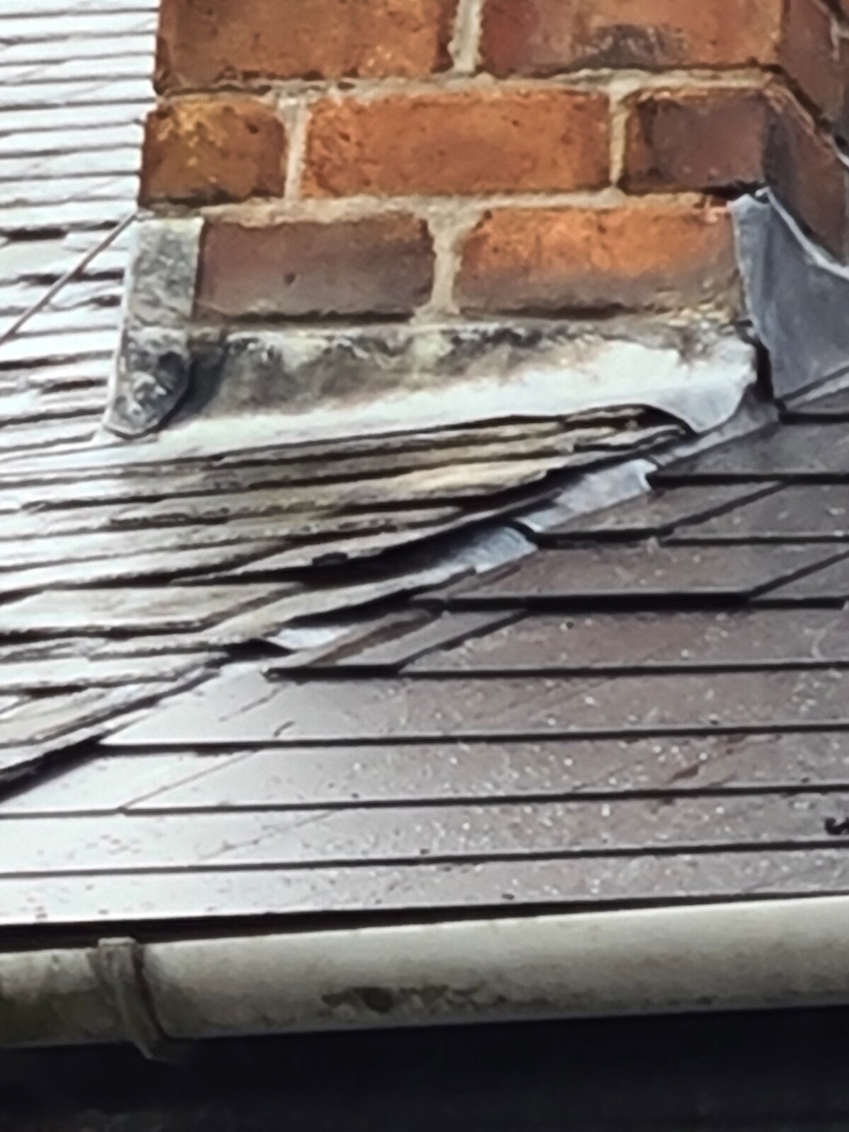

Hi All,
We are in the process of having a new roof fitted. Sadly the work does not look right, we have not paid yet and the roofer came back and says that due to the diff heights of the neighbours roof; the best he could do was to add some silicone under the tiles. Should he have used bonding gutters 20220214_144801.jpg 20220214_144810.jpg 20220214_144815.jpg 20220214_144815.jpg 20220214_144821.jpg 20220214_144821.jpg 20220214_144821.jpg 20220214_144821.jpg 20220214_144826.jpg 20220214_144901.jpg 20220214_144912.jpg 20220214_144923.jpg 20220214_151439.jpg ?20220214_144755.jpg
This just doesn't sound right for a 6k roof, please give your thoughts on the attached pictures.
Many thanks

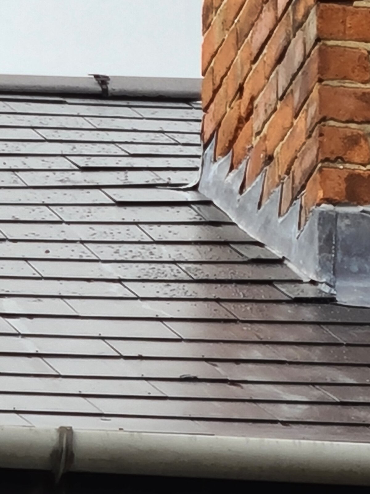

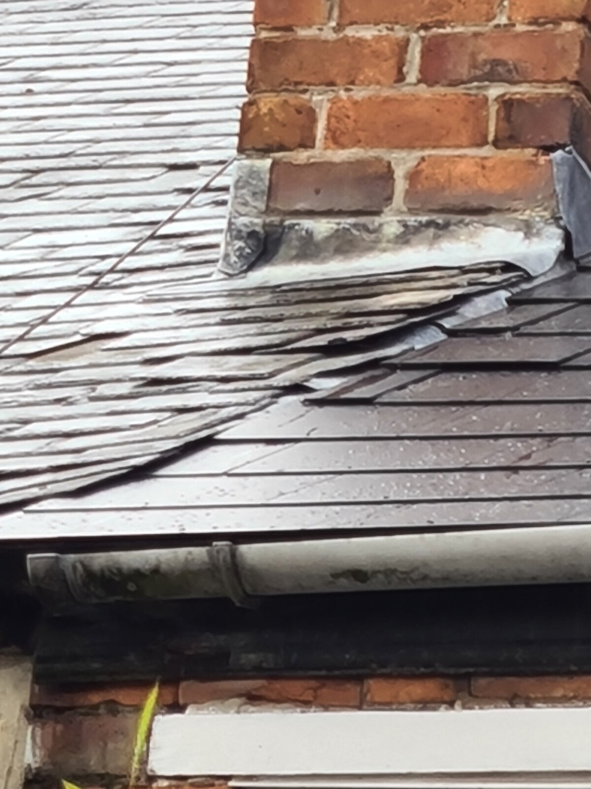

Pretty poor on several counts to be honest .

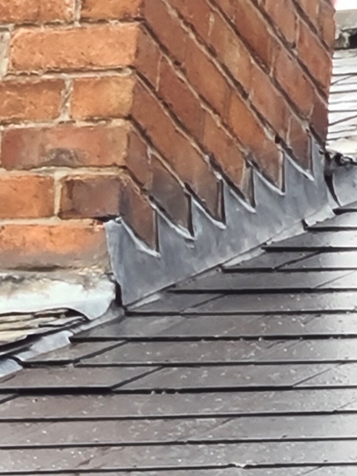

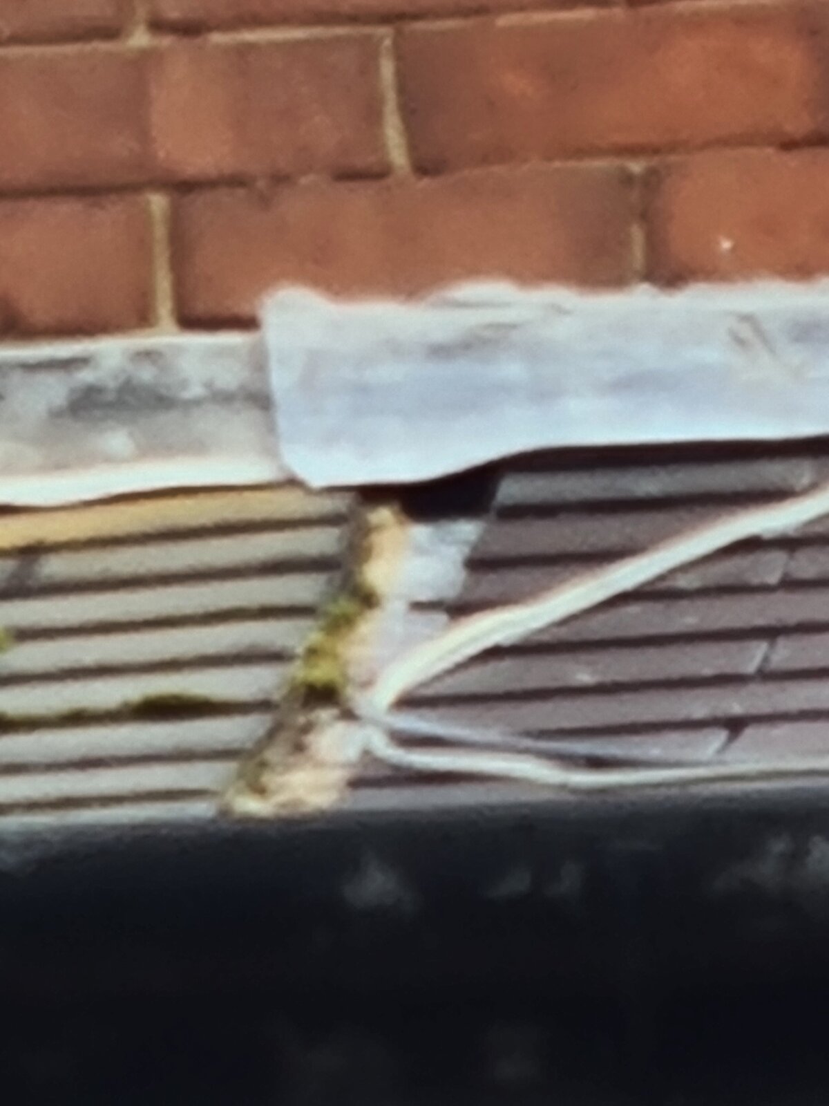

The small cuts next to the chimney don't have CDRs , they should have used doubles cut to size .
Lead wedges holding the stepped flashing in place are proud of the surface and should be tapped back to allow pointing neatly or smooth continuous lead mastic. As the step flashing does not extend around the front of the chimney there is a point exposed which could let water in
The joins to your neighbours is a total mess. Your slate would never had joined properly as they are differing sizes.
A simple bonding gutter would have dealt with this neatly . There's probably more but i only gave it a quick glance. If scaffold is up , don't let it go you are going to need it

A bonding gutter should of been used! Together with the other list of faults, clearly a very poor job.

See if their 'senior roofers' mention the cuts (as someone else mentioned, for mock slates you use doubles cut down to 1 and a half so you can get a rivet in)- if they don't it's a slam dunk for small claims and trading standards (basic competence, installing to Mfr instructions).

It's easy to see from the pics that they haven't used doubles. Galvanised nails are not as long-lasting as copper but (long as they used 30mm length) not an outrage- the design life for mock slates is either 25 or 30 years, galv should manage that. The half slates at the boundaries are a big fat no, they'll slip or fail quite early (5-10 years)
