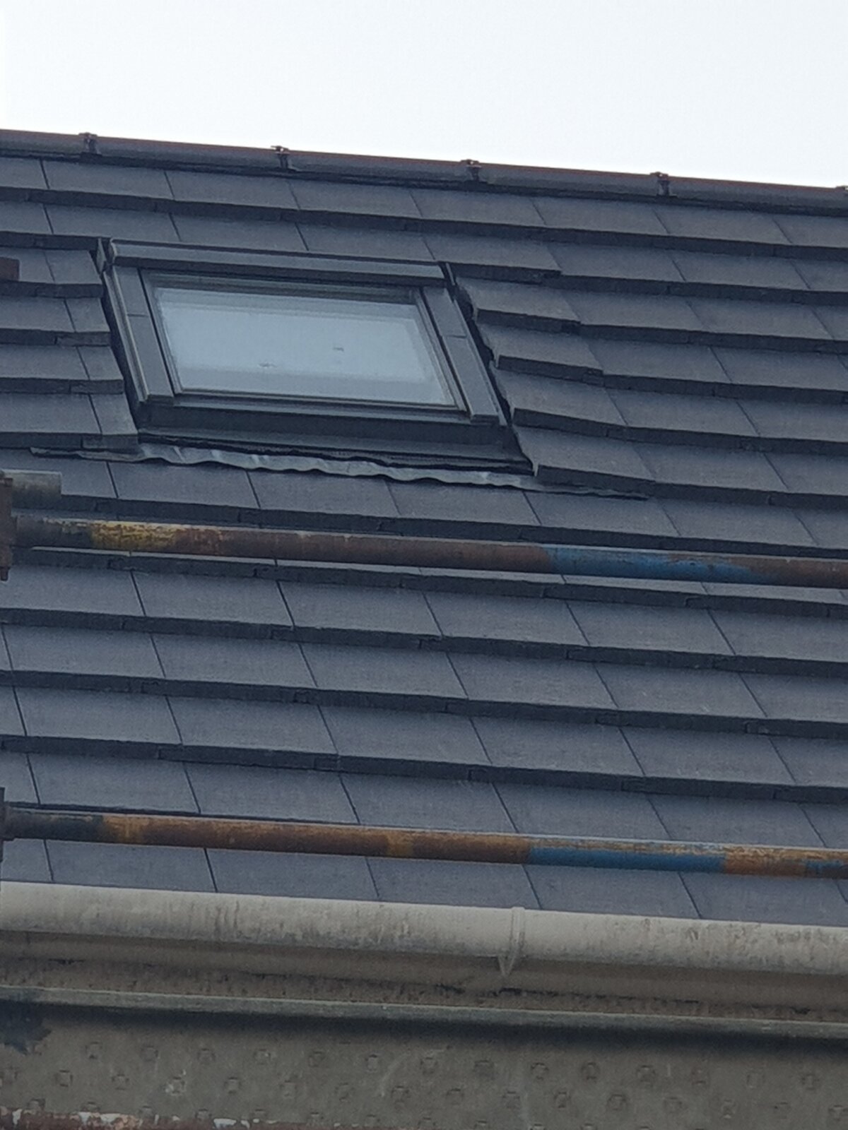

Hi all,looking for some advice,got New roof fitted today and the tiles are kicking up at the side and looks awful. When I questioned this I was told that this is unavoidable, its an old roof and so on. I'm a woman and felt they were a bit condescending, I don't know if this is right and am a bit scared to ask again. I have a new extension with a velux on same side which is fine,so the main roof one sticks out like sore thumb.Any advice appreciated, thanks Lyn

Some kick is difficult to disguise especially when you consider that the Velux area where those tiles are landing is a wee bit higher than the surrounding battens. That said, you can mitigate the severity of the kick by getting creative with the angle grinder and it has to start with the first/bottom tile, seated on the flashing, or else all the tiles above will kick.
I installed my own, long ago and I agree it is almost impossible to avoid. Under the tiles, goes the flashing, which will increase the depth of material and cause the kick up. The only effective way to mitigate it, is by raising the height of the tiles around the entire area, where there is no flashing. How obvious it is, depends upon the type of tile.

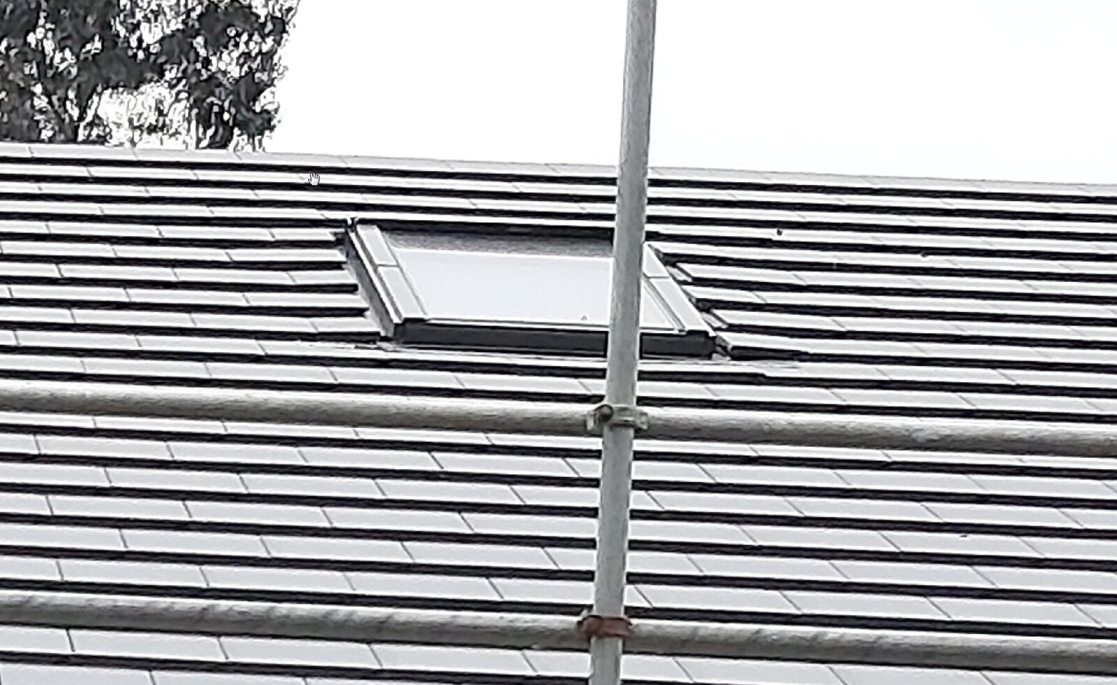

In our case the roofers did not realise (because they did not read the instructions because they are in a rush and they cannot speak English anyway) that the foam present on the flashing kit is for profiled tiles with a roll and you are meant to trim that foam until your flat tile sits nicely on it. As the tiles are large they also produce a kick up and an ugly end cut. We have since improved on the kick-up but nothing about the very, very ugly end cut.
