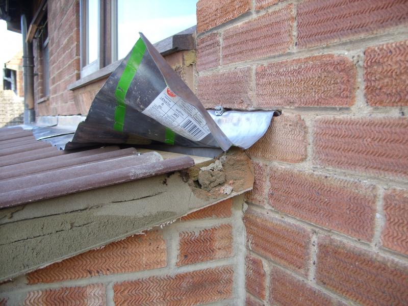

Hi, I am having an extension done at the moment by a general builder and I am a bit concerned about the roof.
His labourer has done the felting, battening and the tiling and he is currently doing the lead flashing.
A few things are worrying me,
1) There doesn't seem to be any ventilation anywhere.
2) At the bottom of the roof where it joins the fascia board the felt sags down so any water that gets on the felt will just sit there.
3) Where the roof joins the house, the tiles are about 100mm short as you can see the top batten when you look under the flashing.
4) The flashing is not finished yet but I am a little concerned that the flashing seems to be too tight over the tiles. I realise that he has to mould it to shape but it seems as though it has to stretch a lot to fit properly.

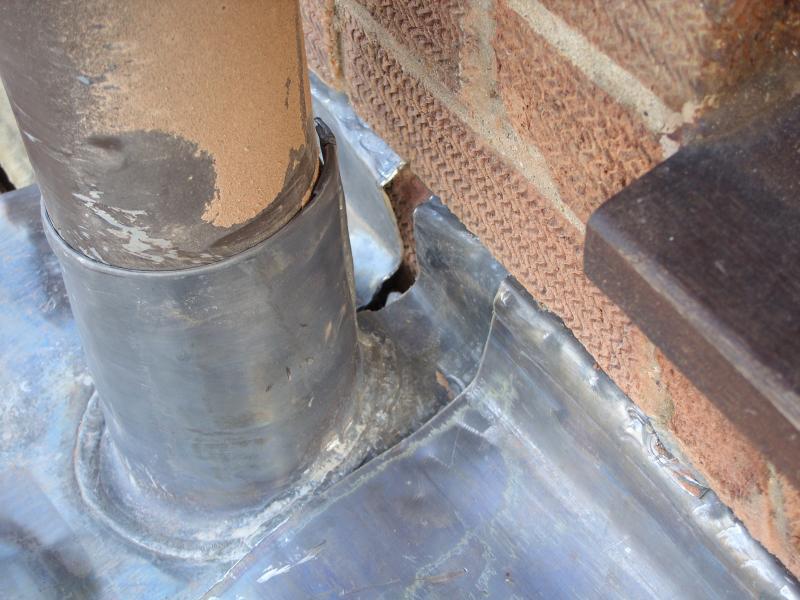

5) Also he has bought a soil pipe sleeve for the flashing but rather than fit the soil pipe through it he has cut the back of it!

they appear to have used code 3 lead (green tape) instead of the minimum code 4 (blue tape).
the lead up-stand should have been a course higher.
the split at the back of the lead slate is abysmal and will either need replacing or a soldering repair carried out, though this will be awkward due to location.
it may have breathable membrane though this is no guarantee that building control will accept this as sufficient ventilation. we usually fit over fascia vents as a precaution.
the lathes can be oriented so that the final tile nibs fit snug against the wall. there is no excuse for not being able to achieve this.
an eaves tray is fitted to alleviate the problems of sag at the fascia detail.
As above, but I 'd add that its a bit of crapp work
IIRC, Tyvek (who make breather membranes) have some sort of tech guide or test result paper to show that additional venting is not needed when [their] membrane is used. But TBH, there is no point in using breather membranes if you have to vent as well!
we use them because their strength is superior. try using bituminous sarking on a hot day!
plus it is lightweight, thin and covers 1.5m a pop.
I can fit soffit vents myself if this will help.

The builder has been on site today, and yes he said he told the labourer that he should have put a piece of wood at the top to fill in the 100mm, but they proceeded to put the lead flashing up anyway, and just leave it!

About the lead flashing. I personally think the builder knew it was a high bold roll profile tile so he used thinner lead in the chance it might dress down better to the profile of the tile.

And in reply, no, the 'lad' isn't happy with the roofing works carried out so I have spent the last couple of days putting it right.
Never done any lead work before, and if you take your time you can get some nice results.
I am well chuffed with it now.
