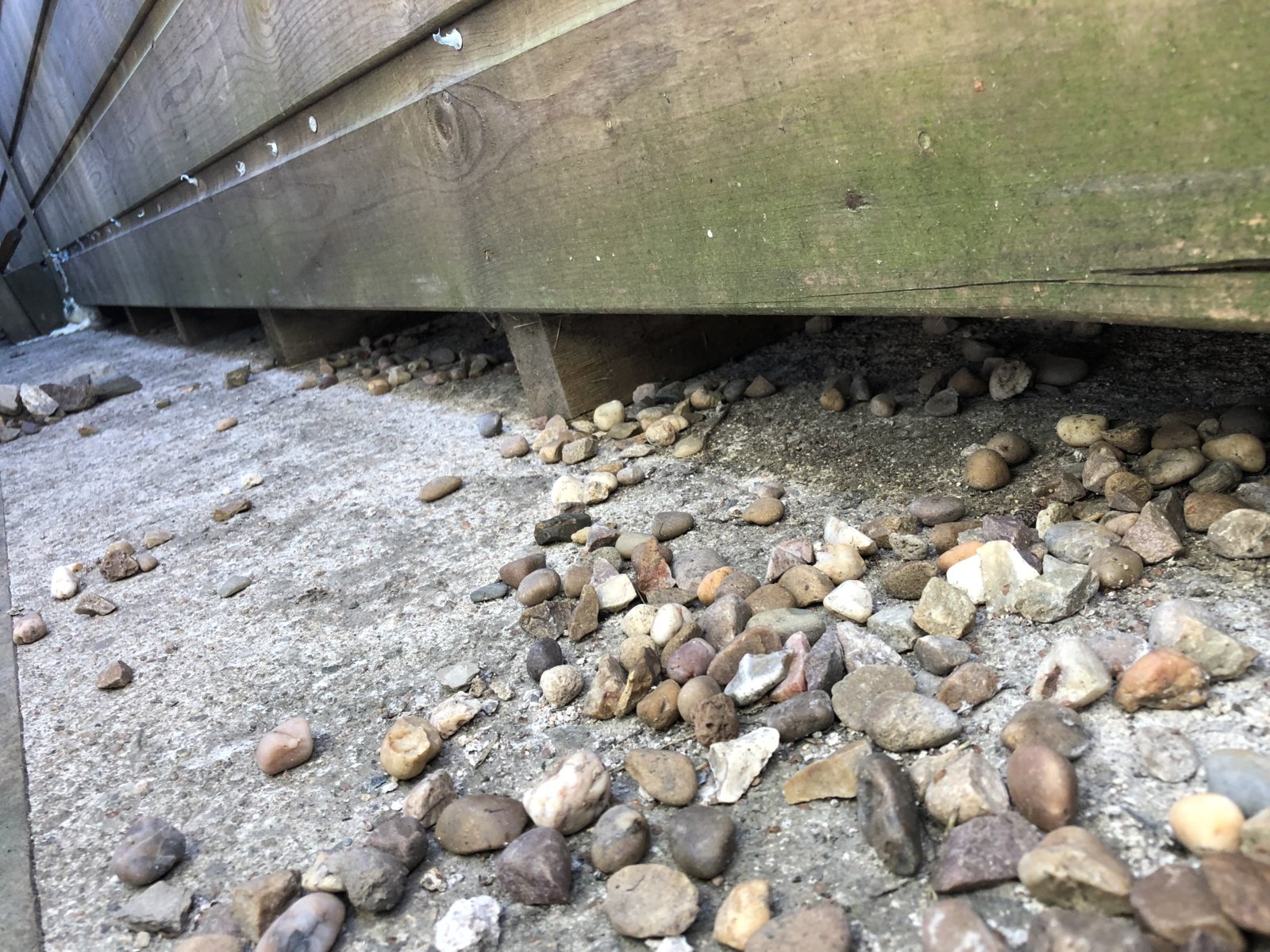

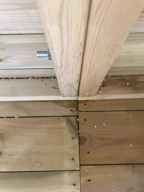

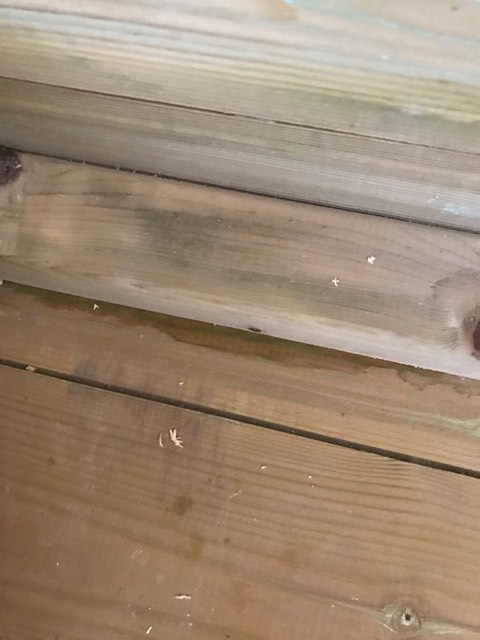

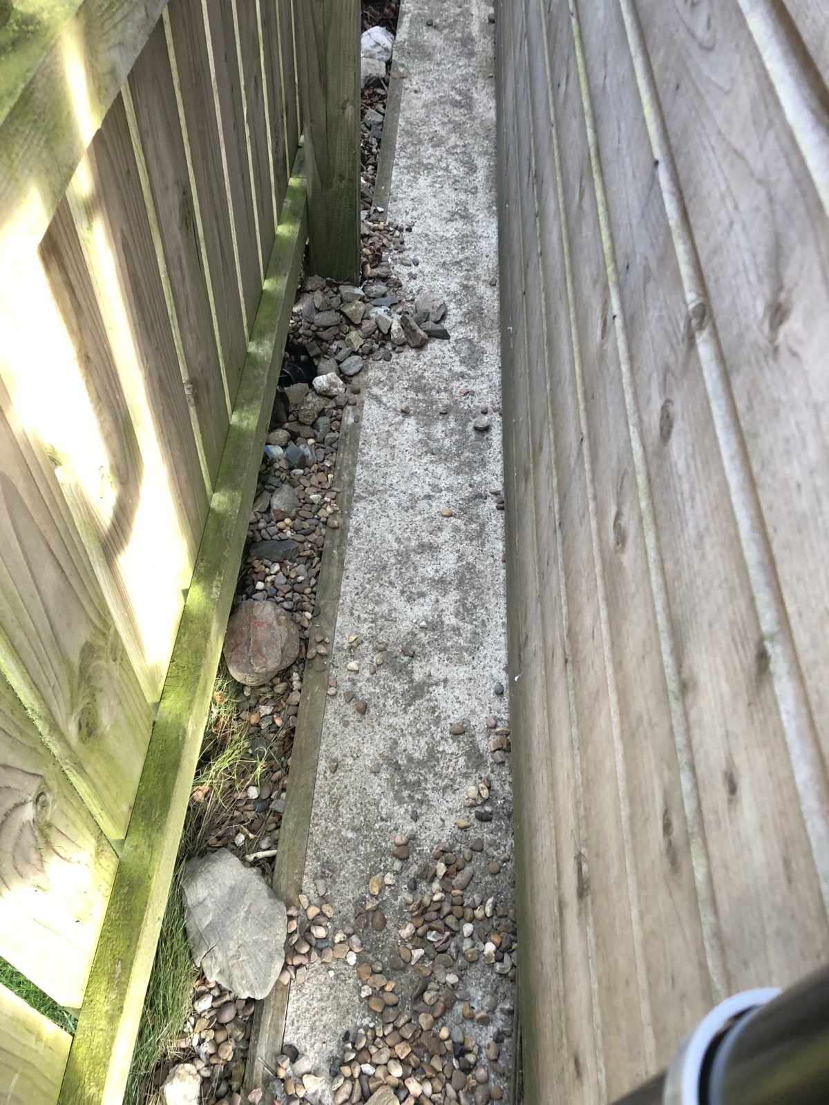

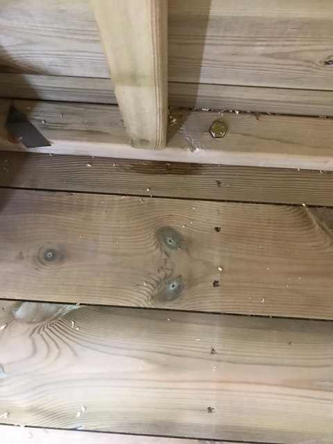

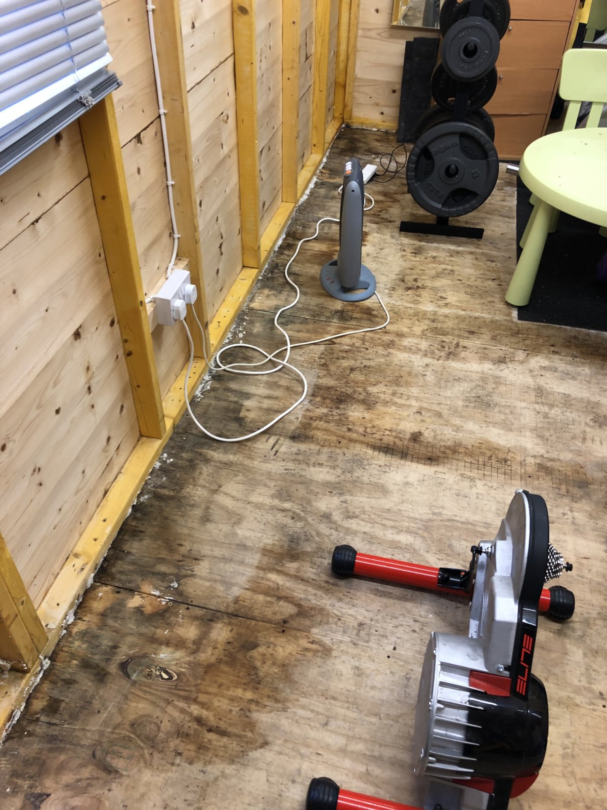

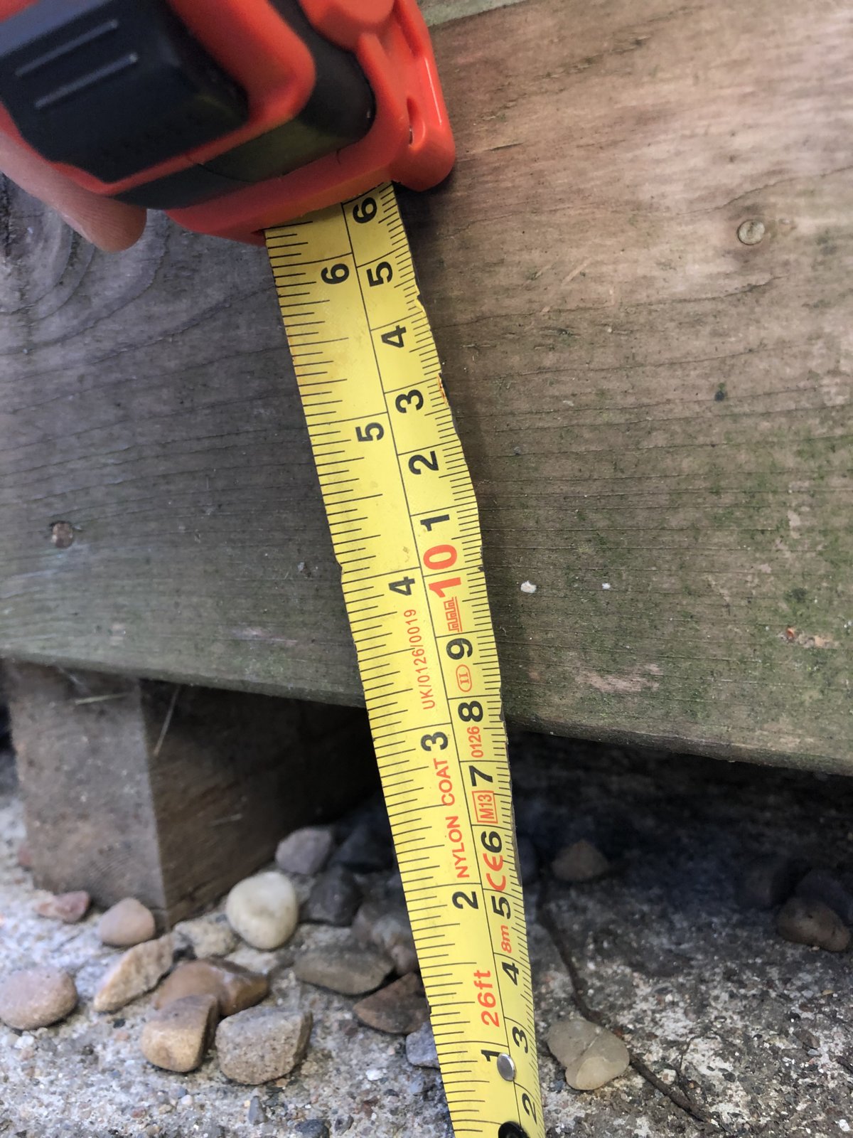

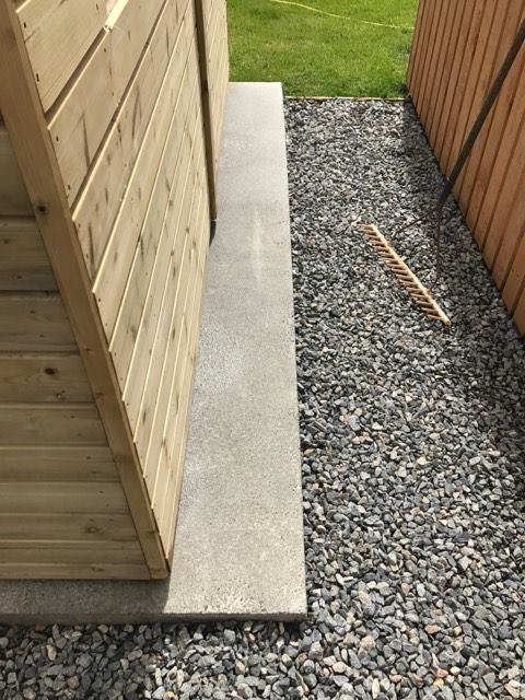

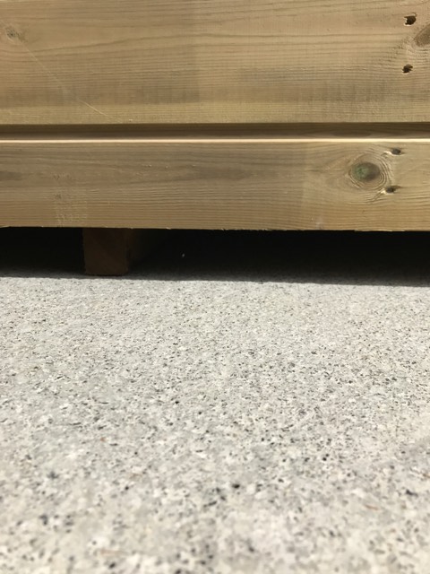

Hi! Trying to solve the same problem you had. My base is similar to your own and the side of shed is hit bad with wind and rain (NE Scotland!). I have guttering which makes no difference as the rain soaks the shed wall.
Any ideas?

If you are considering raising the shed on slabs or higher runners you will have to make them the same length as the current runners or your floor will sag in the unsupported areas.
The groove idea is a possibility but it would need to be more than a blade thickness, maybe about the width of 3 blades and at least 6-8mm deep.
Along with the groove you could try putting and extra board along the bottom to try and prevent 'splash back' but this will reduce the ventilation flowing underneath.
Do you think its splashback though? I was more of the opinion the outer walls were consistently wet and seeping down into the dry floor base?
Its a large shed (9000x3700) so jacking isn’t easy although i was keen to try.
When you think, a dpc on a house is recommended to be 6" (150mm) above ground level to prevent bridging and splash up, the same would naturally apply to a shed.
A easy way to prevent splash back is to take the gravel right up to the edge of the shed to a depth of at least 30mm, but this would obviously cover the O/P's flags and cover 3/4 of the ventilation area underneath unless he trimmed the flags back flush with the shed walls.
Yeh i see your point, thank you.
I could try layering with stones/ gravel along that side that’s affected to gauge improvement- I guess the purpose is draining and reduces splashing?
