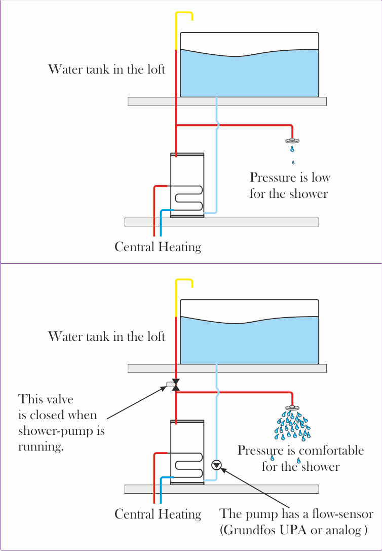

Нi
If I understand you correct.
I have suggest an option for you.
The previous poster seems to be suggesting putting a valve on the safety vent of an open vented hot water cylinder. This is in contravention of regulations. Do not do it. The poster may be from another country where regulations are different from ours.
Thank you for your comment.
I see my mistake.
I locked the safety piping!

Never ever put a valve on an open vent pipe, it's a vent pipe for a reason.
A trickle at the shower head has nothing to do with the vent pipe anyway, it's to do with the how high the cold water is above the head of the shower. Less than 1m above and there will not be enough head of pressure to activate the flow switches
If the pressure before the pump is less than 0.2Bar=2m, then the pump can be switched on manually?
It can be yes, you can rig a pull switch to jump the pump into starting once the shower is turned on and once it flows it should keep going.
