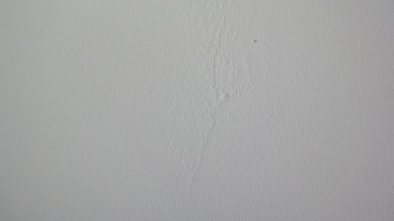

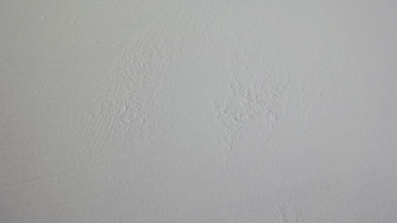

I have just had my front bedroom top skimmed after stripping the old wallpaper off.
Whilst doing the base coat I noticed a number of glitches. My wife thinks that I am being too fusy and that the job is OK.
I have added the images. They where taken at close range so each image shows an area of around 12 square cm. There are about 3-4 glitches per wall.

It does look a bit shyt to be honest, did you get all the crap of the wall and was your first coat about 2mm.
Confused here. :confused: Who did the job,, was it you,, or did you get a "skimmer" in?? and no,, you're not being fussy. A poor finish is always gonna be a poor job.

I have just finished the mistcoat and have noticed the imperfections pictured.
I have never had a room skimmed before so I am unaware of how it should look. I thought a skim would be virtually perfect whilst my wife reckons that the finish is OK and I should accept some glitches.
A coat of paint really does show up any blemishes in the plaster finish. If you're not happy with the job, (and i agree with the opinion PBof Derry), get the plasterer back, point out the flaws, and get him to touch up the blemishes with easifill or similar, then sand it down. Better to notice/repair it now. If you pay good money, you expect to get a decent job done.
Your not being too fussy at all, thats crap & he needs to sort it out.

what are you using as a filler, would be a good idea to sand down the rough areas first will help you with a key for your filler, specially since you have already applied a mist coat.
