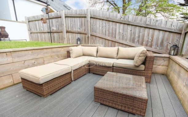

Hi all,
First post so be gentle :)
Looking to "edge" off this wall with new sleepers and then the artificial grass above to the edge of the sleeper.
  • So, question is, whats the best way to retain the sleepers up against the small wall so they are solid, the higher level steps down to a lower level of "grass" so it needs to be solid for foot traffic.
  • The higher level is solid, edged currently with that unsightly brick wall.
  • The sleepers will be 100mm deep by 200mm wide, so will be laid thin way up - overlapped and timberlocked together
  • There will be 2 sleepers high, 200mm each so 400mm total height, the wall is 300mm so i can dig in..
  • I can set them into the ground as its soil/subbase including some damproofing.
  • Setting into the ground wise, i was thinking sleeper stakes and pea gravel to help with drainage.
Hows the best way to make sure they dont move away from the wall :)
Hope that makes sense, thanks in advance

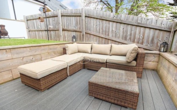

Pic of wall below & a pic of what i want it to look like (well similar anyway)
Have you thought about battening the wall and using 8x1 to clad it for the same effect, if you're doing this purely for aesthetics. You could then cap the top of the wall with a 5x2 (or bigger depending on what overhang you want) but would save you going to the expense of the 8x4 thick sleepers which won't be doing any retaining as the wall is doing that.
Here is an example of using the 8x1 and a 5x2 to cap the top.
