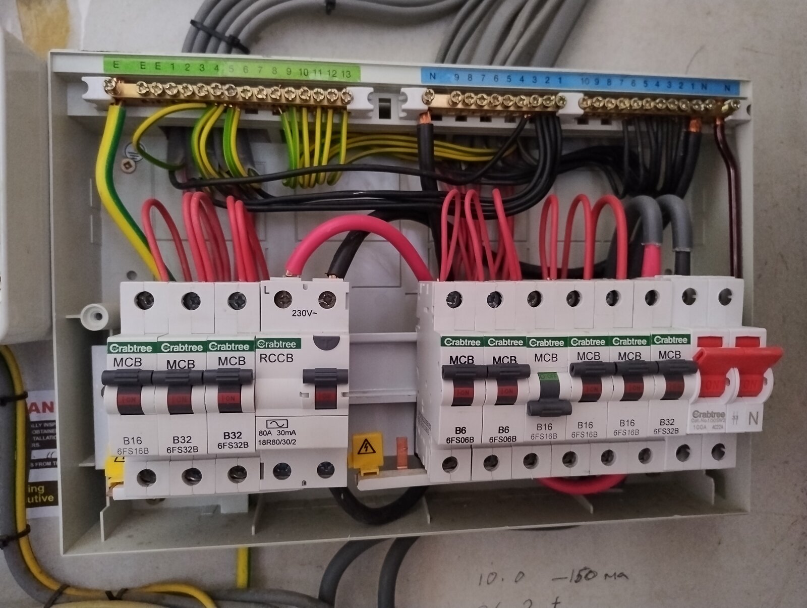

I want to put a new socket, for a freezer, in my hallway, right beside where my fuse cupboard / consumer unit is.
The consumer unit already has a dedicated 16 amp radial circuit for the designated fridge socket in the kitchen.
A YouTube video led me to believe that you can have 2 radial circuits coming out of one MCB.
So the question then is, can I just run some more 2.5mm T&E from the existing 16A fridge MCB to a new socket for a freezer...?
(I've put in a bunch of downlights, so I'm not a complete electrics "noob".)

Any reason then not to just put a new MCB on the far left and have it protected by the existing RCCB...?
I definitely want to comply with the regs, maybe I should have made that clear from the start.
Only that it then becomes an additional circuit and therefore before becomes notifiable to Building Control (at least in England and wales it does - Where abouts in the British isles are you - Is your handle simply indicative of where you are from, or of where you are now??)

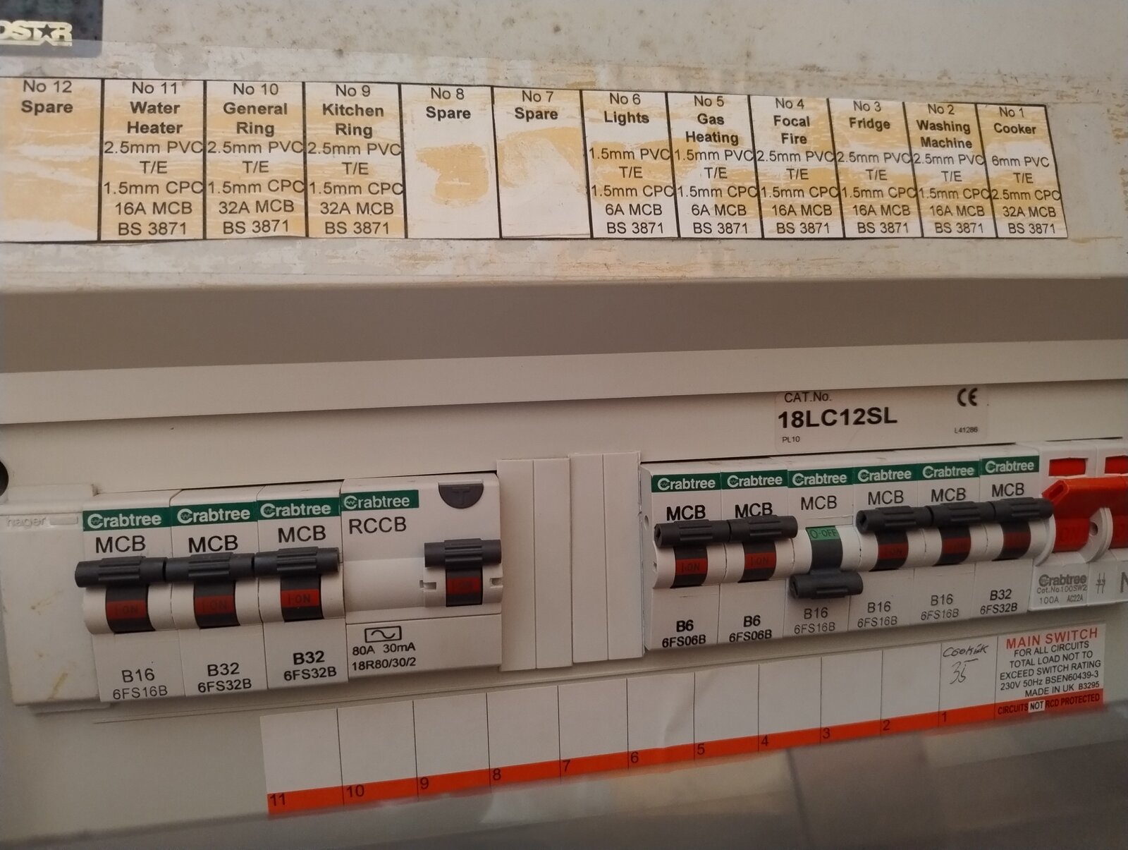

I'm in greater Belfast and I've been renting this place from the Northern Ireland Housing Executive for about 20 years.
About 6 months ago I had my "5 yearly electrical inspection" (which definitely doesn't even happen every 5 years...). I fully expected the guy to inspect my work on the lights, but he made it very clear that he was only there to measure the current coming into the flat, and replace any sockets etc. that might be damaged.
So I'm sure I could get away with things here, but I want to be safe and compliant for my own peace of mind.
Presumably it would just be a case of swapping the MCB for the lights with an RCBO then...?
I would create a brand new circuit, and feed it with a B 20amp RCBO from one of the spare ways.
Why not? You mentioned using 2.5mm² T&E which can carry 27A (with no derating) so may as well use 20A (or 25A) MCB.
