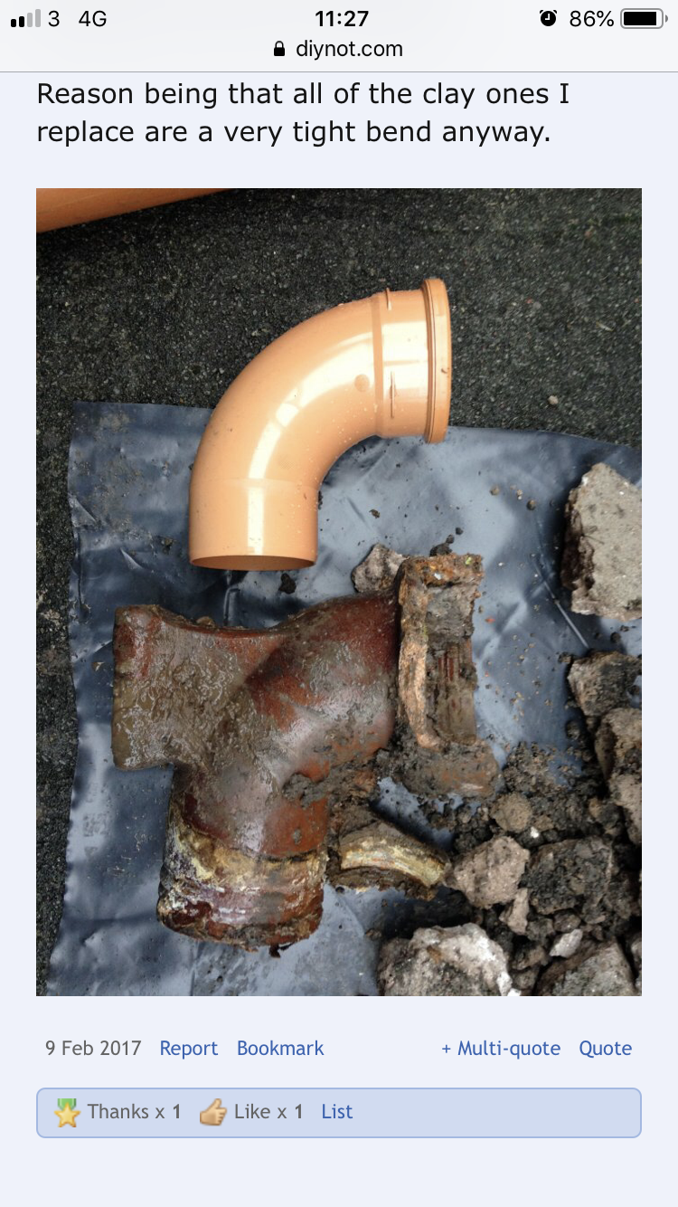

Old clay rest bends are much tighter than the modern plastic ones. Not sure in regs but I would happily use a normal 90degree bend.
If you use a single socket one you could have a black socket on the plain end to come out of the ground.
Bed it on pea gravel and cover with whatever you want.
For example:
Could just build up the surface a bit, if it's a lawn it would be more acceptable than a drive.
