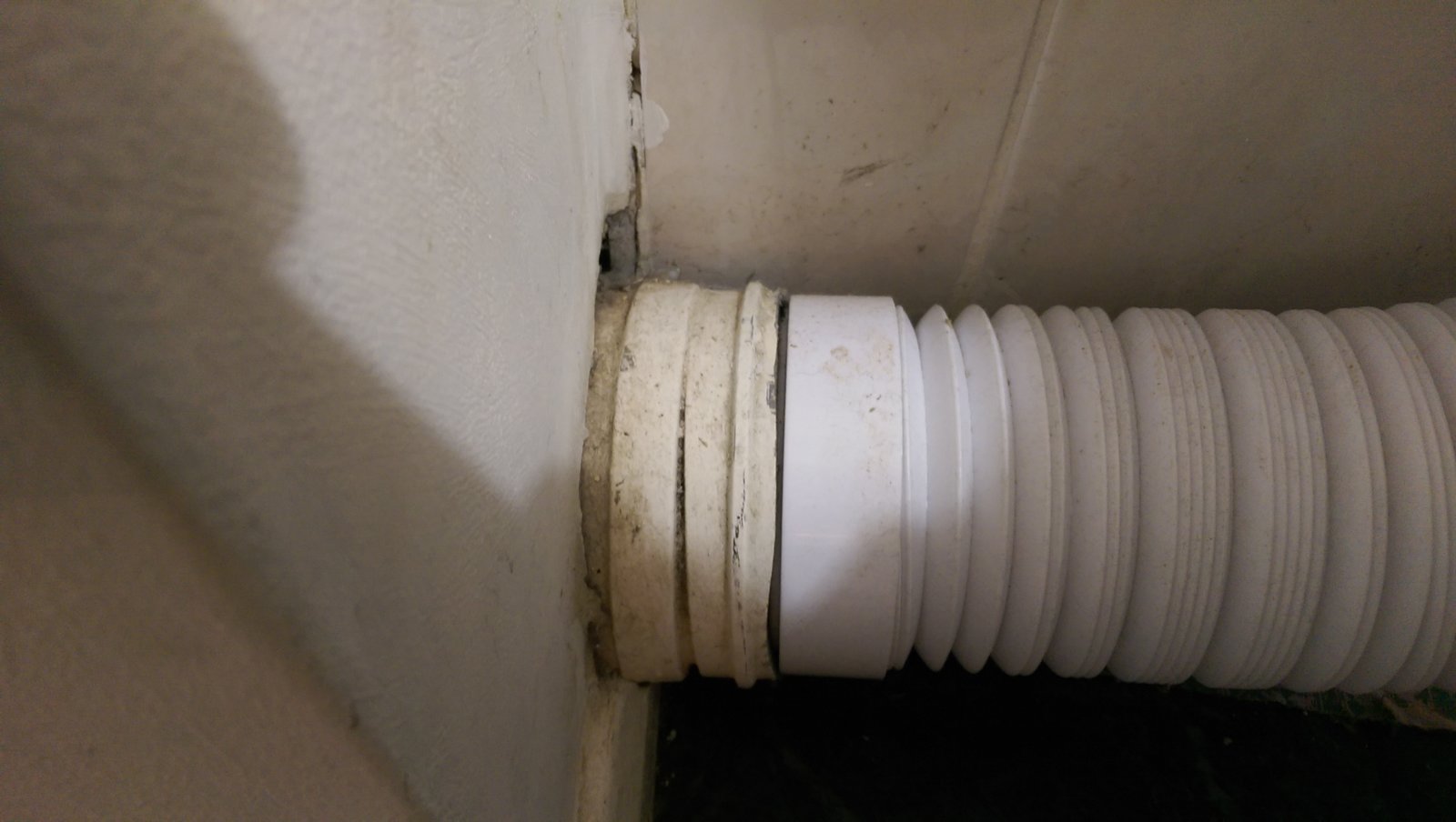

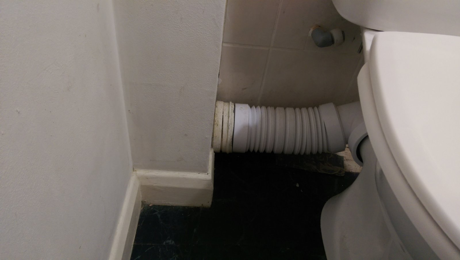

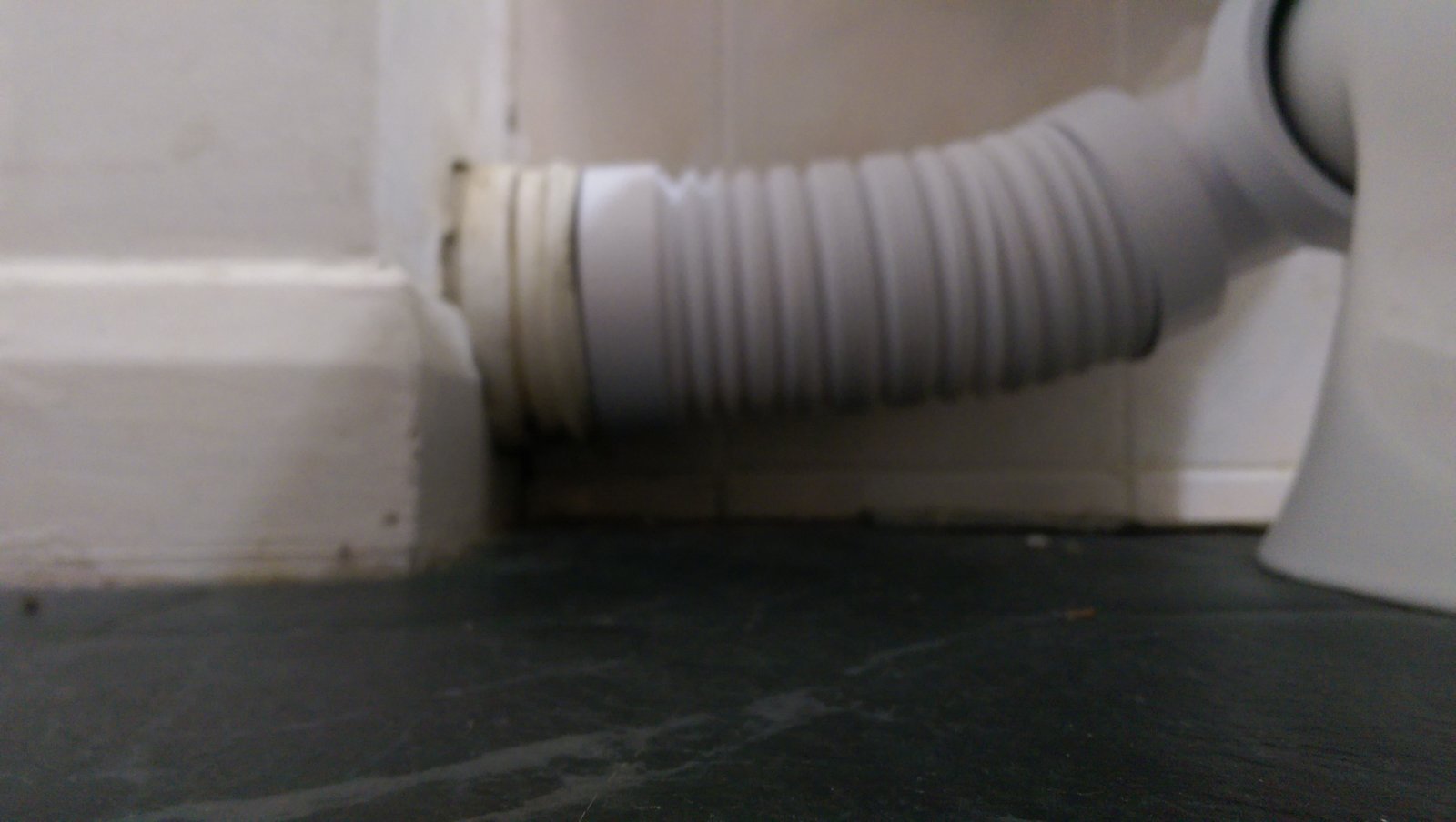

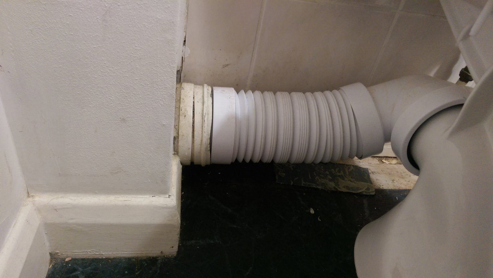

Lol - I've also been spending a lot of time thinking about soil pipes when perhaps I should be doing something more "enjoyable" on a Friday evening. Anyway, I think I'm nearly there thanks to your help but one last obstacle is the existing branch into the stack was originally a solvent weld fitting (as per the pic in the link below). Following advice there I cut the connector and used a pan connector which had a rubber finned end that slotted into the stack. It worked well and looks and behaves a lot better than what was originally there.
However, that means I've now got a partially sawn off connector that I need to add my branch pipe to. I'm thinking it would just be a case of solvent welding a new pit of pipe but not sure. Perhaps I should take a picture of it how it currently looks? I'll try and get that shortly...

yeah solvent weld will connect to any 110mm pipe although you need a massive brush to get it all on in time before it evaporates
push fit is also fine but you have to mess arround chamfering a bit more, and it needs more depth of plain pipe, but at least it's adjustable later if you need.
Yes good tip re brush size. I guess I'm worried about whether this socket will still accept a new 110mm pipe after some of it has been sawn off. I've attached some pics. Note I do intend to move the WC a little to the right to give me more space to take the new branch coming in through the wall.
