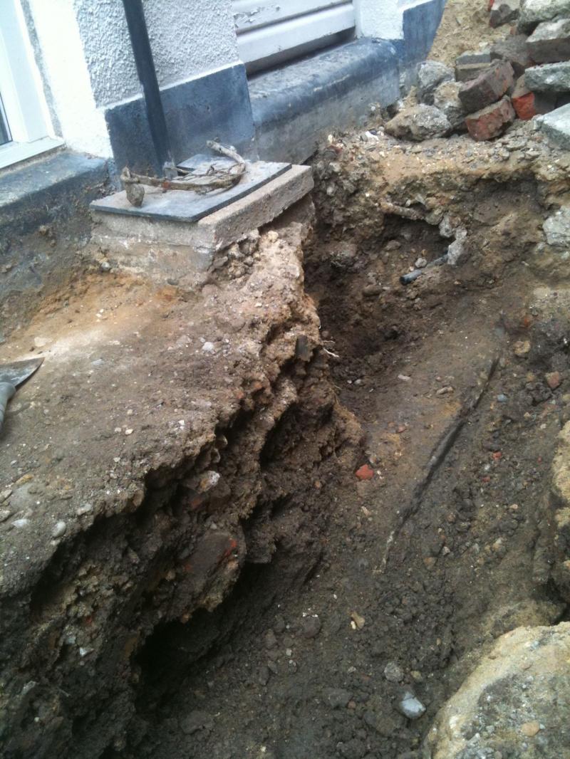

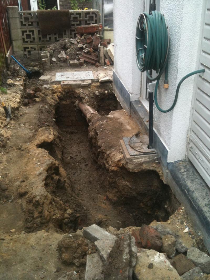

Here are a couple of photos from the digging this weekend.
Currently dug down about 70 cm from top of manhole.
You can see the old wall foundations in this picture.
The existing drain is coming out as it is not used and was for the washing machine and a sink. Solid pipe will come down the wall where the hose reel is, either inside or outside. and go towards the manhole.
I need to go down about a meter to join up with the bottom of the manhole or I can have some kind of backdrop, inside or outside the manhole. That way I imaging I could put the soil pipe inside. Come out of the wall about 50 below floor level, 40 cm below ground level, put in a shallow inspection chamber for the 90 degree turn toward the manhole, then a backdrop at the manhole.
I'll try and explain this to BC but big question is internal or external backdrop? Any suggestions, there are some comments on the web that internal ones are frowned upon?
Note: old downstairs wc was where the hole is by the manhole at the corner of the building. The old soil pipe comes out the wall higher up and then drops with no inspection chamber then goes to the base of the manhole. I could reuse its entry into the manhole.
If there is an existing redundant connection into that chamber then i'd use that, will save an awful amount of effort breaking in to fit a new connection. Providing the pipe is in good condition, carefully cut it back at a suitable point and use an appropriate coupling to join to it. Slow radius bend should point you in the right direction, then run drain to new chamber position.
You may get away with using a couple of slow bends to lift the drain slightly in a 'dog leg' fashion to suit an invert of 600mm for the shallow chamber, a 400mm invert may leave the pipework vulnerable.

Agree unsing the redundant connection. It looks good enough to me and was in before I took the old wc out. It runs into the chamber at 45.degrees so will require a bend but I can't see this being a big problem. Unfortunately the invert is about 100cm. I can't see how I can drop from even 60 to 100 even with a couple of slow bends in just 250cm from the base of the stack to the chamber. (unless there is something I dont know about required gradient?) hence why I thought I needed a backdrop.

Recommended fall is 1:40 on 4" drain, but you can sometimes 'cheat'. If you fit a slow bend to point the drain 'upwards' then another to get it back on the horizontal immediately before the new chamber, BCO might just allow you to get away with it, rather than making a new connection into the chamber. Main issue is achieving a 'self cleansing velocity' in the drain, you dont want the s**t flying into the chamber and splashing everywhere fouling the benching opposite.

BC has been round and said I should come away from the house, put a small shallow inspection chamber over the bend towards the drain and then put in an external backdrop next to the manhole. Sounds pretty reasonable and means I still have the option of internal or external soil pipe.
