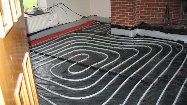

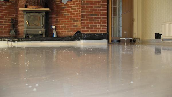

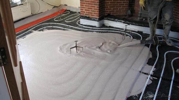

That is how i did mine, see photos
75mm sand/cement screed + UFH (wet)
as you can see by the photos i went for a liquid screed as i believe it offers the best thermal transfer due to 100% coverage of the pipes. It was all poured in around 15 minutes, it took them longer to clean out the pump ! The only thing with going with a liquid screed is you need to make the floor like a tank so lots of duct tape from around the edges.
? separation polysheet
yes you do need this to stop the screed attacking the foil on the insulation if you do get a leak.
