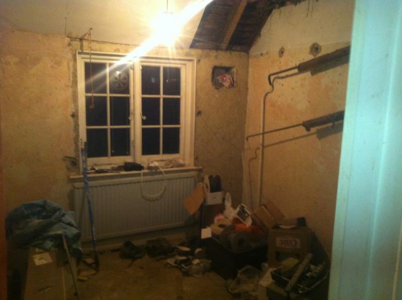

Oh sorry, I can take pics and dimensions tonight, but it is brick walls, connected to two walls, the first3/4 stairs connecting to wall on the left then turning right the remaining stairs connecting to the left wall again.
hope that makes sense! ha

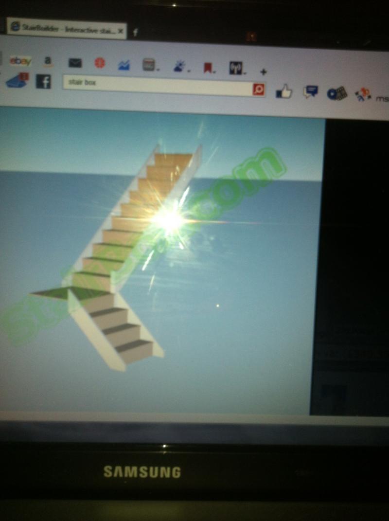

Stairbox have a good stair builder on their website (it's what I used to get an idea of what I wanted/sizes/etc), I had mine delivered from TK Stairs last night though. They were slightly cheaper and I had great service and delivery to be fair.

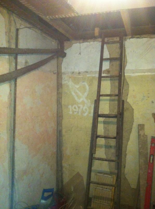

The dimensions of the room are
10 ft long
8ft wide.
8ft ceiling height.. I guess around 9 or more once loft floor is in.
See the pics attached - the stairs will start roughly where the window is.
There will be a doorway to the left of the window.
they go up 3/4 stairs then turn right and go up.
would appreciate anyones thoughts.
thank you very much.
As long as the stairs you've designed fit in the space you have then that's all you need on that website as they make them to fit within building regs. Don't forget to include the depth of new floor joists plus floorboards/ply/chipboard/etc in your floor to floor height, you'll have trouble getting them to fit otherwise.
