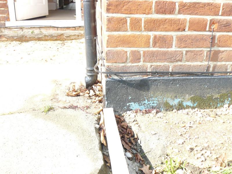

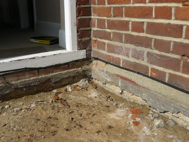

hope these pics help ,the walls are solid,I will probably just replace [repair] plinth ,repoint,use that thompsons stuff,and if i need to i will put a canopy over door .
Should i do the plinth in one hit or does it need a scratch coat ?
i'm not getting what is going on below d.p.c. :confused: if there is a dpc that is. :eek:
i'm suspicious as to why there is mortar render below floor level in the first place. the lack of decent brickwork is mildly alarming.
what is that existing render covering?
is there a foundation?
is there a dpc?
it was not the plinth i was expecting.
If you click on the pic to enlarge, there is a dpc visible on the right hand side, just above the hoggin, two courses down from underside of door frame; clearer in the close up piccy. Looks like it had a step affair outside the door, with a bitumastic felt dressed up 150 above it.
Doesn't explain why the dpc is where it is, relative to the door threshold, though...

the existing render is covering 2 course of brick.The bottom of the render sits on the dpc
there is a foundation but its not very deep
the dpc is slate at ground level
the plinth isnt shown very well in the pictures,I took another picture showing the plinth intact but picture wouldnt download?,dont know why ,im not very good at this technical stuff,i'll try again tomorrow
